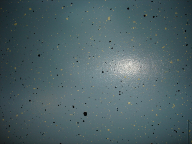

Postby aggie79 » Tue Dec 01, 2009 9:44 am
doug hodder wrote:Thanks all....Mark...yup, it's going to be painted. Speckled walls like the original Scotties, solid cabinets. I've done my share of natural finished wood builds, so this one gets a different treatment. Doug
Doug,
As always with your builds, they just keep getting better the further along you go.
What method/process are you using to do the speckled paint?
Thanks, Tom
Postby doug hodder » Tue Dec 01, 2009 10:28 am
What was done on Steve E's Scotty was to roll the walls with the base color...then dip a stiff bristled nylon whisk broom into about 1/2" of paint and then put it lengthwise between your fingers and slowly pull back and allow it to flip onto the wall. If you do it slowly and stand back about 3 feet, you can have an amazing amount of control on it and can put it on evenly. It will probably have a speckled paint finish of base color and 3 colors on top.
I've sprayed zolatone before and it isn't the look I want, besides, I don't have a hopper type gun to spray it. This is sorta what it will look like. Doug

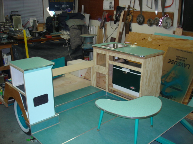

Postby doug hodder » Sun Dec 06, 2009 9:52 pm
I got the laminate down....can't tell, but it's the aqua boomerang, tops trimmed with aluminum, got the left side into paint. The galley took a ton of time. It's just 1/4" ply backed with 3/4 sq. material for stiffeners and framing. The cooler tray holds this larger cooler, but had to be lifted a bit to clear the wheel tub. I made it this way in case the vintage cooler I have develops any problems and have to use the larger one. My approach was to put in the big things, sink and cooler, then frame it in to maximize the storage space for the rest of the stuff. I can fit a Coleman lantern 200/242 in the lower left cabinet of the galley. I left enough room above the drawer to fit a cook top in the future.
I also had some scrap ply and extra laminate, so made up a cocktail table for outside use. I scrounged the legs at a gathering when Dave A was burning up a piece of old furniture that became firewood and spotted the nice tapered legs with the swivel feet, just a paint job and some T nuts....perfect for the early 60's look.
I'm cooking up my treatment for the door fronts....gotta be something different, not just a plain painted door. Doug
Postby tonyj » Sun Dec 06, 2009 10:21 pm
You must laugh every time you look at that table. It is so great!
tony

Postby halfdome, Danny » Sun Dec 06, 2009 10:22 pm
Nice looking Doug. :thumbsup:
That kidney shaped table reminds me of my 7Th grade wood shop project back in the early 60's.
Same shape, same legs, just in Mahogany.
Yours is the first I've seen since then. :D Danny

Postby doug hodder » Mon Dec 07, 2009 1:00 am
halfdome, Danny wrote:Nice looking Doug. :thumbsup:
Wow Danny...you got to do a table?....I only got to do a cutting board in 7th grade, but as a kid riding with mom to pick up my sister at Jr. high, I saw that a number, IE most of the wood shop guys, were doing bowling pin lamps! For me in high school...it was gun racks, but that was in Alaska. Now that I think of it....a bowling pin lamp might just be the perfect thing! Now to find the correct kidney shaped coral colored melmac ash tray. After all....what self respecting early 60's thing wouldn't be complete without that! :thinking: I have a lot of fun trying to recreate all sorts of lost crap from the past. Doug
