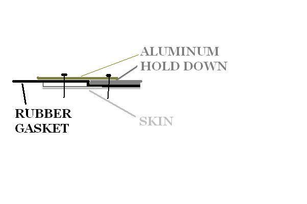

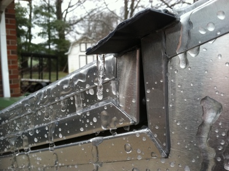

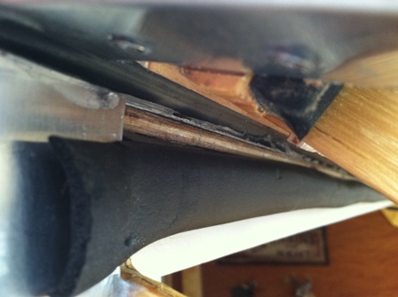

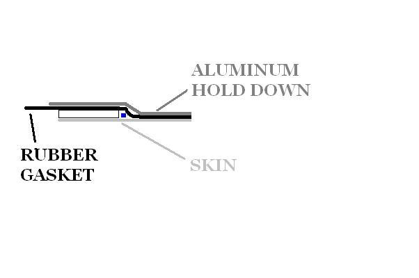

Are you sure you havent created a small alley where the rubber hinge steps off of the edge molding ? ( see the blue dot )
If you cut the hold down just short of the edge trim then add the second (tan) piece it should then close the alleyway and you can still use the same holes.

Well, my clear coat didn't turn out so good :shock:

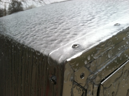

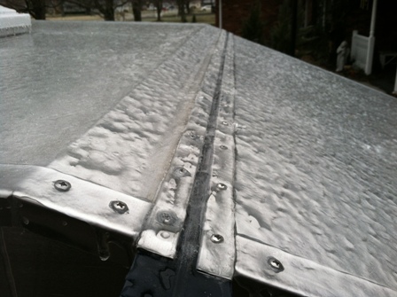

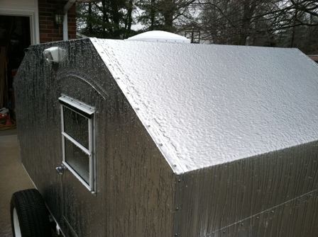

Seriously, ???, I shoved my little camper out in the elements a couple of weeks ago as mentioned in previous post and subjected it to rain, wind, snow, and now ice / freezing rain.
Don't have to worry about the galley hinge leakin' now, no-sir-ee, ain't nothin' gettin' thru that...

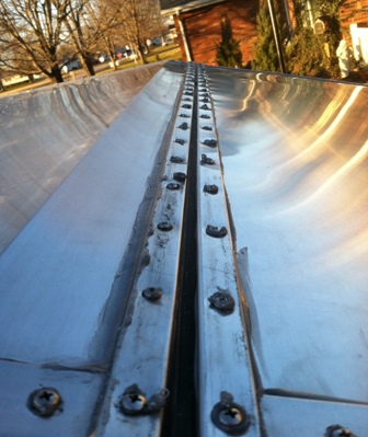

I think I did find the source of my small "water intrusion". I temporarily ukempuggied my screw heads with the sealer I'm using, ...... and .... all appears to be dry. See the shiney spot, yep, I thought it was wet too. Turned out to just be silicone.
I now have a better picture of how my water is draining away from the camper. This image is "frozen in time". You'll notice under the hinge looks dry. :applause:

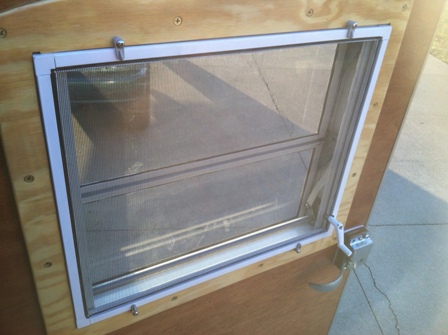

For starters, I finished cuttin' down and "custom fitting" my frames for the window screens. Put the little thumb thingy latches on there so they could be removed? if need be. (sorry for the glare on the picture, haven't seen the sunshine in a while, forgot how to deal with it :lol: )

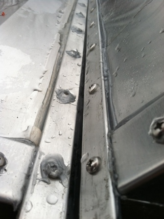

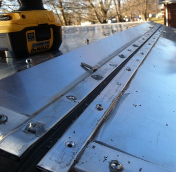

Since it was a Sunshiny weekend, I decided to go ahead and, hopefully, fix / seal the galley hinge screws right, correctly,... whatever :roll:
I did them the same way I did the trim screws, removed the screw, tapered / champhered the hole, filled the hole with gobble-d-goop (there Bob, is that better! :R ) then reinstall the screws. Run an extra bead of sealer on the front edge of the hinge just for kicks.
I'll deal with the "extra" after it dries

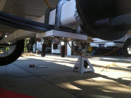

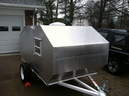

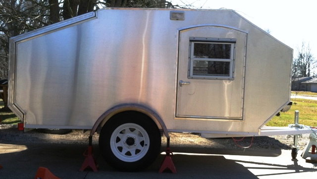

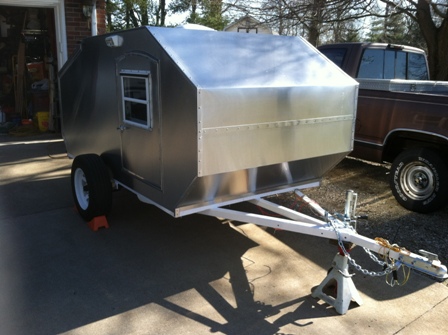

Got really ambitious and moved the axle from underneath to on top of the springs. Since I had a mile and a half (sorry, slight exaggeration :oops: ) of threads on my u-bolts, decided to cut them off a little so I didn't "collect" things on 'em. (grass, plastic shopping bags, road kill remnants, etc)
Can't really tell a lot of difference in the pictures, but with the frame leveled to the driveway, it lowered the tallest part (front roof) down to right at chin height (for me anyway). Which puts it at the same roof height as the TV. Pics below are before & after
Wow!! It even changed the looks of the vehicle parked next to it!! Now that's a dramatic change!!! :shock:

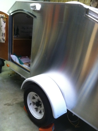

so much for just droppin' my fenders off and gettin' 'em blasted. Local shop wanted $20 each to blast 'em. :shock: Hmmmmm, let see, $20 to blast or $25 for brand new fenders, ... Uuuhhh,..... I DON"T THINK SO!!! :crazy:
I brought 'em back home, put a new 60 grit disc on my grinder and went at it. It's really not as rough as it looks, I'll take the D/A to it with some 120 or 220 grit. After a coat of primer and a couple coats of Rustoleum, it'll be just fine. :D Paint ought ta stick good.
Neighbor brought his blaster over and we were going to do it ourselves, but it rained all weekend and I sure ain't blastin' inside the garage.
Between the rain, wedding, fillin' out taxes, yadda, yadda, yadda, I only got one sanded down (only took about 15-20 minutes).
Anysomeway, here's a before and after, gotta love that purple? paint that was on 'em.

Thanks for the input on the fenders. I think with the lower 2 bolts through the angle iron frame, it shouldn't stress the 2 or 3 bolts through the side wall too much.

Both fenders are now sanded and ready for the mounting holes to be drilled, then painted. Will 4 bolts in each fender be enough to keep them from bouncing / breaking / cracking / shaking / falling off. The bottom 2 bolts (front & back) will be through the trailer frame, the top 2 will just be through my wall sandwich (.040 al, 1/4 ply, 1/2" foam, luan). Not enough forthought / planning to install wood framing where they would be. Heavens, I had no clue where the fenders were going to mount. Fenders? I didn't even have fenders at that point. :?

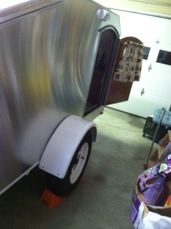

I finally got the fenders painted and mounted, brushed on rustoleum didn't turn out too shabby. Thought about mounting some of those bullet style lights in the holes left from where they were mounted in their previous life.

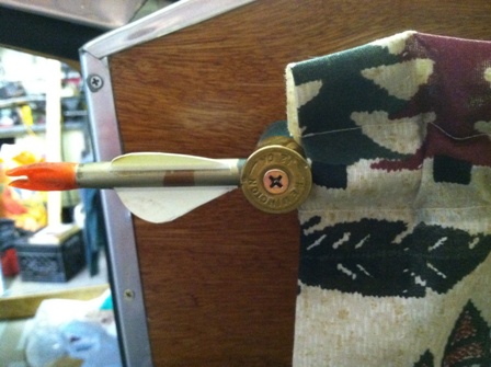

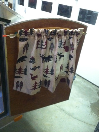

My wife had picked up some "outdoorsy" material at GW here while back so her & her mom got busy and made curtains for our lit'l camper. It was my job to figure out how to hang 'em. I got to scroungin' around in my "stuff" and come up with the idea you see pictured below. Works for me, and we shouldn't have to worry about seeing too many like it.

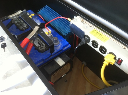

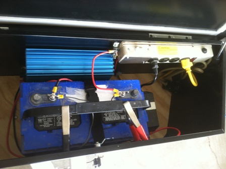

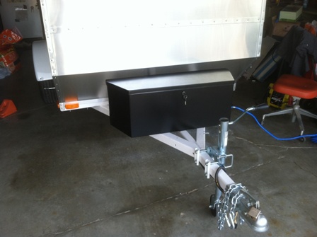

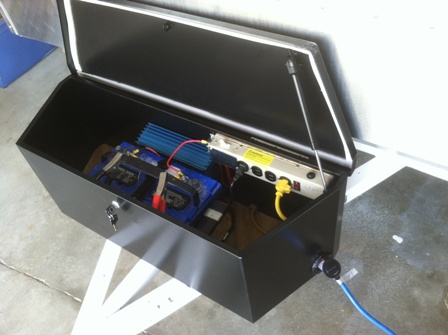

I didn't want to spend the money $>, but I went ahead and bought a HF tongue box. The kid behind the counter gave me a 20% coupon, so that made it a little less painful. Had to mount in a littler farther forward than I like, but that's what I had to do to get the lid to fully open.
I put the main electrical components into the box. Shore power comes in on the left side (used a "through the wall" plug holder from Bass Pro, it's originally designed for on-board battery chargers http://www.basspro.com/ProMariner-Pro-Tournament-AC-Plug-Holder/product/39736/127867). While I was at BP I picked up one of those plastic battery trays with the hold down strap (something like this one http://www.basspro.com/Bass-Pro-Shops-Battery-Trays/product/8840/90306) Mounted an AC/DC (NO not the rock band!) inverter / converter (donated by my good neighbor) to the back of the box. 1.5 amp Shumacher battery maintainer so that it charges whenever shore power is hooked up (also have a solar charger if needed). The cord for the plug strip is what is secured into the plug holder through the side. The yellow cord you see goes to another 15 amp plug strip mounted in the rear of the camper that the MW will be plugged into (and hopefully a coffee pot :coffee: ) My thoughts are; if shore power isn't available AND we need to use the MW or CP, then I can simply unplug the yellow cord from the plug strip and plug it into the inv / conv and turn it on. Currently, my inv/conv isn't large enough for the MW, but I have a lead on a more powerfull one. :twisted: I still need to cut in some vents in the back so that it can all "breathe". This leaves room for my extention cord on the left side and my stabilizer jacks on the right. Everything nestled snuggly in it's own little spot. Anyway, here's what the set up looks like along with a couple of close ups:
It's kind of hard to see, but on the left (facing) end of the plug strip is a switch. That's the main cut off for the 12V going to the camper along with a 20A breaker. Should be fine since the only thing "normally" on battery power will be the little interior & porch lights, a FF, and the accessory plugs (2) for the laptop or something like that. Still need to put some caps over the studs of the relay to prevent any shorts. Should be OK though, because the camper 12V system is totally seperate from the TV 12V lighting system.

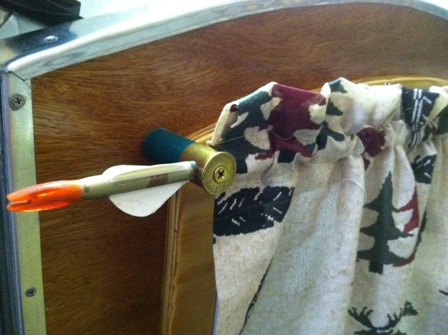

Arrows and shotgun shells, a man after my own heart. 8) Clever and cool and original and maybe even soon to be copied. :R

I really love those fenders and the way you did your curtains. That is very cool! :thumbsup: Do you shoot a bow? I recently bought a used

crumbruiser wrote:Arrows and shotgun shells, a man after my own heart. 8) Clever and cool and original and maybe even soon to be copied. :R
frank
They say Plagiarism is the greatest form of flattery :lol: Didn't notice until I got to looking at the picture that I had that shell upside down! :x More work...
