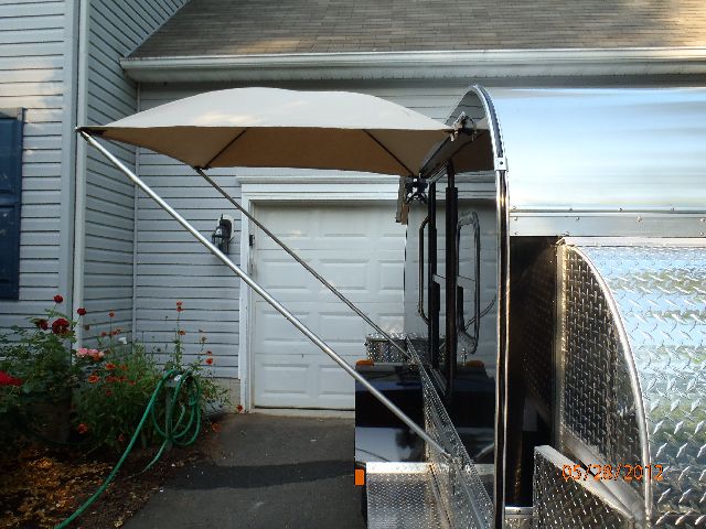

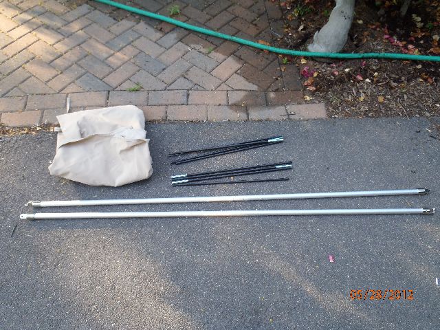

Thanks for your interest, Here is a new photo of the awning set-up:
The costs are as follows, including suppliers. Each peice is relatively inexpensive, but it adds up. Everything we purchased was stainless steel and as high of quality as we could afford.
Per awning:
1 ½ yard sunbrella fabric: 33.00/yard -----------------------------48.00---Outdoor Textiles
¾ “ Sunbrella binding 15 ft-------------------------------------------4.50----Sailmakers Supply
2” webbing 1 yard-----------------------------------------------------6.00----Joanne Fabrics (poor Quality)
Heavy duty webbing 1 yard------------------------------------------6.00----Outdoor Textiles
5/8” rubber grommets #2---------------------------------------------.50-----Harbor Freight
3/8” seam stick (aids holding hem for sewing--------------------7.76-----Sailmakers supply
Coleman tent pole kit 6.88 each-----------------------------------13.76-----Walmart
Keder awning welt :6 ft----------------------------------------------6.00-----Sailmakers supply
7/8” aluminum tubing 6 ft long 10.44 each---------------------20.88-----Brunner Enterprises
Awning rail 6ft:-------------------------------------------------------14.88-----Brunner enterprises
Taco 7/8” ball and socket top cap 15.00 each------------------30.00-----Defender
Seadog deck hinge : 10.95 each------------------------------------22.00-----iboats
Seadog top Cap: 5.50 each------------------------------------------11.00-----iboats
------------------------------------------------------------------Total 191.28 each awning

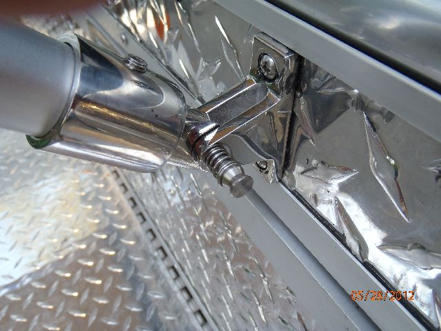

Awning parts broken down, aluminum poles break down into two parts each.
Detail of top of pole. Ball and socket fitting.
Bottom of pole. Bimini Hinge and cap.

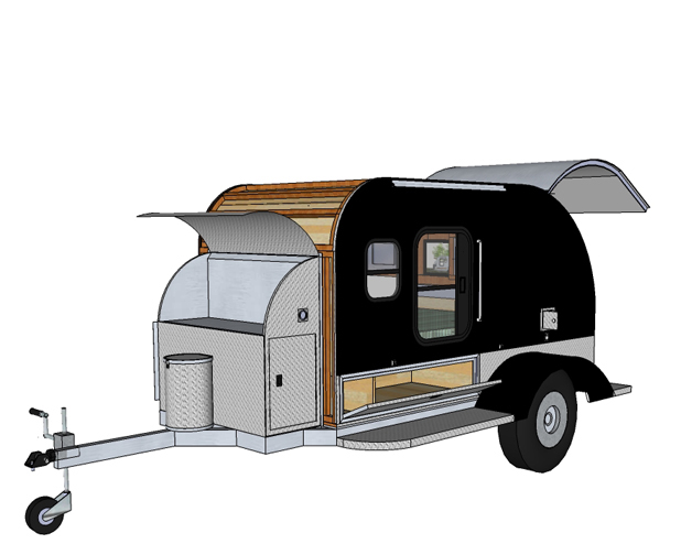

I love how the sketch up and the real deal match. The CrowsWing turned out to be sweetness on wheels! :beautiful: I can't for the life of me understand why you have so many views and so few replies....makes no sense to this monkey. :?

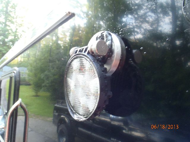

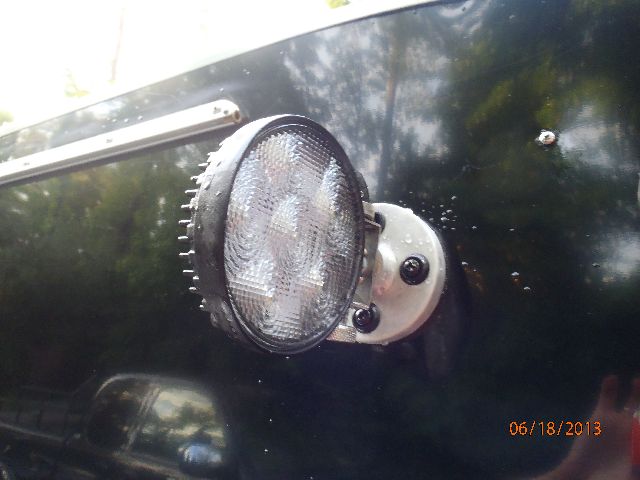

Old Porch light set-up. Worked okay but was clunky. Adjustable to shine out, down, or behind trailer.

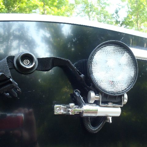

New set up. Simpler design, now adjustable to shine 360 degrees.
This light mount was assembled from an aluminum pipe flange and bushing from McmasterCarr and various other parts.

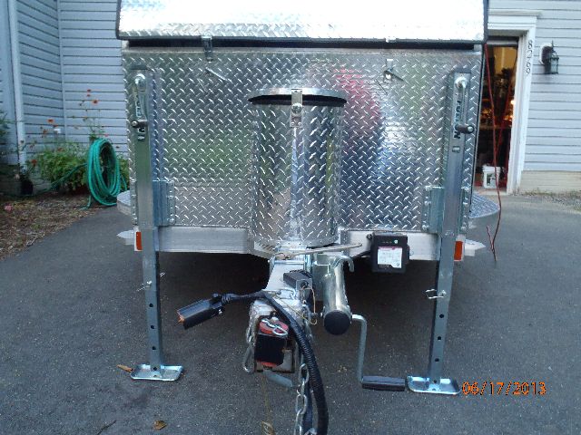

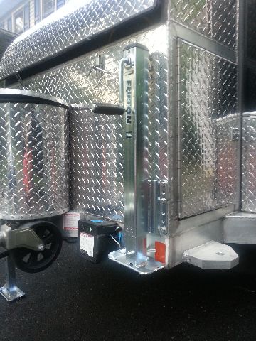

New drop leg jacks used as stabilizers on the front of the trailer. Very helpfull in leveling trailer.
Jack in up position.

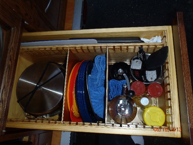

Drawer dividers purchased from Amazon.

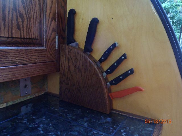

Knife rack I built after seeing one at the First landing Teardrop Gathering that Jim and Jamie made for their Camp-inn trailer.

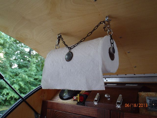

Simple paper towel holder, made from leftover stuff. The weight is a pendant that my hubby gave me that was too heavy to wear.

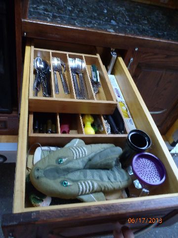

Adjustable drawer divider system, also made with leftovers. Finished with spar varnish.

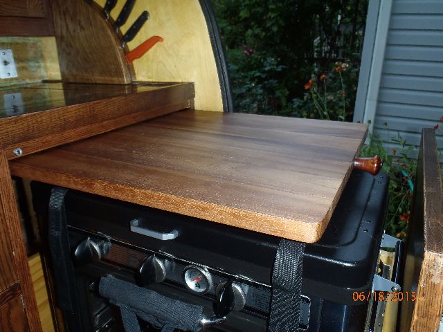

Cutting board/ work surface. made from a Paula Deen's cutting board that just happened to be the exact right size .It is supprted by aluminum c-channel attached to the sides of the cabinet (also leftover). It can be removed completely to be used on a table.
