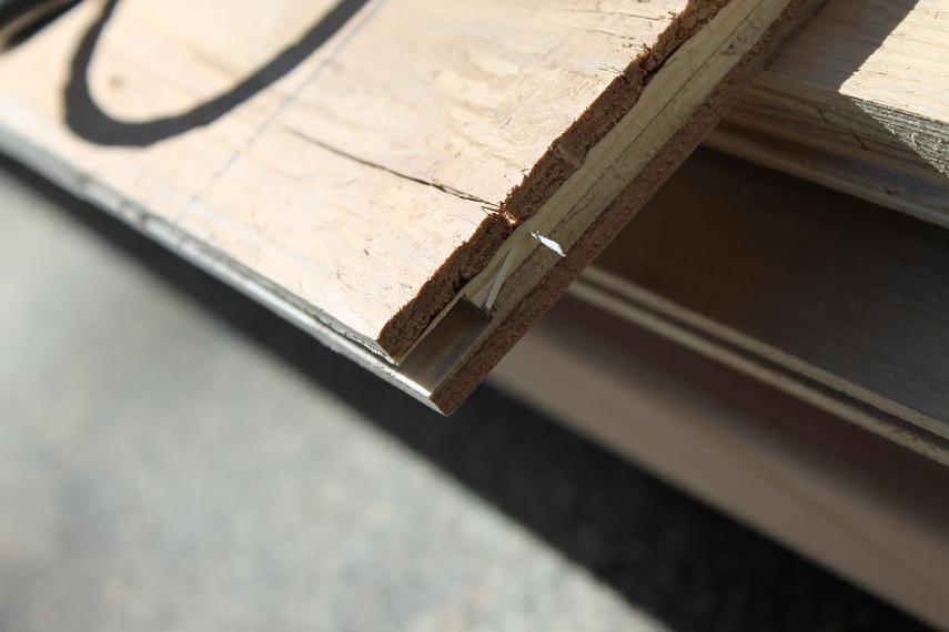

A close-up of the joint that my router made with the special bit. Two of these butted together, with a 1/4 board glued in place acts like a continuous biscuit.

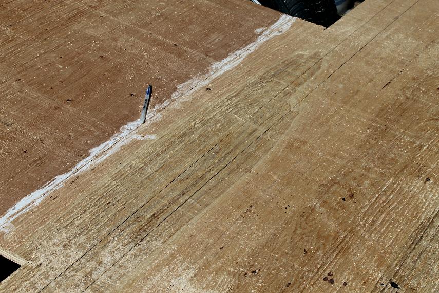

I used plenty of glue as you can see here, I smeared the excess with my fingers.

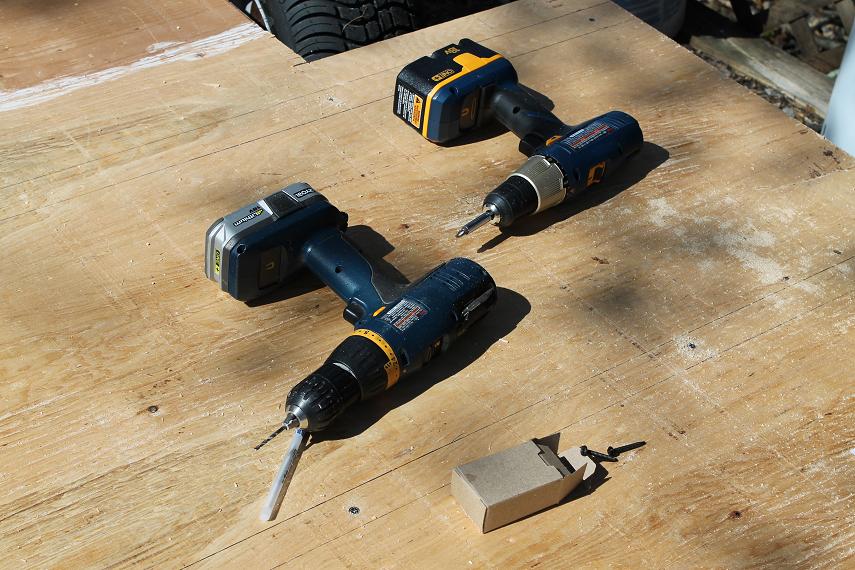

Today's lesson learned. Self tapping screws pretty much suck. I ended up pre-drilling all the holes, hence the need for two drills. There are 46 screws holding the floor to the frame. This was how the original pop-up was done. No bolts, just lots of screws.

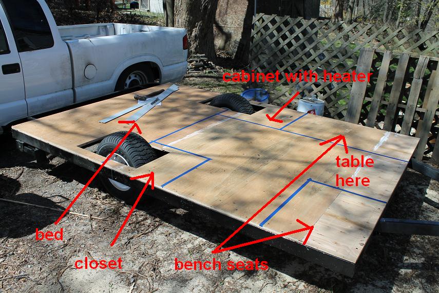

And lastly, I laid some tape down on the floor to get a feel for the dimensions. The tape is a little misleading because the walls curve out in the front and back, so the bench seating, and the bed will actually have a larger area at 14" above floor level.

Hard to tell from the pic if your flooring has reduced the original size of the wheel well opening??? Wheel removal on that frame style is a PITA as designed, sure don't want to compromise it. Just can't tell from the pic, thought it worth mentioning.

Thanks for the concern Gary. I read here, perhaps your thread about the necessary size, so the openings are exactly the same size as in the pop-up floor. 17" opening starting at 3" in from the frame. I suppose it wouldn't be a bad idea to check it though while it is still very easy to enlarge. I'd hate to find out when I'm done I needed another half inch. :?

parnold wrote:I suppose it wouldn't be a bad idea to check it though while it is still very easy to enlarge. I'd hate to find out when I'm done I needed another half inch. :?
Good plan!
If it's tight.... Try jacking up the frame vs. the axle. Don't forget to block the tongue jack wheel if ya got one. Jack stands would be a good idea too. Tire wrestling on a jacked up frame can be a bit .....uh, shaky. Don't ask me how I know. :lol:

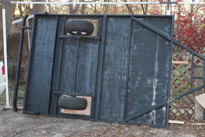

Got the underside coated with UPOL Graviguard. It is actually an automotive chip guard. It dries a little harder than undercoating.
