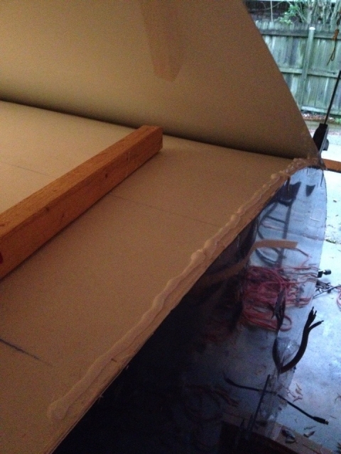

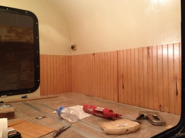

Putting more panelling on the cabin walls

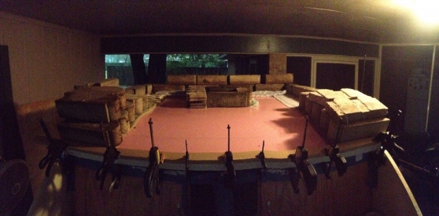

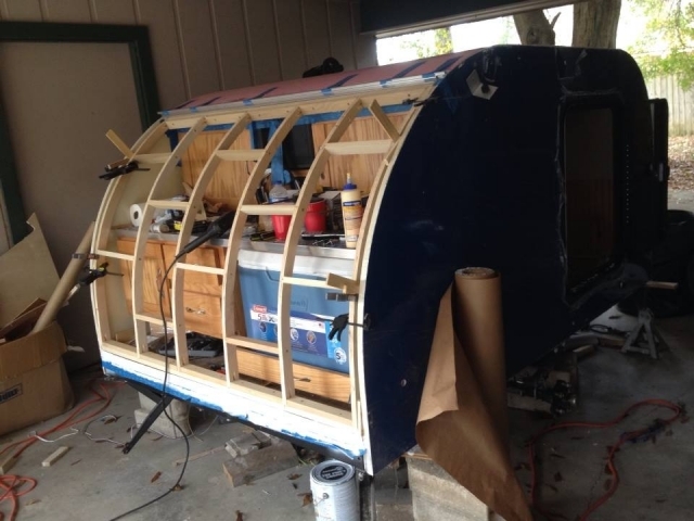

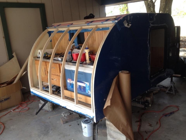

Glueing the aluminum to the roof. Using 3M 4200 Marine Adhesive just around the edges to let the aluminum flex when the temperature outside changes. No the aluminum is not painted pink. That's just the protective coating to prevent scratches.

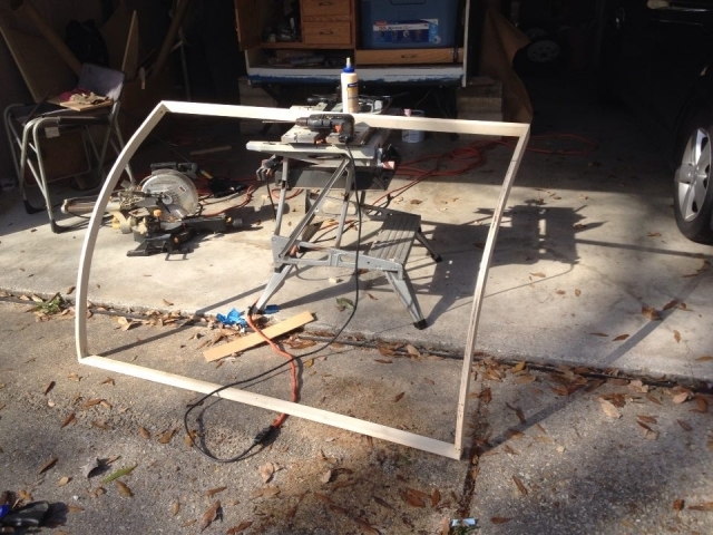

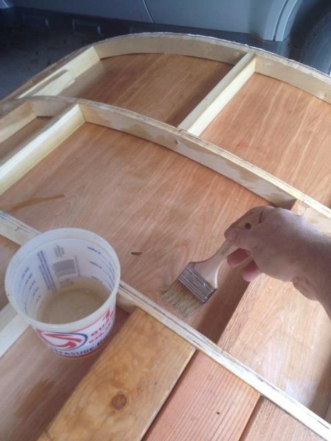

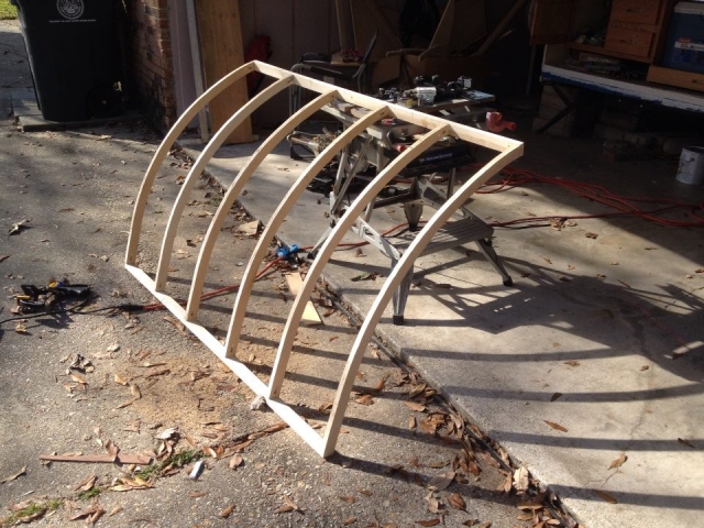

Building the frame for the galley hatch.

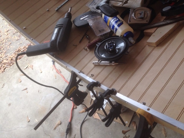

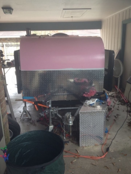

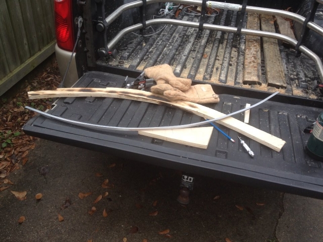

Postby Tommy2tone_1999 » Mon Jan 12, 2015 9:14 am

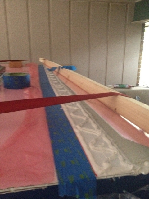

Overlapping sheets of aluminum on the roof.

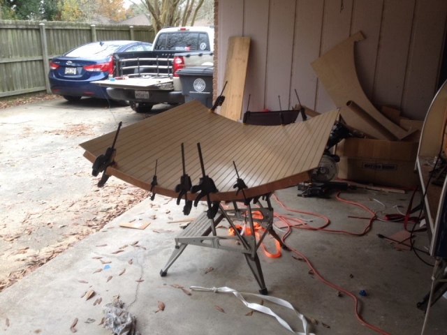

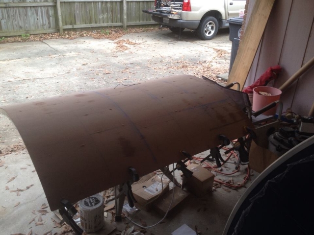

Bending bead board panelling for the inside of the hatch.
Bending and applying the aluminum trim for the inside of the galley hatch.
Moisture proofing the inside sufaces on the hatch.

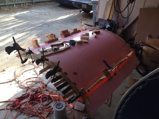

Putting the outside plywood on the galley hatch.

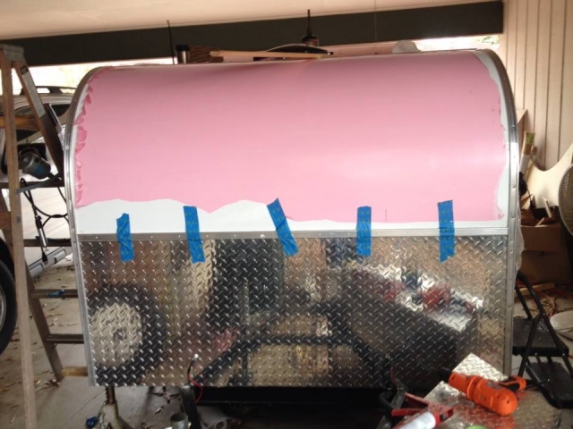

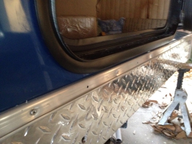

Diamond plate trim along the bottom

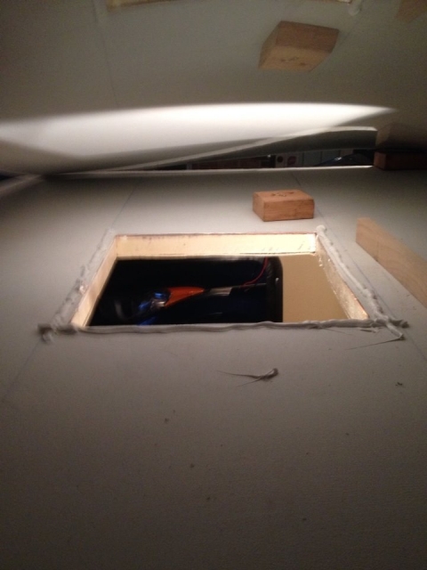

Screw holes on the outside of the hatch sealed

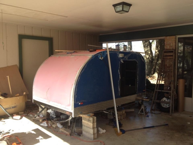

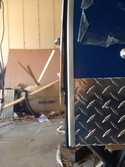

Diamond plate rock guard in place.

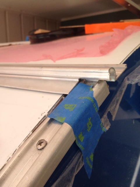

I have a small dilemma. There is no spar behind the top edge of the rock guard, (ie nothing to screw into). What is the best way to attach a trim molding to the upper edge?

Postby dales133 » Sun Jan 18, 2015 4:01 pm
If you've got nothing to screw into polyurethane adhesive?

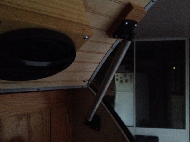

Postby Tommy2tone_1999 » Mon Jan 26, 2015 9:11 am
Glueing the aluminum skin to the hatch.
I had some spring back in the hatch after putting on the aluminum skin. Nothing a few screws won't fix. They'll be covered up by the edge trim later.

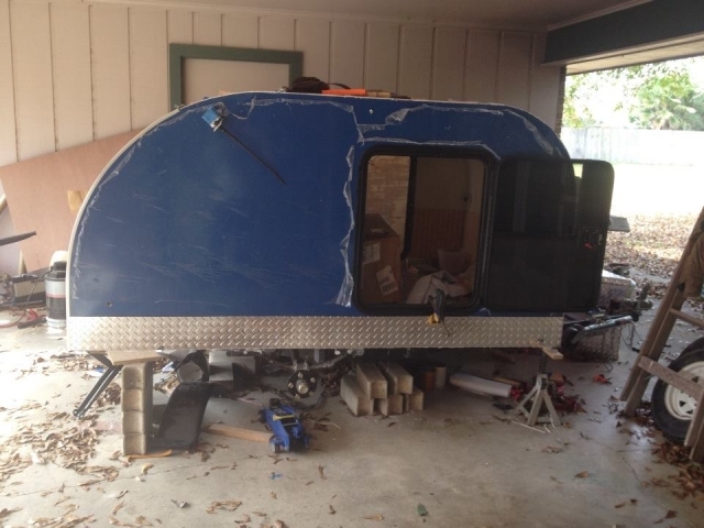

Checking the fit on the hatch.

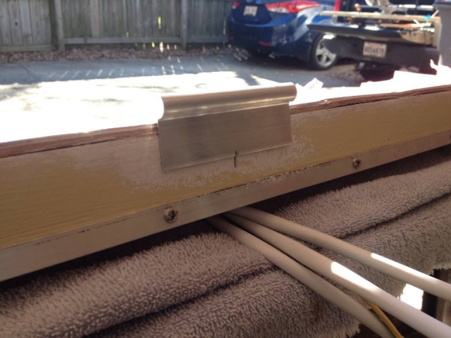

OOPS!! I cut the top of the galley hatch hinge too short, it doesn't overlap the edge molding on the galley wall. Good thing I saved the scrap piece. I cut the hing in half (on the hatch side) and put the scrap in the center. It will be sealed to the hatch with marine adhesive so it shouldn't leak.
In case the split hurricane hinge leaks, I came up with a mini gutter with a diversion hose to catch any drips and carry them outside the galley.
The hatch is in place but there is some spring back. Looks like I'll need a little extra weather stripping and some draw tight latches.

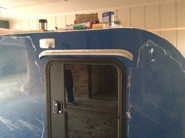

Gutters over the doors installed.

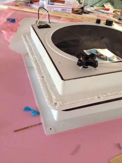

Re: Mobile Fit Club Build - Tommy2tone_1999
Postby Tommy2tone_1999 » Tue Feb 03, 2015 9:53 am

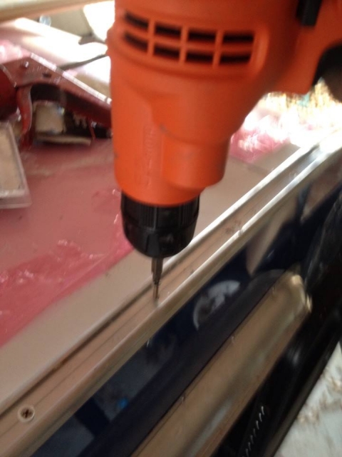

Installing the vent.
Aluminum trim going on.
(Nothing to screw into behind the skin, so I simply glued it on with 3M adhesive (4200) and 2 screws on the ends holding the caps down will keep it in place.)
