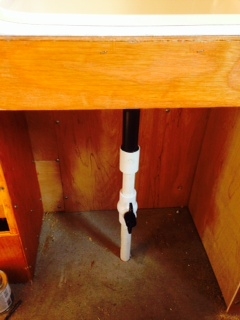

Postby Gold5one » Sat May 16, 2015 6:52 pm
Got the sink in place today- I'm working slower now as it is up to 95 already here.
I can sit on the edge of the bed and have comfortable access to the sink- a much better location that in the corner and having to stoop over. Next- install the drain pipe and the 4" PVC-
There will be some wardrobe type storage in the corner.

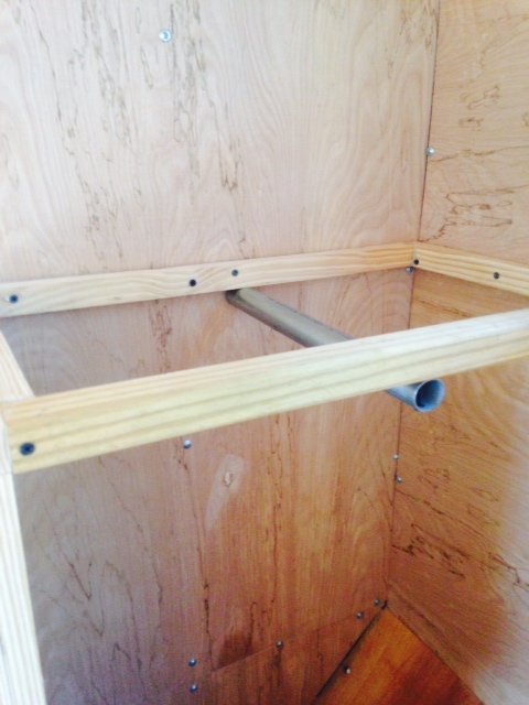

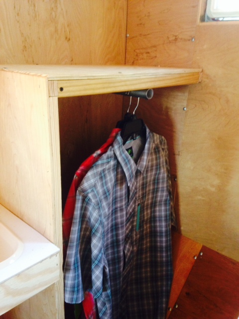

Postby Gold5one » Mon May 18, 2015 5:48 pm
I got a little more done. I only work a couple hours in the morning, due to the heat and humidity - it's been 95 degrees 2 days in a row.
The hanger rod is made from a piece of 1" electrical EMT conduit- I should be able to hang up a dozen shirts and some pants. If the hangers bounce off the rod, I will have to install a piece of shim plywood above the rod to reduce the gap above the rod.
What to do with the top? Leave it as is and use it for a TV, put a storage box on it? Build some cubby shelves? Pantry storage? I don't know- maybe someone with experience knows the answer. The sink drain pipe will be next.

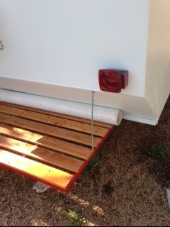

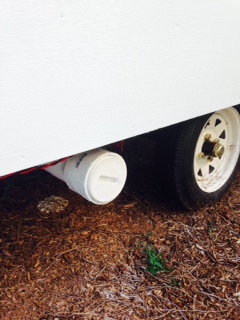

Postby Gold5one » Tue May 26, 2015 5:53 pm
The sink, drain and gray water storage is 95% done. The location of the 4" PVC is directly under the frame and 20" behind the axle. This worked out better for the drain= straight down. The location of the PVC will result in a lower center of gravity and better weight distribution. The PVC pipe holds 3.3 gallons of drain water.
I still need to install a small drain valve in the end of the pipe so I can use a short section of hose to drain out the gray water. The total cost of this sink addition was about $60- thanks in part to some salvaged 4" PVC from a construction job. The sink was about $25 off of Amazon prime. At some point I will probably install a small water tank under the bed and a 12vdc pump. I have plenty of room under the sink for a couple gallon containers of water. I will need to add a 1x4 board on the floor to keep the water jugs in place.
