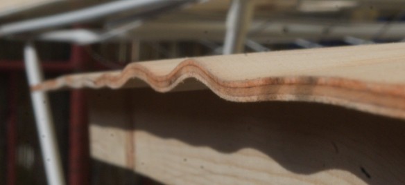

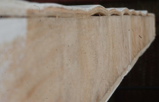

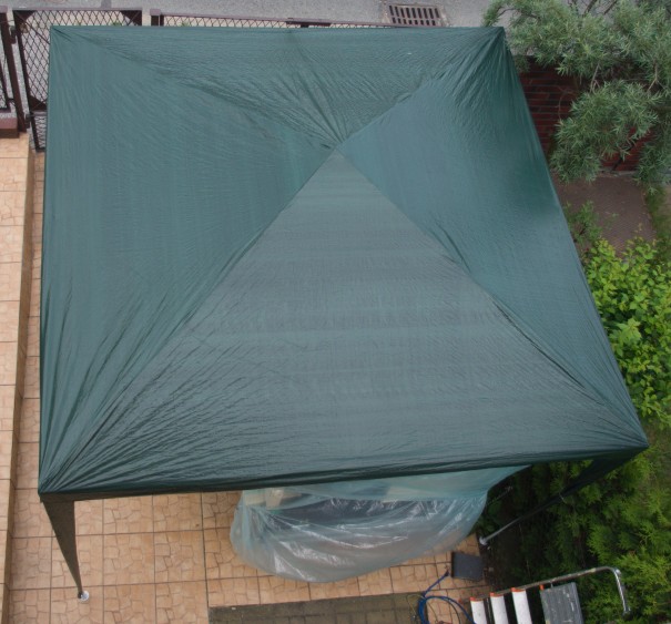

I partially dismantled my caravan box. Roof as well as front walls are removed and need to be repaired. Plywood that was on external parts looks like on the pictures.
I bought new pieces of a plywood and also a small gazebo under which I keep my trailer in case of rain.
What happend yesterday really upsets me and if you had not told me to try fix the problem I probably would have destroyed the box.

Postby KCStudly » Mon Jun 29, 2015 3:05 pm
Squirt some glue under those ripples and clamp 'em down. If the overhanging section was not supposed to be trimmed off anyway, perhaps a small bead of 5/8 inch square could be glued along the edge to stiffen it flat again?
I understand the frustration of the moment, but you have to either walk away for a minute (or day) and collect your thoughts so that you can analyze the problem with an open mind. Thus finding the most logical solution to move on. Most times when I find myself in a pickle or don't know how I am going to fix something that went wrong on my build, I will work on another aspect for a little while. That way I am still making forward progress and I can ponder what the fix needs to be. Usually with a little time the solution presents itself and is not that much of a big deal once it is done. Okay, looking back some things took a lot more effort from start to finish than they should have, but that's part of the building process; learning as we go.
Only undo the absolute minimum that you have to to make the repair. It will cost less money and time that way.

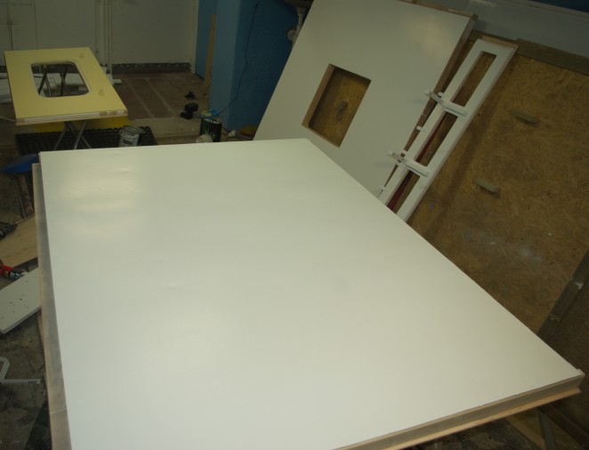

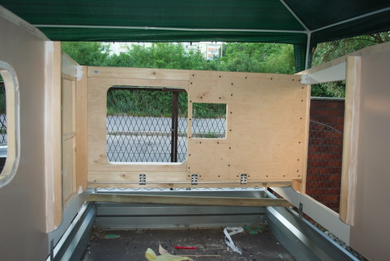

Everything is nearly ready for a final part: joining roof panels with walls. Old, damaged plywood is replaced with a new one, rear wall is insulated and have both layers of plywood, wall between child bedroom and main room is insulated as well, walls in child bedroom are finally painted. All parts of ceilling are also painted. I cut out a little bigger entrance to a child bedroom as well as made an opening for a storage compartment, accessible from child bedroom.
On lower edges of my caravan box I applied self-adhesive, round "legs" made from teflon, to keep a small distance between wall and a trailer board. On sides of walls there are metal elements that will hold boards and ensure walls will not bend. SImilar element will be installed inside, also.
I decided to use a polyurethane varnish for newly built external parts. It is designed for painting garden chairs, tables, fences and wooden finishes of buildings. UV protected, water and weather proof, allowing walls to "breathe" and long- lasting. I hope this is a good solution...
Now I wait until weather forecast will say there will be no rain for at least two days...

Postby Sheddie » Fri Jul 03, 2015 4:25 pm
Hi Tom,
Good to see you are back in to it and progress is happening :thumbsup:
You will need to make sure that what you are painting the exterior with is soaking well into the ply as well as creating a water resistant barrier, as the wood in the ply looks like it is quite absorbent. Apply plenty of coats. ;)
