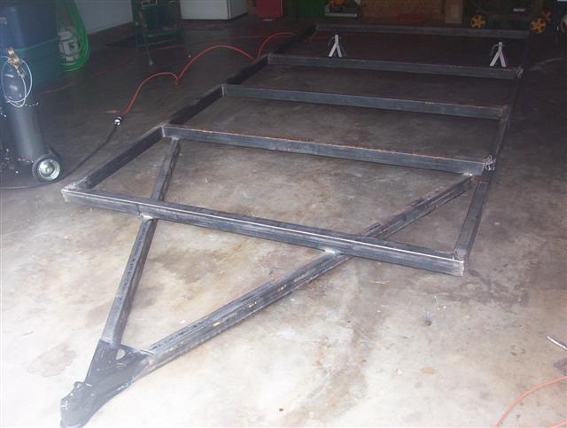

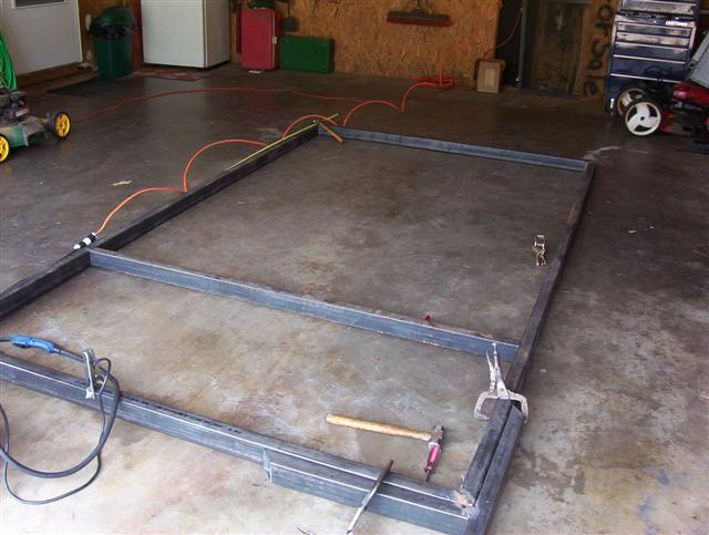

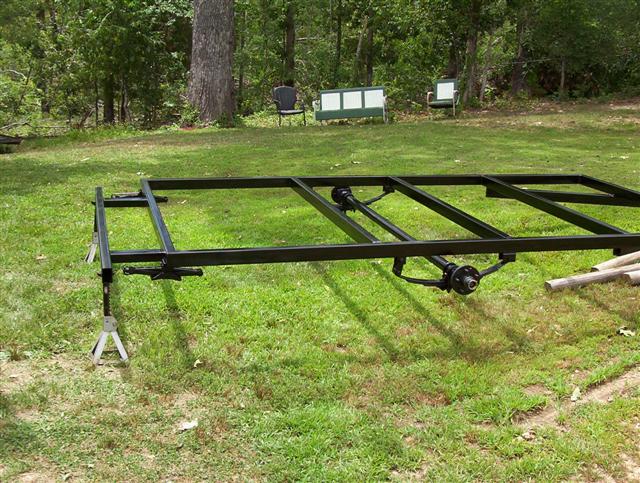

Well I started my build here is a few pictures.
Here I'm trying to square the frame.
Here is the trailers top side.

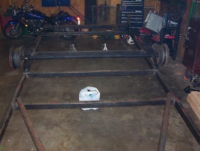

Trying to show the frame with an axel.

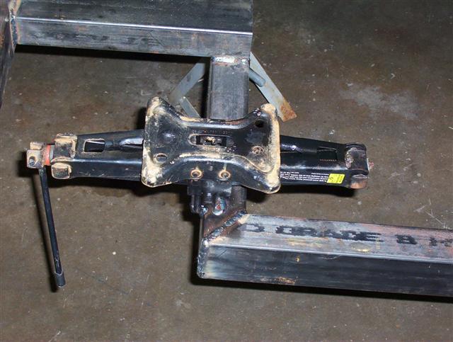

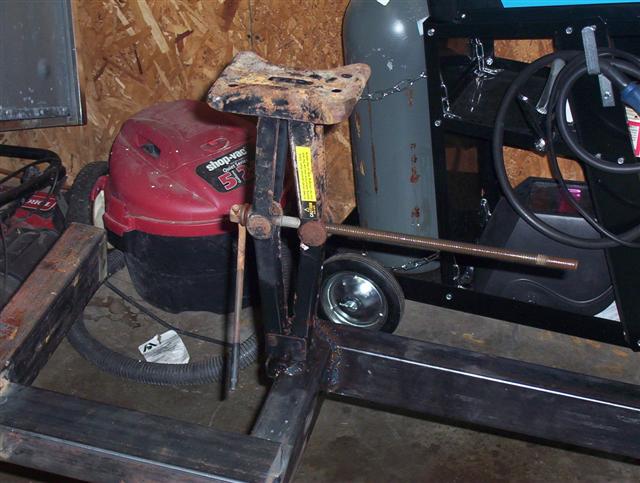

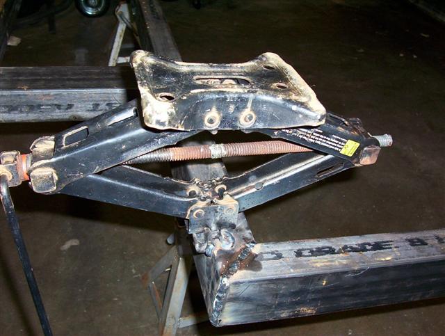

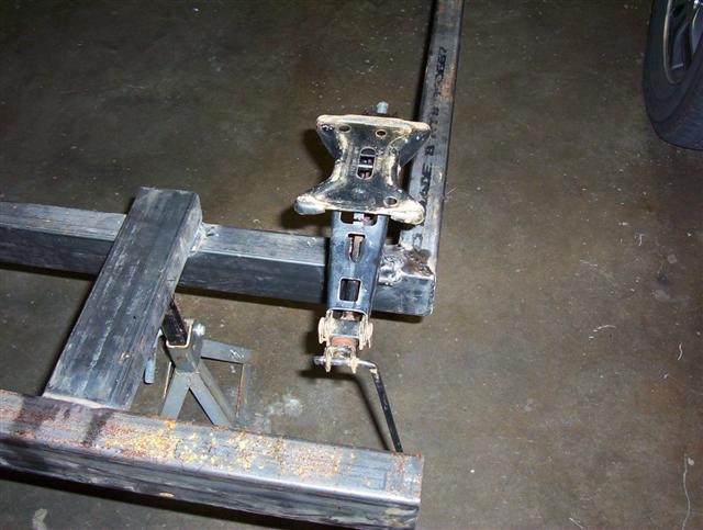

The following is how I used a car jack for a stablizer jack.

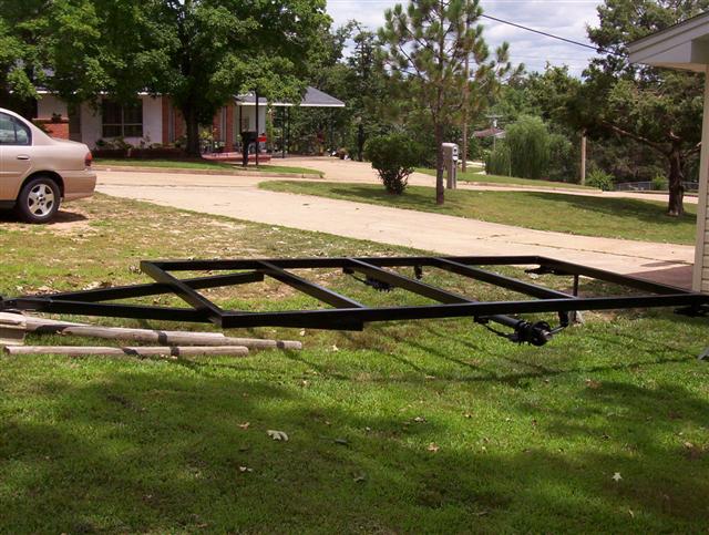

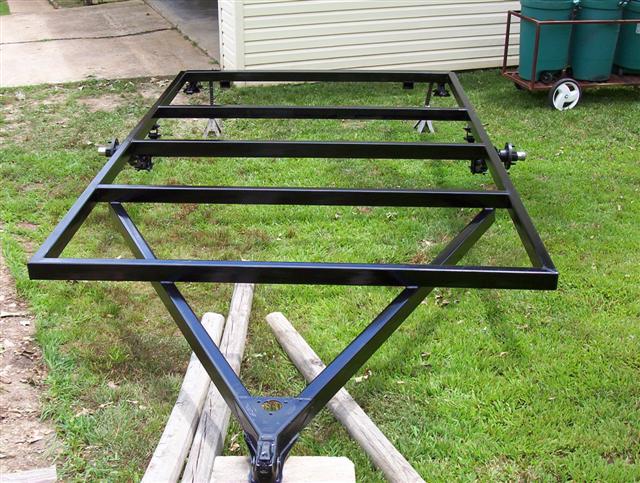

Postby WayneFromMo » Sat Jul 18, 2009 2:02 pm
I finished the prep on the Frame and painted it.
Do I need the axel overslung or underslung? My hubs fit 14" Wheels.

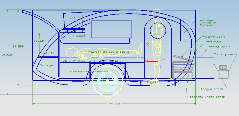

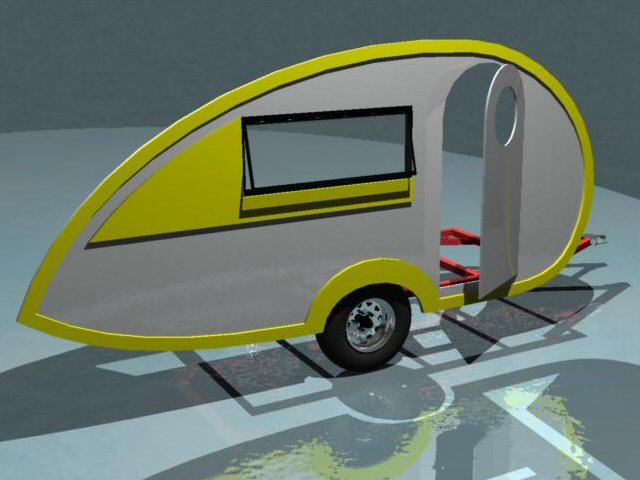

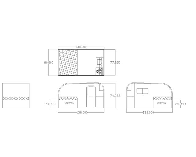

Postby WayneFromMo » Sat Jul 18, 2009 2:28 pm
I Guess I could use a little help on picking a layout. In both profiles I put every thing I needed in first and then worked on the outside.
This is Profile #1. In this profile I cannot use the large window in the rear.
In this profile I can use a large window that I salvaged from a wrecked RV.
Which profile should I use?

Postby mikeschn » Sat Jul 18, 2009 3:34 pm
Good looking frame. What's next, the side profile? What flavor are you thinking?

Postby WayneFromMo » Sat Jul 18, 2009 5:19 pm
Thanks, As far as flavor, I like to keep it simple. I feel it's easier to maintain. I wanted to build a Winter Warrior, but I couldn’t keep it from gapping or binding up in my PRO E. Plus I needed a little more room for my hunting gear and a full size bed. I like the looks of the Benroy TD. I also like the looks of the T@B and R-POD campers. I also was lucky enough to pick up a large window out of an RV. I was maybe hoping to use it. Those windows cost a lot of money new. So I was looking for an experienced opinion on the design. I believe I can still build either one.

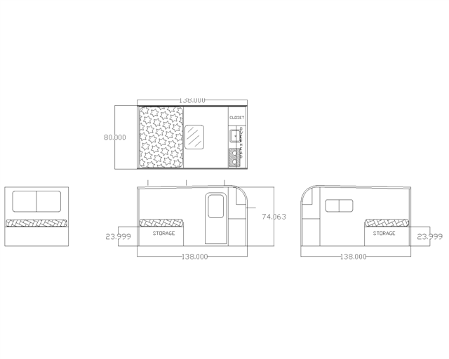

Postby mikeschn » Sat Jul 18, 2009 5:52 pm

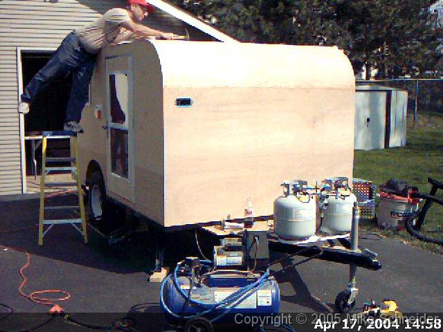

If you want an opinion, go for a curved profile... it's stronger, easier to seal, and looks good.
P.s. here is the beginnings of my mini tab design...
Postby WayneFromMo » Sat Jul 18, 2009 6:32 pm
I've been reading your thread for the T@B, made your mind up on how to build the trim?
Do you think I need to have the axel under the spring or on top of the spring. I'll be using 14" wheel and tires? I'm thinking of putting the axel under the spring it may ride better with my truck.

Postby mikeschn » Sat Jul 18, 2009 6:35 pm
I'm planning on using a torsion axle to get it as low as possible.
If changing your axle is not an option, put the axle above your springs to get it lower.

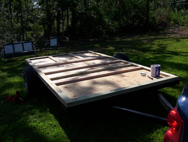

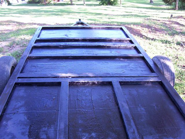

Postby WayneFromMo » Sun Aug 02, 2009 7:45 pm
I framed the floor this weekend. I also managed to seal it. I'm not too worried about the floor. I framed it with pressure treated wood.
So I'll wait for the sealer to dry, flip it over, and bolt down it next week.

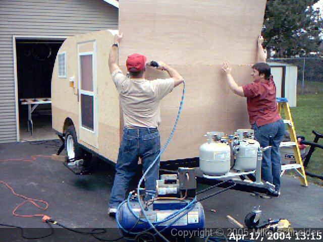

I have bent 1/4" plywood over a 24" curve, but it's tough. Best to wet it a little bit... errr... make that "a lot"...
BTW, the nailer didn't work. The nails pulled right thru the plywood. We ended up using roofing nails and a hammer...
