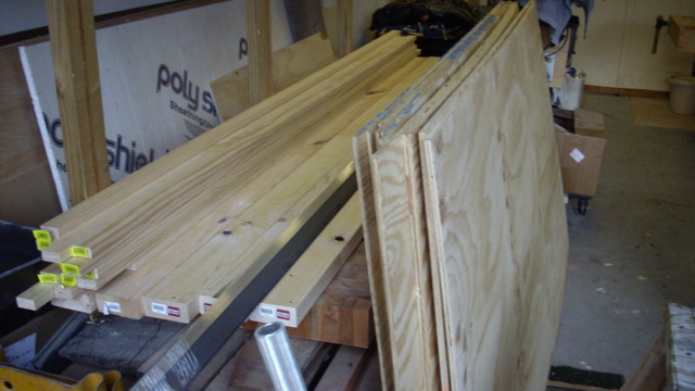

Waitin for a little glue to set so I will take this time to get caught up to present.
I have done All the shopping for the build. Still need to get a mattress, but that can wait.

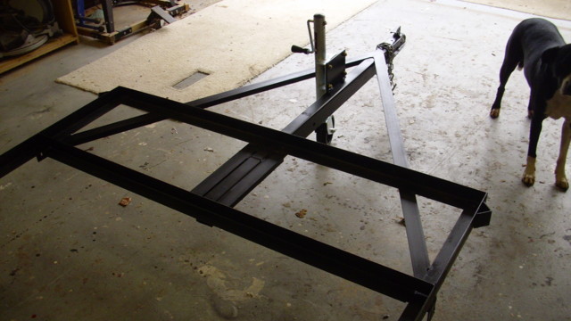

I'm using the NT 5x8 no floor again.
While a NT I also picked up the trailer jack, the paint to finish the ext. and a 100' extension cord for the elec. $487.43
Finished the Trailer Modification.
Plywood and 1 by from the Big Blue Store. $236.53
Air Conditioner and Frig from Sears. $237.87
Epoxy US Composites $75.00
Windows from local truck cap co. $183.14
Steel Angle and Trim Alum $31.79
Elec Supplies, Stains, Poly, Glue ect. $193.16
Total so far; $1444.92

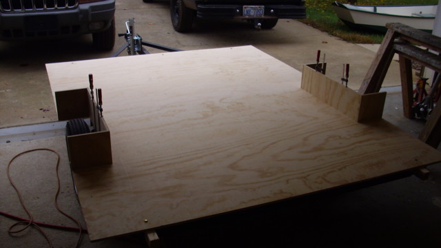

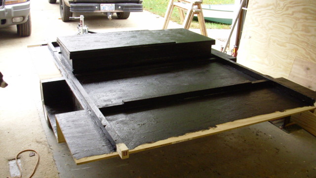

Postby shopfabricator » Fri Oct 30, 2009 10:27 am
Floor ready to flip, build drop and seal.

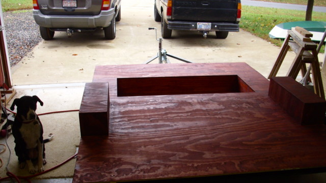

Postby shopfabricator » Fri Oct 30, 2009 2:06 pm
Phones been ringing all day. Seems that everything that had to be ordered has come in today, so I am going to pick up the windows, air and frig. I'll see if I feel like bolting the floor down when I get back.

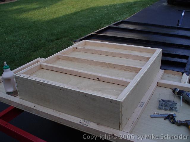

Postby mikeschn » Sat Oct 31, 2009 11:19 am
I think Gary drove the screws into the end grain of the plywood. Not sure though, he'll have to confirm that.
Meanwhile, here's one of the dropped floors that I built!
Postby shopfabricator » Sat Oct 31, 2009 12:01 pm
Hey Mike! That looks good!
I frame the outside of the drop sides and screw the bottom to that. It allows a couple more inches of headroom without sacrificing clearance. Also double layer the ply on the main section of the drop to stop spring.

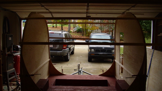

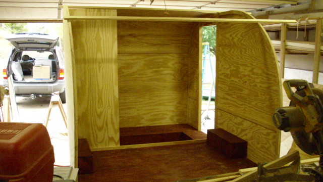

Postby shopfabricator » Sun Nov 01, 2009 10:33 am
Starleen 2: I'll be sure to get lots of pics when I build the door and step. I do my drop floors with a "step over" on the frame. More about this later.
Walls roughed in and standing. Using 3/8" this time on the walls and they really need the remaining internal framing to flatten them out. Almost most looks like I'm trying to build a ball right now.

Postby shopfabricator » Sun Nov 01, 2009 3:08 pm
Walls are flattening out but there are fight me all the way. :x
As I frame for the each section of roof I really have to push/pull and check the walls for flat.
The front have shows flat while the back has a "bulge".
