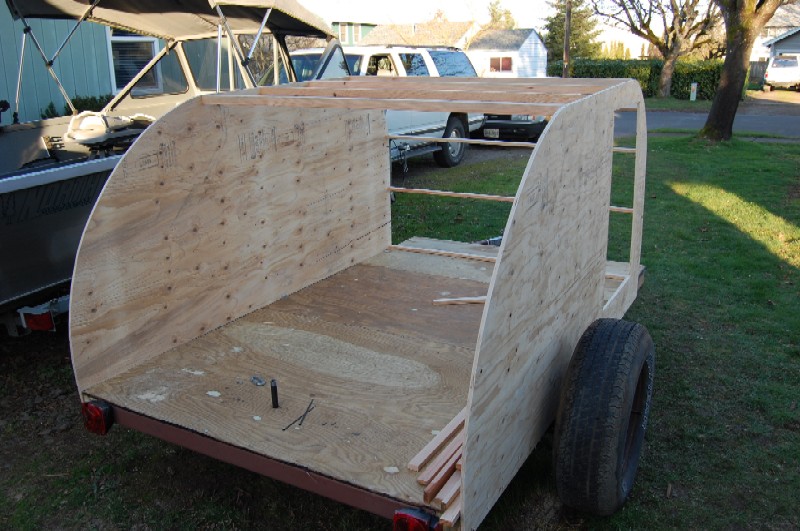

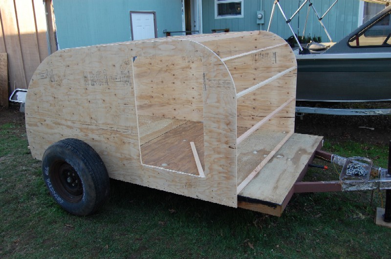

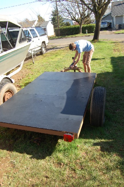

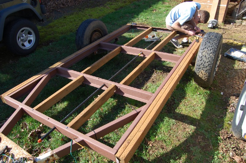

Well we are finally starting to build on our teardrop. I located an old RV frame from a demo guy. I drove the frame into work, where I cut down the frame to size and relocated the axle. (That was last year)
I decided to train for a marathon....that took most of my free time and the frame sat....waiting. I finished a marathon (check in box) now to build a teardrop.
When I cut the frame to size I took the outriggers completely off, you can see the addition of 2x4 PT on the outside frame rails. I should have cut the outriggers to size. Oh well.
I went back to the RV demo guy and picked up windows and exterior door frame. The exterior door was cut down to the size I wanted (34" tall X 30" wide). My original thought was a 24" wide door, I'm glad I went larger.

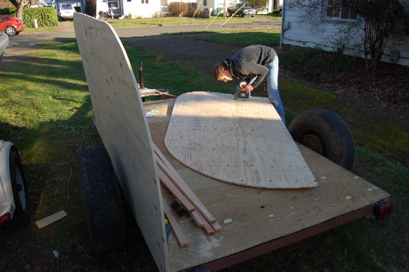

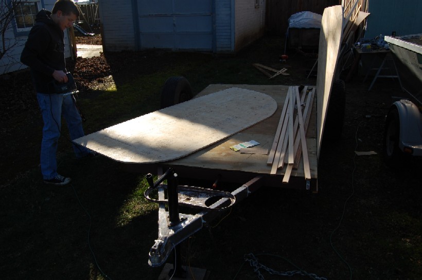

OK, your up to date with the little details.....here are the photos as of today.

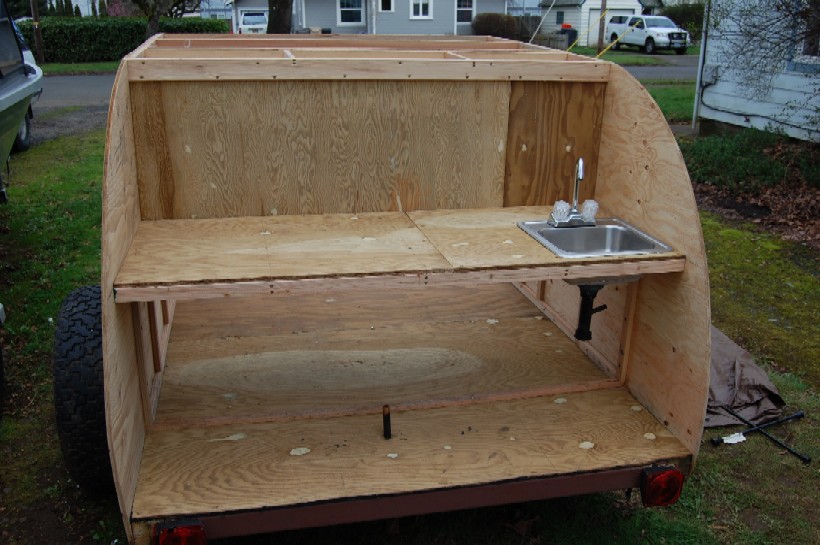

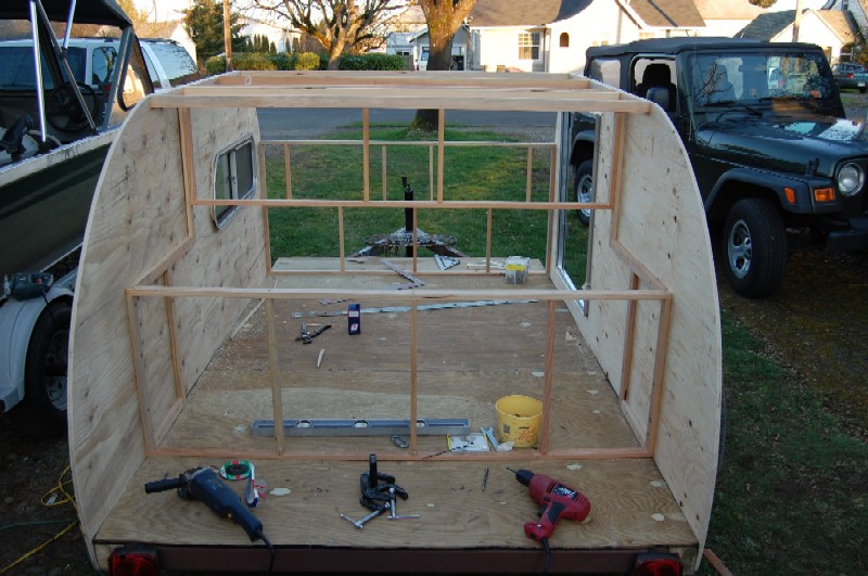

2/27/10 - you can kind of see where I'm trying to go with the galley. Today I also realize that I'll need to have more backers.
