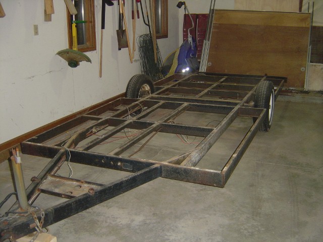

After months of reading, I finally wiped the drool off my face and started a build of my own.
I am starting with a 1986 viking pop-up camper, it measures 12' x 6'. I gotta fit me, my wife, kid1, kid2 and kid3. Hence the bigger trailer. I went with a 6ft trailer so my wife and I could fit in a bed crosswise in the trailer and not take up as much length. (Were short, im 5'6" and my wife is around 5') Possibly doing bunks or fold down couch for the kids. Also, the wife has requested a table/eating area.

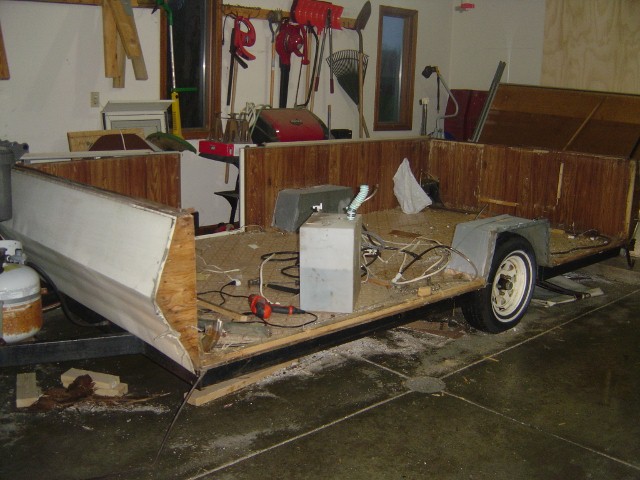

Part way through teardown.
I am currently down to the bare frame. It has a fair amount of surface rust but nothing structural. I have alot of sanding to do.......talk to you in a couple weeks.

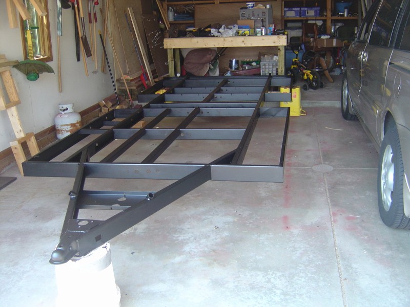

Back From Sandblasting
Postby J.Heyboer » Wed May 19, 2010 8:00 pm
Picked up the trailer from sandblasting today. Looks like new and worth every penny! Even more so now that I don't have to worry about whether or not I got all the rust off. I can now sleep in peace.
Primer goes on tomorrow.

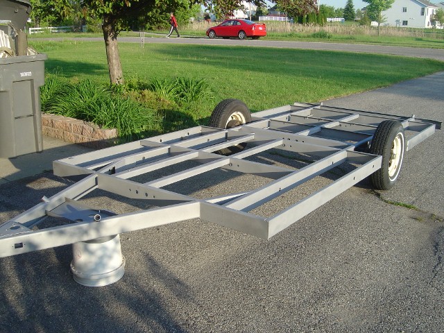

Postby J.Heyboer » Sun May 30, 2010 3:07 pm
Put last coat of Implement Paint from Tractor Supply on the frame today.
