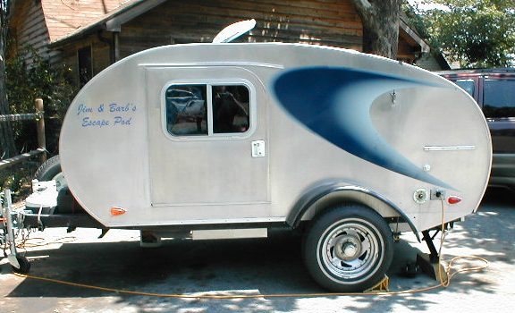

Postby JIML1943 » Tue Jul 27, 2010 6:24 am
Build is looking good.I like the name it fits the little trailers.
Some days all you can do is smile and wait for some kind soul to come along and pull your ass out the bind you've gotten yourself into.
Happy camping Jim & Barbara

Jim - Thanks...my wife came up with the name and I thought it was 'spot on.' By the way, is that the StarTrek 'swoosh' I see on your trailer...an escape pod from the USS Enterprise? I thought about making lettering to look like the hull designation on the side of a space ship/shuttle, so that's why I ask.
