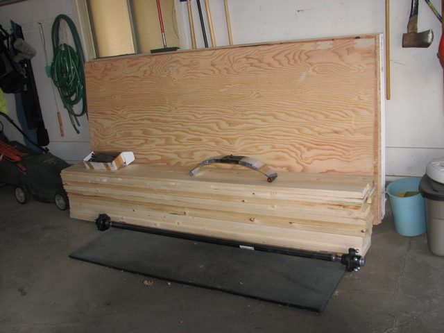

I think I started this in October. This is how it all started:
Just a bunch of wood and some trailer parts.

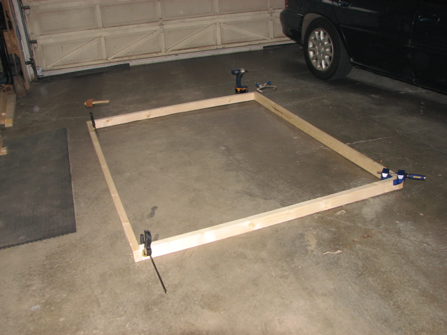

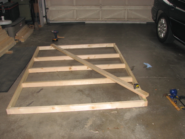

Postby sdave209 » Sun Jan 02, 2011 1:19 pm
I guess I can build the floor while I wait for work to slow down so I can build my trailer.
Trying to keep it square

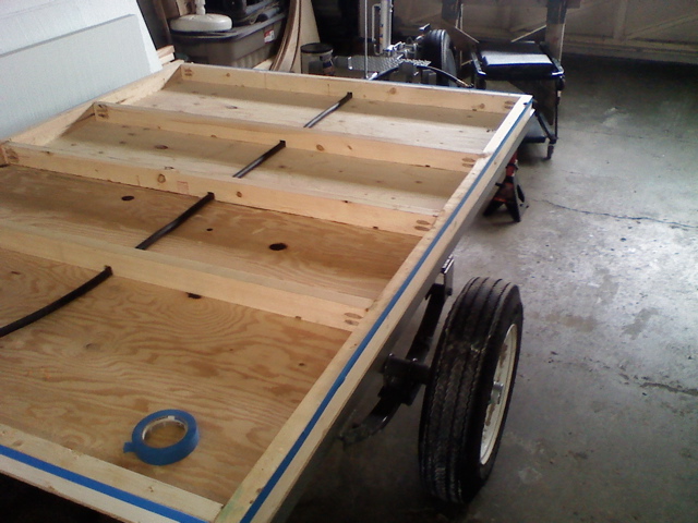

Postby sdave209 » Sun Jan 02, 2011 1:24 pm
Plywood 1/2" cover screwed on
One square, flat floor.

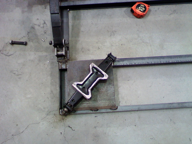

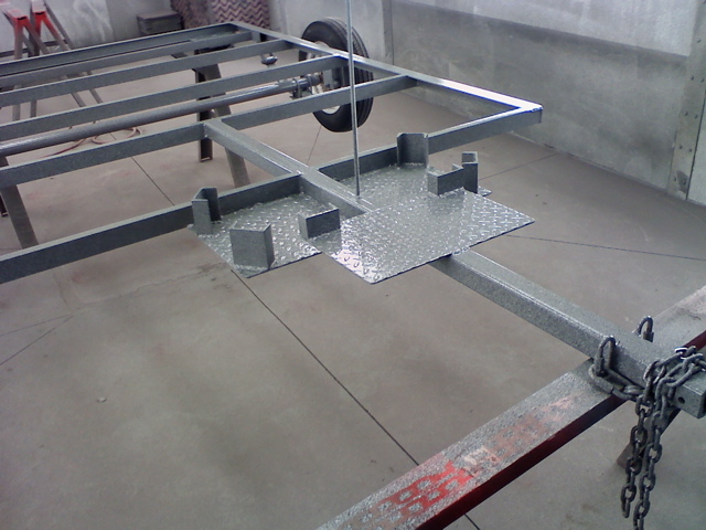

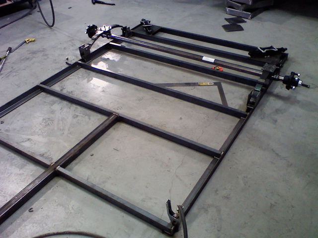

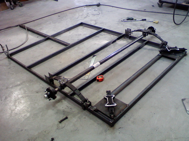

Postby sdave209 » Sun Jan 02, 2011 1:30 pm
Trailer Build
2" angle, 2" channel, and 2"x3/8"HSS tounge
Car scissor jacks from the wrecker on 1/4" plateImage

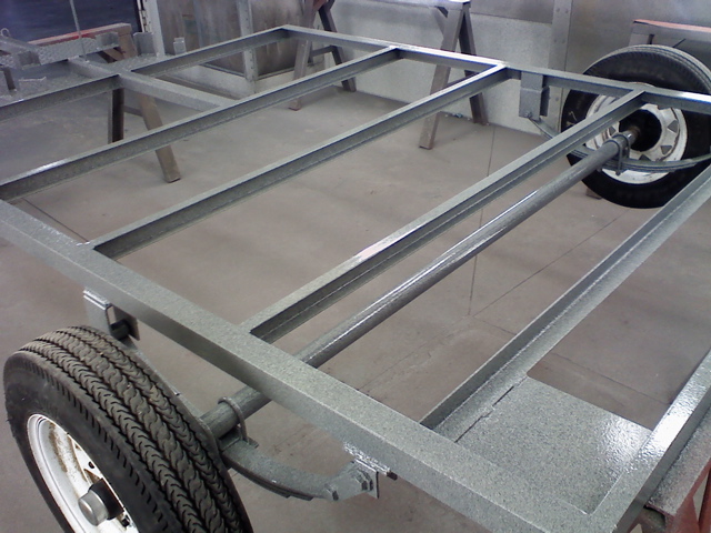

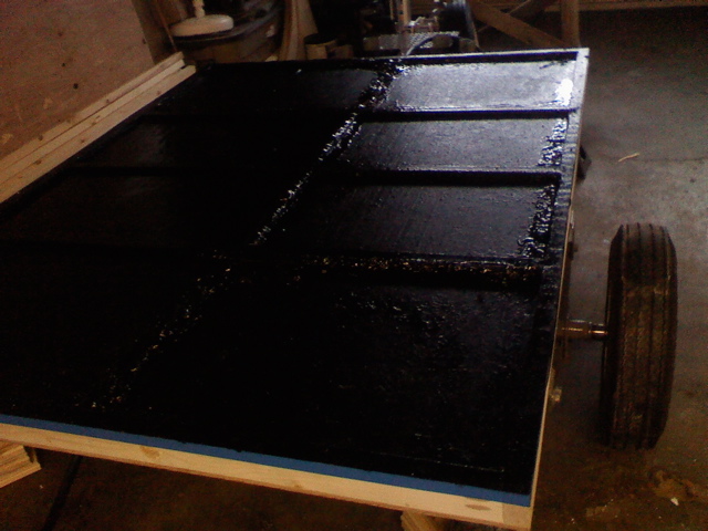

Postby sdave209 » Sun Jan 02, 2011 2:00 pm
Fresh paint
Propane and battery holder
propane through floor

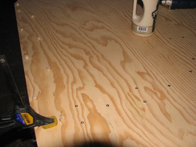

Postby parnold » Sun Jan 02, 2011 4:25 pm
Looking very good! I like your rear stabilizer jacks, I have one on my tongue, works like a charm with my rechargeable drill and a socket.
I'm impressed by your screwless floor. Is there a special reason you chose to do this?

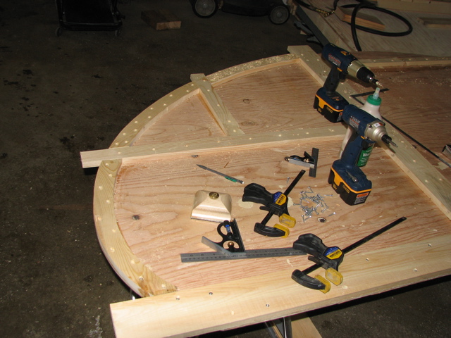

Postby sdave209 » Mon Jan 03, 2011 8:54 pm
Laying out my framing
Gluin' and screwin'

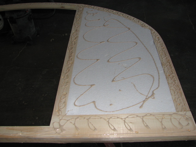

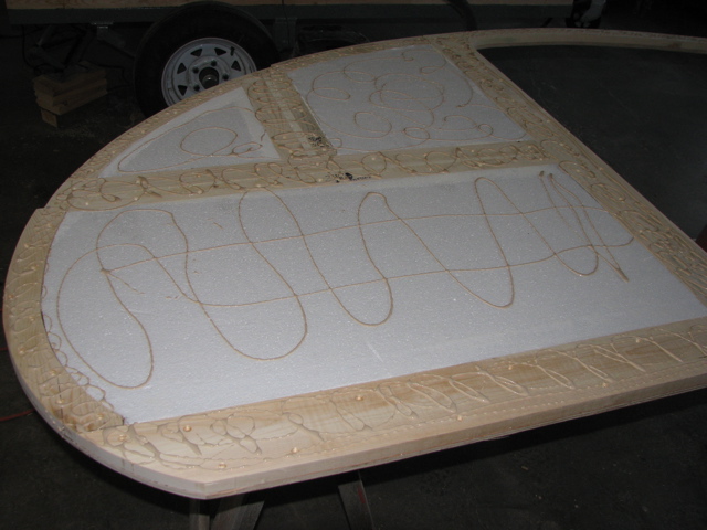

Postby sdave209 » Mon Jan 03, 2011 9:23 pm
Foam.
Ready for skin
Lots of glue

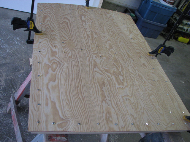

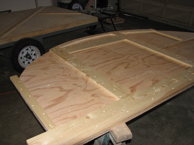

Postby sdave209 » Mon Jan 03, 2011 9:30 pm
Skin glued and screwed on
Curb side skinned
How I trim it to match.

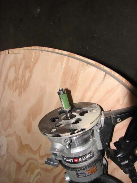

Postby S. Heisley » Mon Jan 03, 2011 9:36 pm
Your build seems to be really well thought out. I look forward to seeing more! :applause:

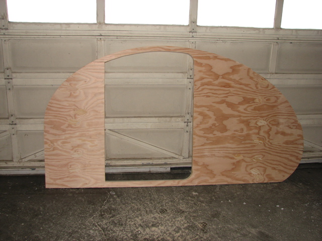

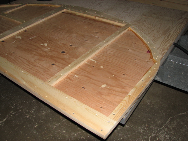

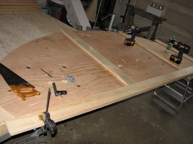

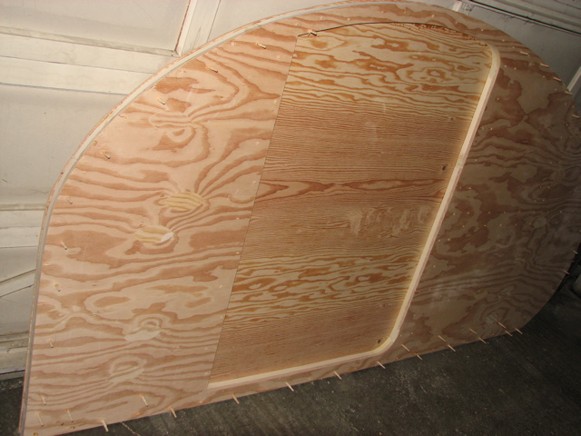

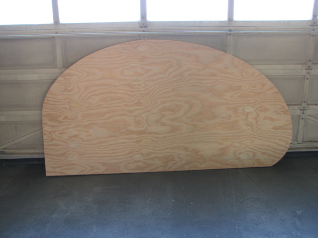

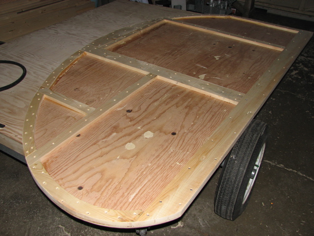

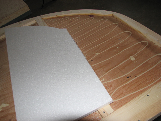

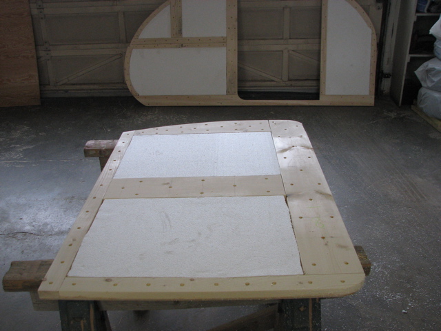

Postby sdave209 » Mon Jan 03, 2011 9:42 pm
Box, open box, closed, 90*, and open.
First I cut out the 1/4" plywood, shaped it, framed it and foamed it.

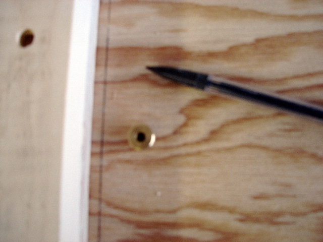

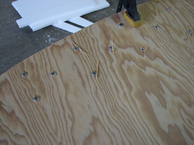

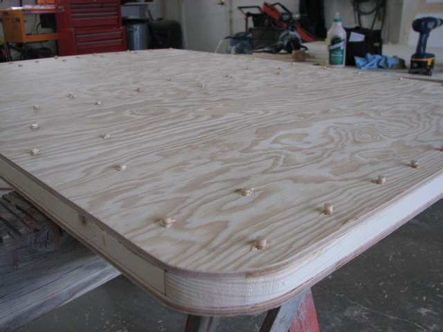

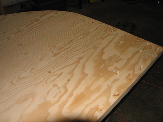

Postby sdave209 » Mon Jan 03, 2011 9:46 pm
Then I glued it and screwed it and skinned the other side
and doweled it
