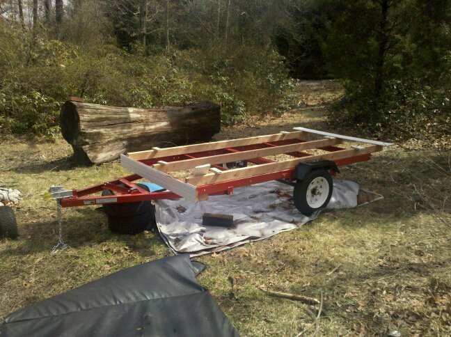

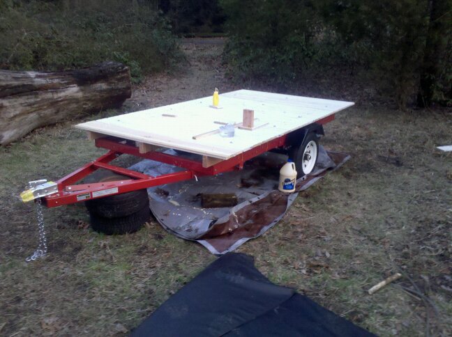

Well after all the time of watching and waiting I have finally started building my trailer.
Because I am active in a medieval reinactment I wanted something that would almost be period I decided to build something vardo'like. Being limited by a max tow weight of a 1000lbs I couldnt go too big. I decided since my car is 63" wide to go with a width of 60". The tongue and groove wood is about 5 1/8th" tall so the sides are going to be about 46" with a center height of about 51". Im doing a side door, not periodly correct but for the size of the trailer and storage use it makes sense to me. I also want an awning off the side to get out of the sun and rain.
Its being built primarily with Paulownia and cedar. I got a real good price on the paulownia from a cedar place that my friend used to deal with.

Postby Miriam C. » Sat Mar 19, 2011 9:50 am
:applause: :thumbsup: You have a real good start on your Vardo. Remember you are not building a tank hauler! ;)
Postby Deryk the Pirate » Sat Mar 19, 2011 11:06 am
Thanks...my friend whose house Im building it at, because he has alot more knowledge and tools then I do, said he usually overbuilds things so when "sh** happens" it can withstand it.... I keep up my mantra "It must weigh less then a 1000 pounds" lol.
I did add an additional support under the floor where I will be directly stepping into the vardo, but where Im gonna be sleeping the weight load will be alot more spread out, and the flooring is 1" (7/8's") cedar tongue and groove flooring.
Im hopeing to be headin back down probably on thursday to start on the side walls... can't wait to get it built so I can start camping in it! :twisted:

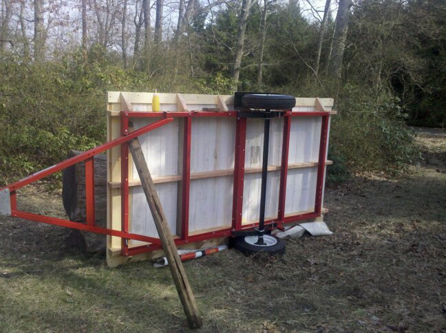

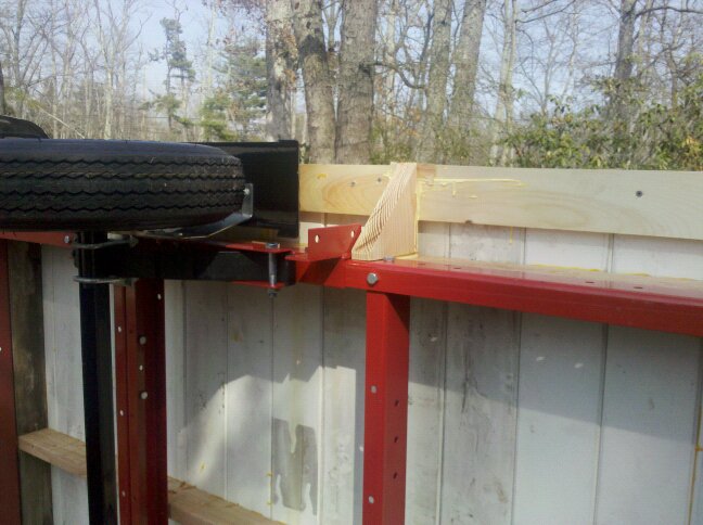

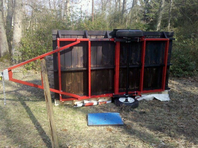

Postby CliffinGA » Sat Mar 19, 2011 1:36 pm
Looks good Deryk, I thought I was only one that just lifted the trailer on its side because I was to big to get under it :lol: :lol: . Mine was that way last weekend while I was primering and painting the new crossmembers on mine. Your moving along!

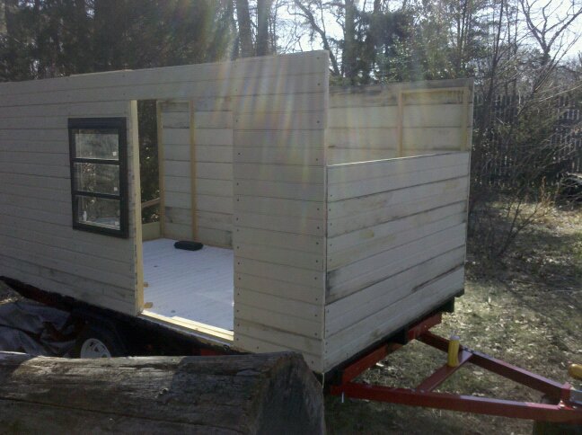

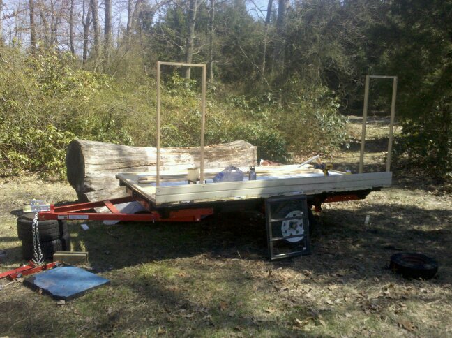

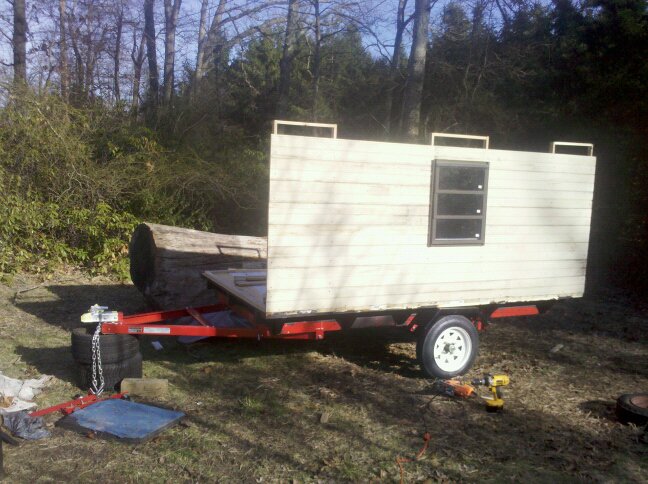

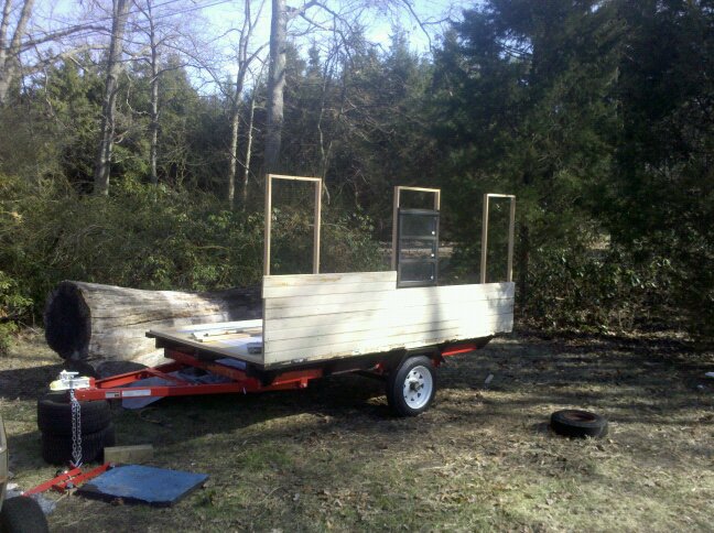

Postby Deryk the Pirate » Sat Mar 26, 2011 10:59 pm

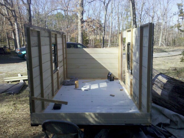

Well started putting up the walls. I got a deal on 2 windows for
$20 dollars each, brand new from a shed store that stopped useing this type of window. Image Image Image Image
Tomorrow is another day!

Postby John T. Hodgen » Mon Mar 28, 2011 7:53 am
Hey Deryk,
Seeing windows on the street side, is your door going to be on the curb side? You'll end up walking around it alot unless you unhitch @ the campground. When I built the "Costta Lotta", I used 1x2's and some 1x4's. It was flimsy til I got the walls done and then it was solid. It still came out weighing around 800#. Tows great but you can feel it behind you. I like Vardos and will watch your unique build.
Til later by the fire--John T. & Linda 8)
John T. Hodgen
Posts: 415
Joined: Thu Jul 24, 2008 5:50 am
Location: Summersville, West Virginia
Postby Deryk the Pirate » Mon Mar 28, 2011 9:41 am
Thanks...Yeah Im doin a curbside door. On a longer vardo the door at the end makes sense. I wanted more storage space. Down the road when I get a car that I can haul more weight with I can add the propane fridge Image Image
My friend suggested on the corners there is an "L" shaped trim piece to lap the joint on the 4 corners and can calk it so water wont blow inside if its raining while i drive down the highway. Hopefully tomorrow I can cut the curved roof pieces and start my roof going up. I made my door frame 27" wide (ran 2 1x2's screwed and glued for extra strength) Im going to add the hurricaine straps for extra strength then cover it with 3/4 foam.
I will figure how Im doin the interior once I take it up the road and weigh it lol. If Im getting too heavy I was thinking of useing a middle eastern'ish tapestry kind of fabric to cover the inside of the vardo and use mouldings tacked in around to hold the fabric in place. If I weigh in where Im guestimateing then I can do 1/8th luan. walls and varnish it.
I think its gonna be fine weight wise, the Paulownia is a light weight wood. http://www.worldpaulownia.com/html/tech.html Based on the sample piece the distributor gave me and what I read on line the weight on the 1"x6"x16' should be 7-9 lbs Im going to be useing 27 of them so the sides and roof will be about 250lbs throw in another 25 lbs for the 20 cedar 1"x2"x8' a gallon of glue and 5 pounds of screws I think I will come in fine under 700lbs. Guess we will see lol
