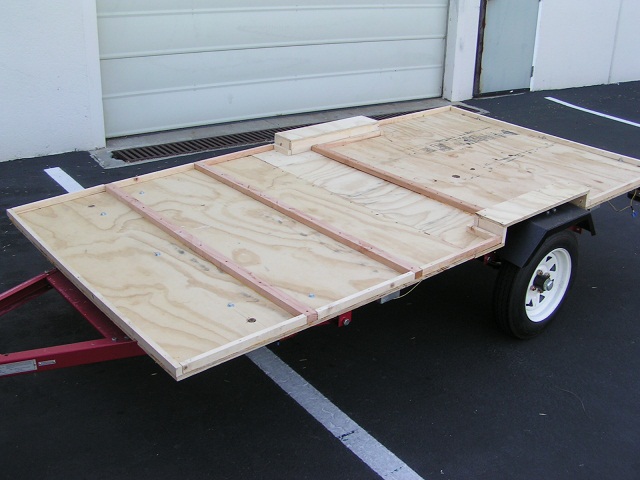

I got a HF trailer back in April to tow my boat on, but decided to build a teardrop instead of a 4th boat last week.
The plan is to make a 5 x 9 tear on the 4 x 8 HF frame (I'm a big guy!)
Day one: I tore the 4 x 8 ply off the frame, turned it sideways and added some more ply to make it 5 x 9.
More tomorrow - Thanks for looking!

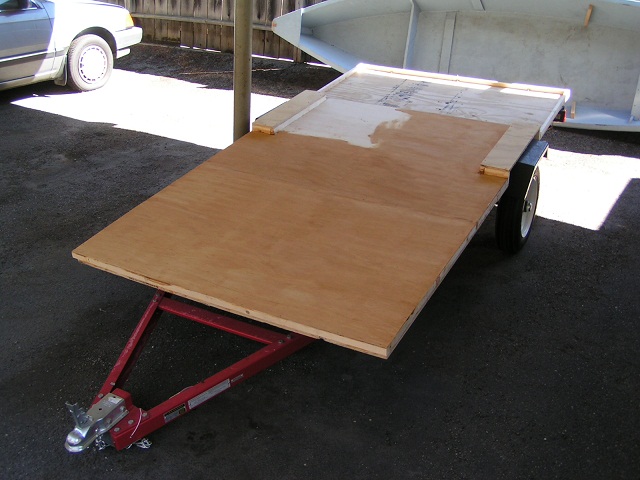

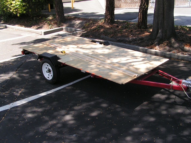

It's called "The Temple of Accumulated Error" because I evidently put the trailer together 1/4 " out of square! Makes It hard to make the ply fit.
Second day, I put a 1" edging around the ply and across it in strategic locations. (wherever I felt like) I also boxed in the wheels.
Third day I filled in with 1" blue foam insulation and covered that with some nice 1/4" ply I found at HD.
Oh yeah, I got carried away and started to stain the deck too.
Not much to look at yet. Should be getting more interesting soon!
That's my 13' rowing skiff in the background - what I originally bought the trailer for - now for sale.

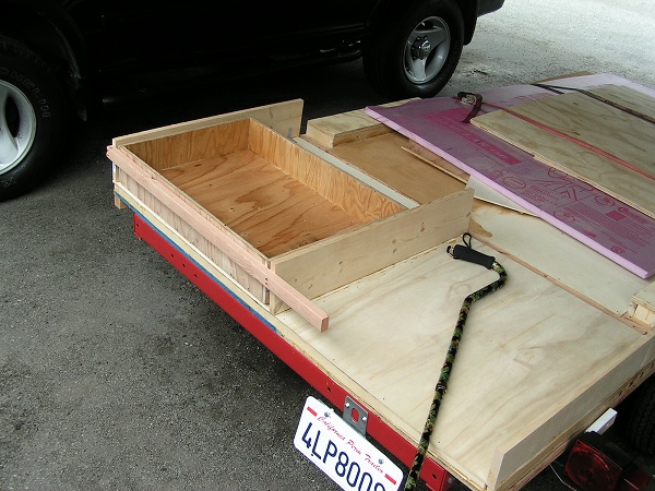

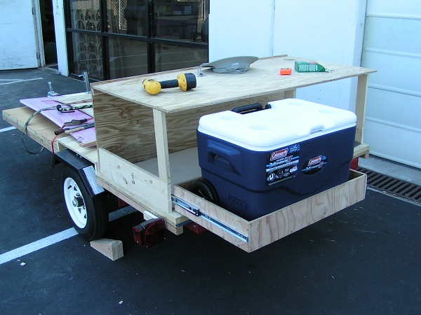

Day 4 - I installed a 2x2 around the bottom edge of my floor to give me something to attach the sides to. Also built a 18x28 drawer to hold my new 5 day cooler.
More accumulated error! I couldn't find a 28 in. full extension slide so I had to turn the drawer sideways and used a 20" slide. Too impatient (and cheap!) to order one delivered.
Day 5 - Installed the drawer, also roughed in a countertop and crossbrace.
Day 6 - I think? Worked on the galley frame for a little while.
