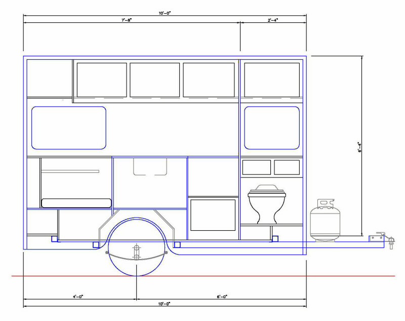

When I first started out I figured that I'd just buy a manufactured trailer from one of big box store outlets and then just whack together a plywood box on top of the chassis something akin to the following sketch.
[img]http://www.tnttt.com/gallery/image.php?image_id=81301
[/img]

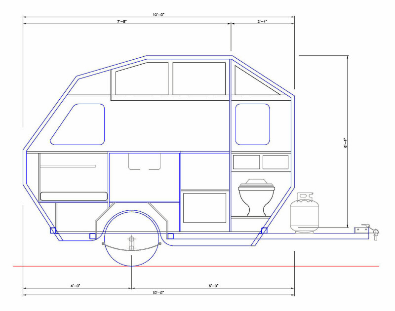

What I needed was basically a small rolling motel room around 10-feet long by 6.5-feet wide and just a little over 6-feet high inside. I typically 'camp' for 3-months at a time and wanted a rig I could leave at a central site and use as a base camp during the summer while I went on day trips in the truck doing some gold prospecting. Unfortunately the preliminary weight estimates on the 'box' design came in around 2600 pounds so I decided to chop off areas where I didn't need the head or elbow room. The next iteration of the plans looked like this:
[/img]

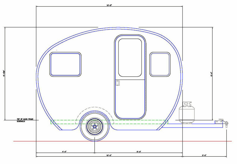

I finally decided to take my original design and blend it together with both the Cruiser and Widget to come up with the more or less final concept as seen in the profile sketch below.
[/img]

Postby bonnie » Mon Oct 10, 2011 8:42 pm
I like that profile! It's fun to watch the designs come together.

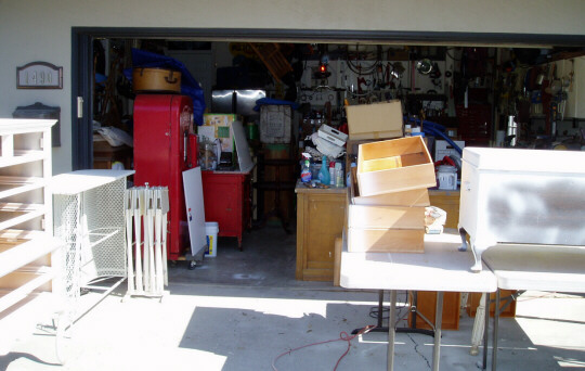

Postby gww25 » Mon Oct 10, 2011 8:51 pm
Thanks Bonnie. It's been an enjoyable experience so far. The design is still being refined and tweaked but I think it's about 90% there. I seriously considered reducing the height and adding a dropped floor but I travel on some pretty rough trails so I need the ground clearance. Besides I don't have any room in the garage for a trailer to begin with as you can see:
[/img]

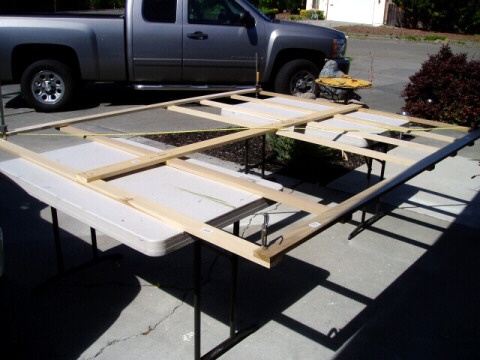

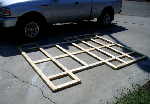

Postby gww25 » Tue Oct 11, 2011 10:44 am
Here's a shot of the floor framing under way. I had originally planned on using 2x2's but couldn't find any good quality material so went this route. It ended up being 15 pounds heavier which I hope to make up for elsewhere
[/img]

Postby gww25 » Tue Oct 11, 2011 10:52 am
Here's a later snapshot of the floor framing assembly about 90% finished.
At this stage of the game all I had for a saw was an old manual miter saw so all of the cuts were actually extremely accurate. The weight of the unit is 65 pounds as shown here. Despite my best efforts the frame is just a tad less than 1/16-inch out of square at one corner but I think I can fix it with a plane.
Image[/img]

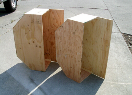

Postby gww25 » Tue Oct 11, 2011 10:55 am
Here's the wheel tubs. These took way to long to build so next time I'll just laminate some semi-cylindrical tubs which will be far easier, lighter and stronger. I sealed these per member suggestions in other threads. The wheel openings aren't cut yet so I left the exterior side long for the time being.
Image[/img]
