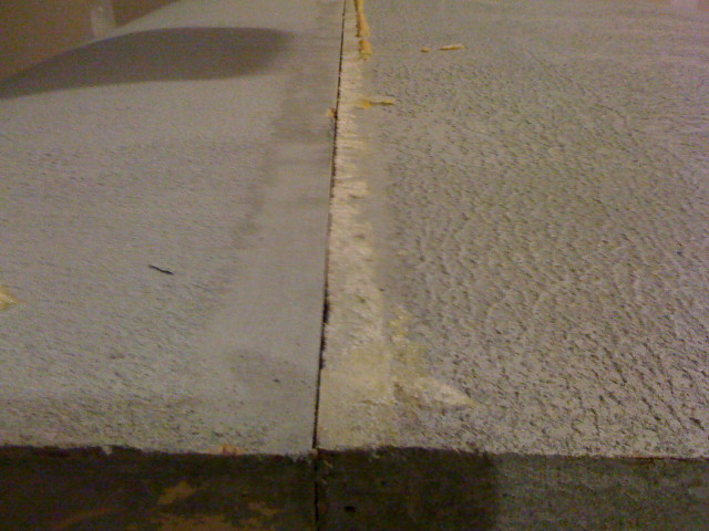

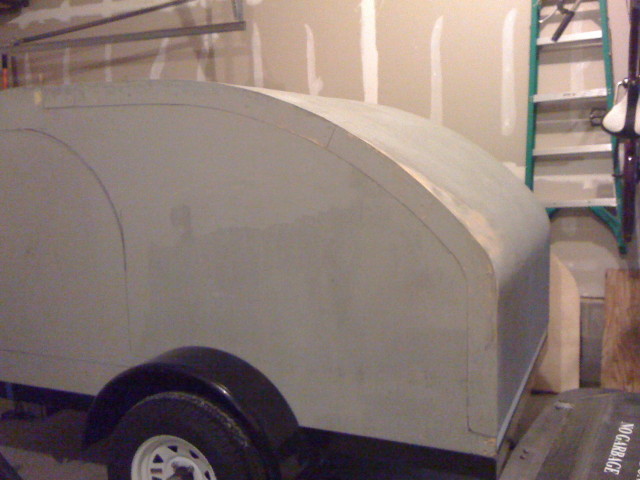

This is a shot after I removed the hinge at the top and clamped the roof in place. The line on the roof is the approximate location of the cut for the hatch. Its about 75 inches from the front, so pretty close to the GB plans. You may also noticed I've scrapped quite a bit of the rough surface from the side. Its a bit of work, but I can scrap it off of the 3/4 plywood successfully. The 1/8 luan on the roof is another story. Its too soft, so I took a shot with a sander, and while it works, it takes a long time and doesn't do as effecitve a job as the scrapping. This evening I'm leaning towards tearing out the luan and redoing the roof.
This shot shows the gap in the roof I would need to fill it I don't start over.

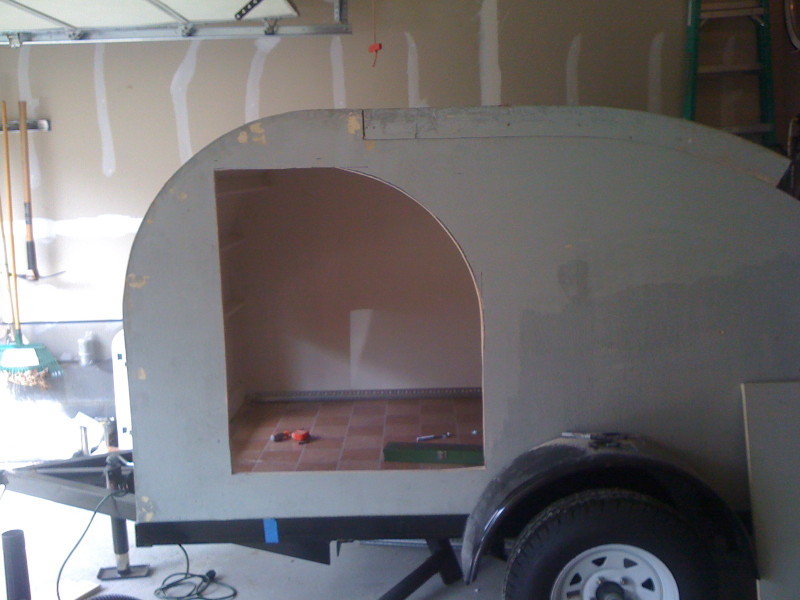

I've also marked where the door fits. The axle is a bit forward vs the GB plans, so I only have 12 inches from the front of the cab to the leading edge of the door. That leaves me the full 30 inch wide door.
I'm hoping I can cut straight. I'll save that for another day when I'm rested and refreshed.
Here's a closer shot of the gap between the wall and the roof section.

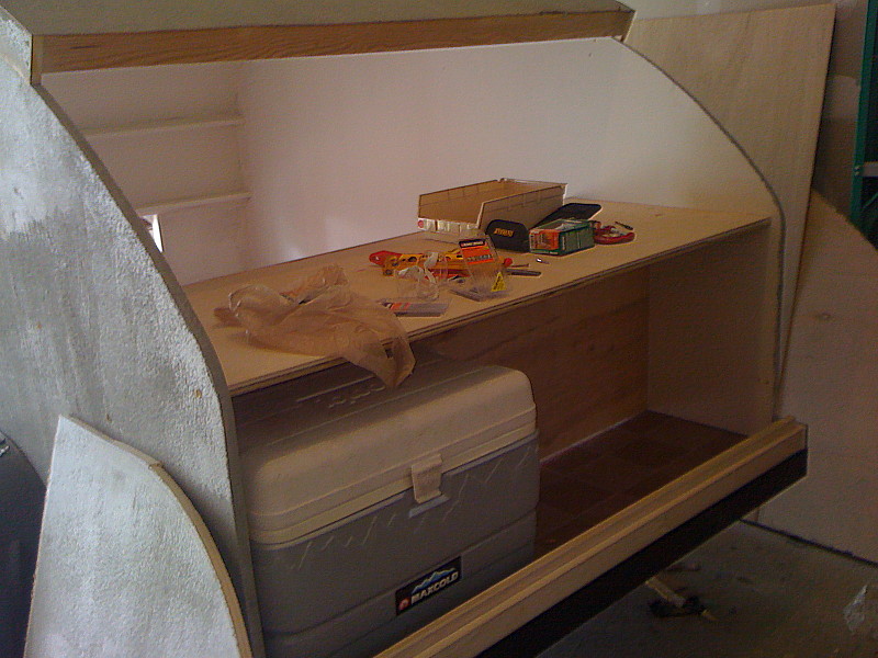

Cut the hatch off, and got a start on the cabinets.
I decided on a 75 inch long bed, that gave me a bit more room for the galley. However, I realized that I really needed to cut the door before I sealed up the back again with the cabinets, so I went for it. It isn't perfect, but its within allowable tolerance I believe.

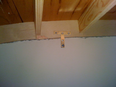

Roof is now permanently attached. Once I mocked up the cabinets, it was clear that the largest part of the gap will be inside the cabinets, and well hidden, so I'm going to use the T brackets inside the cabinets, to keep the front in place, I'm using the spars originally intended to hold the hinge. By screwing through them, it will be a nice strong attachment and behind the headliner. I was going to post pics, but I'm getting an error that I've exceeded my quota, so I'll find somewhere I can post them.
