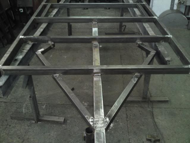

I did chassis

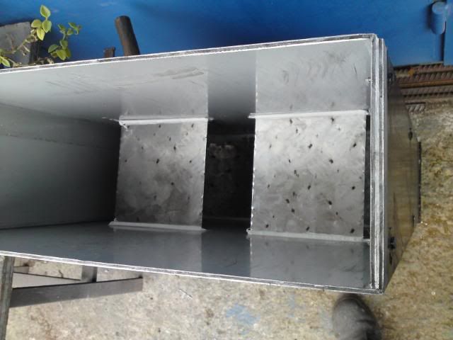

Water tank made ​​of composite panel (85 liters)
I made the baffle into the (breakwater)

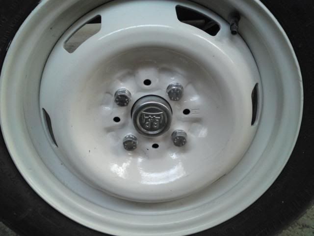

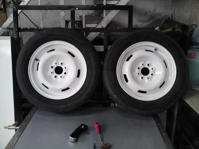

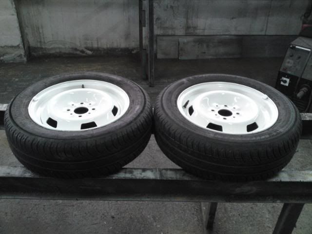

14-inch wheels from the vehicle out of fiat
A little cleaning and paint

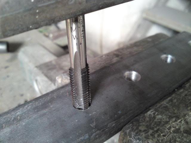

I bolted the buffers
took me so long to
I set foot place in the balance
do not want to drill holes after galvanizing
