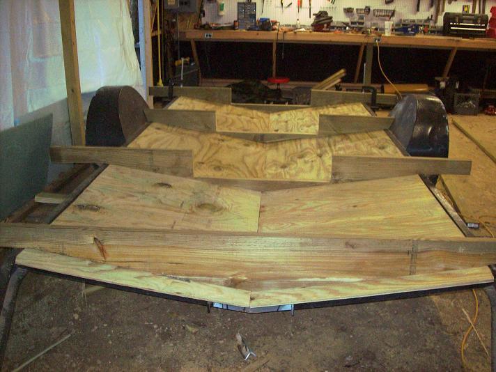

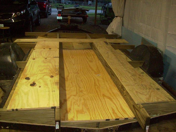

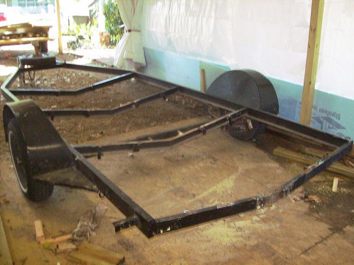

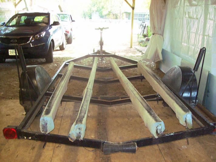

Here's the platform - a used boat trailer 18-1/2' long, 6' wide between the fender bottoms, 8' overall outside width. It has a 3500# straight axle and 15" wheels: I had previously planned on using a pop-up frame I already have, same size bed but much shorter tongue. The boat trailer is better suited for the height issues and balance.
Stripped of bunks, brackets, rollers, winch, etc:

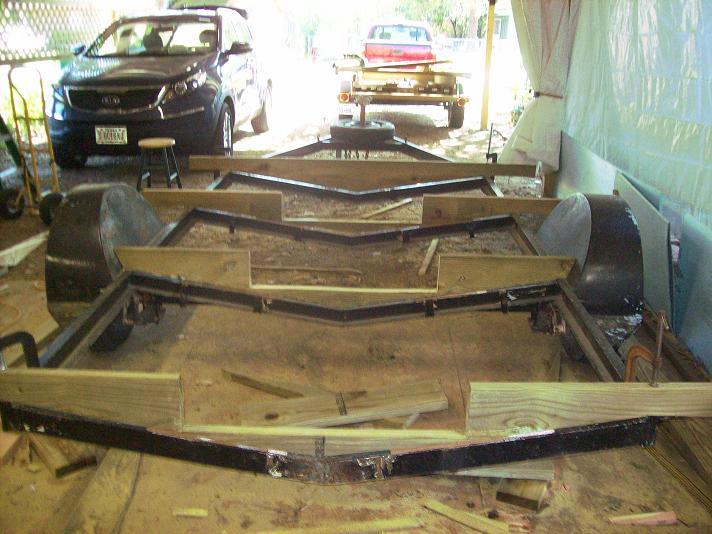

Framing:

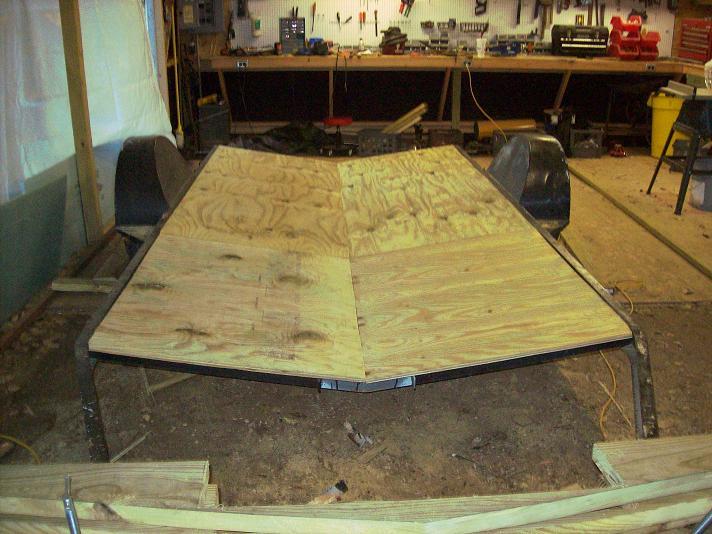

Sub-Floor:
Floor framing:

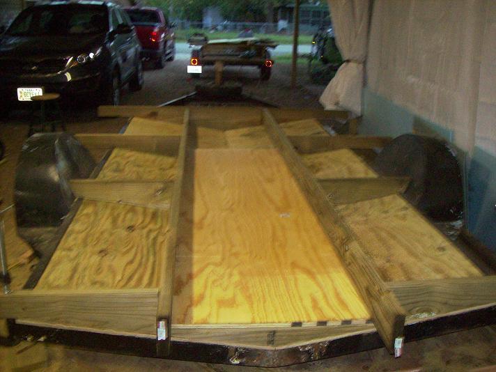

Center dropped walkway 28" wide - will extend full length of inside:
Drop frame:
Decking (mocked up for photo) will be approximately 27 to 30" wide on each side except wheel well cut-outs. The decking will sit between the wood cross members leaving about 2" for rigid foam insulation. Interior partitions will rest on the cross members.
The shower / toilet will be at the left rear. The holding tanks will require a cut-out in the subfloor.

I'm satisfied with the layout - I did extend the deck length to 13-1/2' to provide for a front well to receive the murphy bed when folded.
I pulled all the mocked-up members off and attached everything permanently.
Additional blocking between the steel crossmembers of the trailer: This shot was before I primed and repainted all the steel trailer frame. I had spot-primed where I cut-off the excess brackets and drilled holes.
Sub-floor and underlayment: I'm not a fan of sealing the underside of the floor. To me it creates a pan that will hold any leakage or overflow. Even with provisions for drainage it does not allow the material to dry naturally. I have used pressure treated lumber on the subfloor and framing. I also drilled a series of 3/4" drain holes along the bottom of the v. The underlayment is EDPM backed with fibreglass. Home Depot sells it as "Lay-Flat" for about $12 a square. It is not the same as the more expensive synthetic underlayment material. It is not initially self-adhesive like the ice dam membrane or flashing but will stick to the decking after a couple of days in the sun or heating with a blow-dryer. It will not curl like normal felt, is very resistant to tearing, and can withstand 6 months exposure on a roof application before the shingles are installed.
The underlayment butts at the bottom of the v with about a 1/4" gap, With my planned shower, toilet, sink, refirgerator, air conditioner, etc., I do not want to restrict any spillage or leakage. The subfloor will extend outside the steel frame rails another 8-10" when I finalize the width and that will also be covered with the underlayment.
The subfloor crossmembers were attached with 3/8" lag bolts, 6" and 8" long, 4 per each steel crossmember:
Additional support for the drop-down floor walkway: The drop ends 2 foot before the full deck. The murphy bed hinge mechanism will atttach to the front un-notched crossmember. The floor beyond will be about 2" higher than the subfloor , level, and provide a well for the bed when folded up.
3/4" open cell styrofoam: I've got a bunch of this in the barn. It will be layered 1-1/2" to 3-1/2" thick depending on the subfloor depth. The open cell will facilitate drainage if needed.
Drop down floor reinstalled: It is 3/4" plywood, 31" wide and 11-1/2' long. I left it overhang at the back for now to make sure it extends through the exterior wall to support the door threshold. That part will be flashed will metal for additional safeguard if the door is open in the rain. The left rear will be the shower/toilet and I will install the holding tanks and shower pan before insulating there.

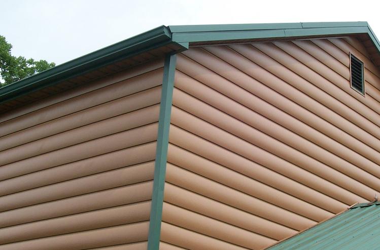

M C Toyer wrote:... 1/4" paneling, 2" insulation, 1/2" sheathing, 1-1/4 log siding for a total of ...
That adds up to 4 inches, by my math, not 3-1/2. :thinking: Hope that doesn't screw you up too much.
The wall build up sounds very heavy to me. Can the log siding members double as exterior structure if you use a thin moisture barrier in place of the 1/2 sheathing? I realize that you are going for the look of the log siding, but wonder if it can be planed down lighter. Can you tell us more about the siding, or did I miss that part somewhere? …or is it a light weight thing like vinyl siding? (I must have missed something. :? )
Even if your TV can handle the extra weight, excess weight is just that, excess.

See it now (again). Rolled steel siding. (doh on me!)
Yeah, I think if it were me, I would try to shed (pun intended in a good natured manner) some weight.

KCStudly wrote:The wall build up sounds very heavy to me. Can the log siding members double as exterior structure if you use a thin moisture barrier in place of the 1/2 sheathing? Even if your TV can handle the extra weight, excess weight is just that, excess.
The front of the trailer will be higher than the tow vehicle and essentially flat. The sheathing serves the same purpose as in standard construction, to make the stick frame rigid. I could cut in a diagonal brace for that purpose, but: The siding has a contured foam backer to maintain the shape which requires a flat solid substrate. The siding is attached to the studs through the sheathing with truss head screws but some of the trim around the windows will not lay directly on a stud therefore you need the sheathing to hold those screws.
The preformed holes for attaching the siding are a horizontal slot about 3/4" wide and slighty larger than the screw shaft. 1/8" head space is left so the siding can expand and contract with temperature changes and flexing of the trailer frame and not buckle. There will be "tyvek" or similar house wrap membrane over the sheathing.

'Hope they are useful,
I agree on that second Alma pic. I just assumed they had used
another plywood sheet that went on those 2x4 cross pieces that
was now missing.
Cheers,
Norm/mezmo
