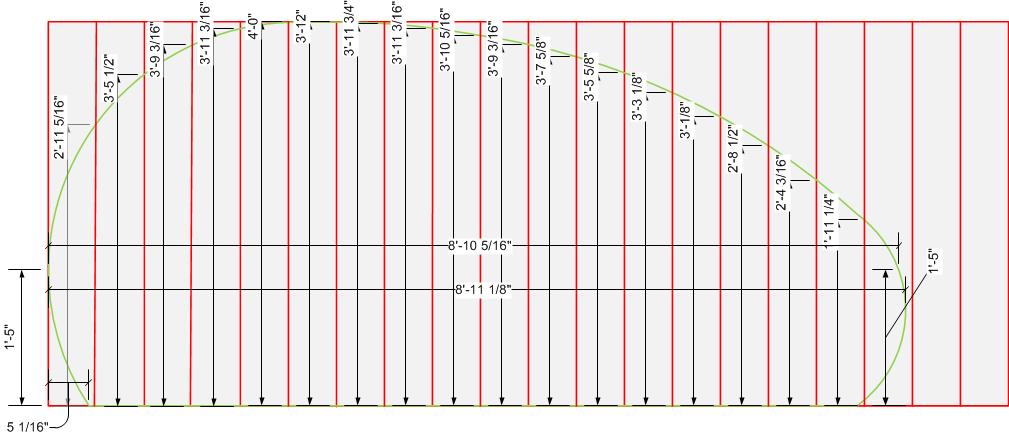

I thought some might be interested in my lofting diagram. I know it is used for building boats but I thought it would work for laying out a tear profile.
The red lines are every 6 inches. I worked with two 10 foot by 4 foot pieces of plywood. Nails were gently tapped in at the intersection of red and green lines.
The black lines are simply measurement lines. Notice the first nail was placed 2'-11 5/16"
Its easy to
Then I took a bendable piece of wood to follow the curves on the nails and bingo used a pencil to trace the profile.
