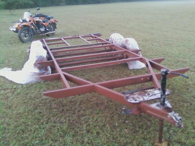

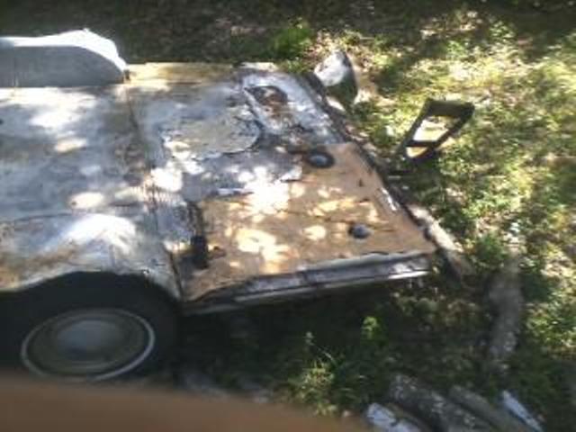

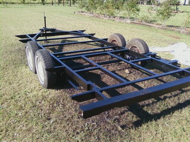

It all started with wanting a simple camper for the hunting club. My son(s) and I go hunting almost every weekend from Mid Oct through late Jan. We wanted to keep warm and have a place to store stuff that was more secure than a tent and would have a shower and maybe a wood stove for heat.
we started looking for a camper and were ofter beat to the buy by other hunters. We were disgusted with the junk that people whould put on the market, thining that by puting the words "hunters special" it would be worth buying. What junk! and smelly too.
so we decided it would be better to build on an existing frame.
we found this frame on craigslist for about $220.
1 junky.jpg (40.92 KiB) Viewed 1602 times
3 nasty floor.jpg (28.03 KiB) Viewed 1602 times

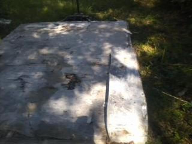

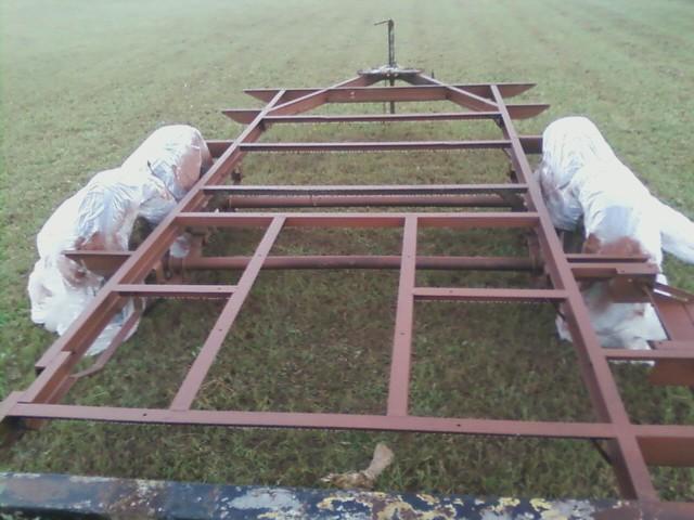

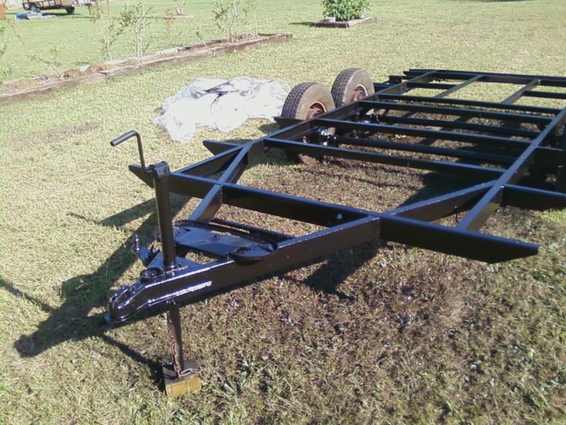

we removed all the rotten ply and subfloor and ground off all the rust.
we then put on a coat of primer
5 primed rear.jpg (50.82 KiB) Viewed 1601 times
6 primed front.jpg (52.28 KiB) Viewed 1601 times

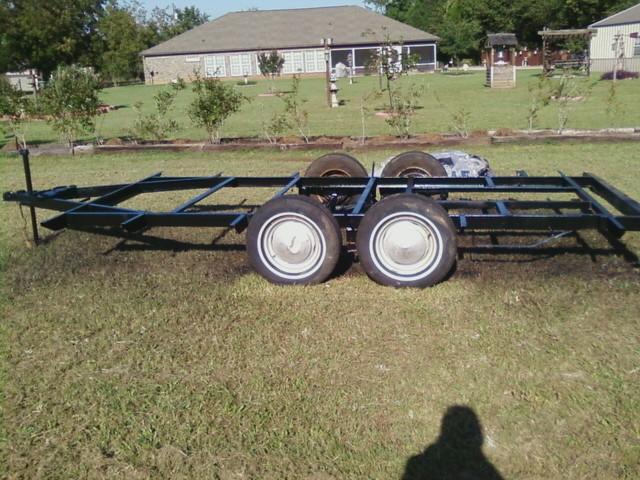

after letting the primer dry overnight, we put on a coat of black gloss paint.
8 side black.jpg (72.4 KiB) Viewed 1601 times
7 rear black.jpg (82.41 KiB) Viewed 1601 times
9 black frame.jpg (130.73 KiB) Viewed 1601 times

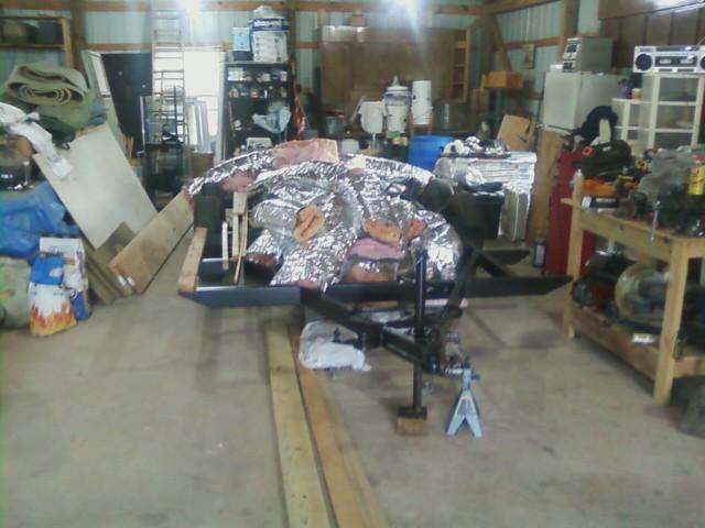

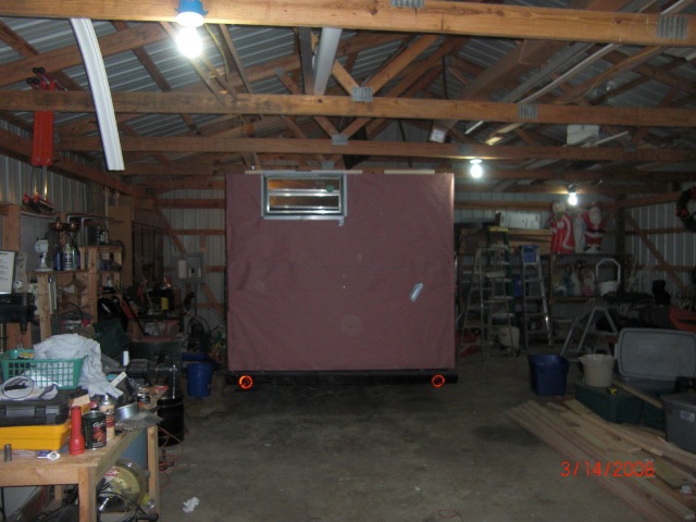

once the paint dried, i moved it inside to start leveling and collecting materials.
The are still building in my sons neighborhood, so he got permission to collect the discarded mylar duct from a new house.
10 barn.jpg (47.04 KiB) Viewed 1601 times

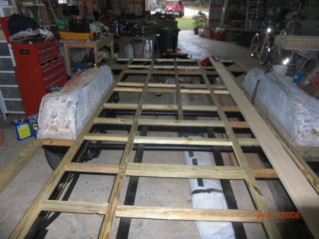

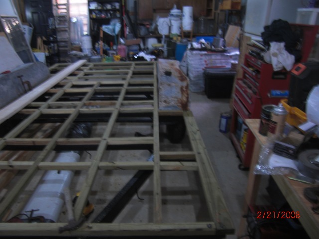

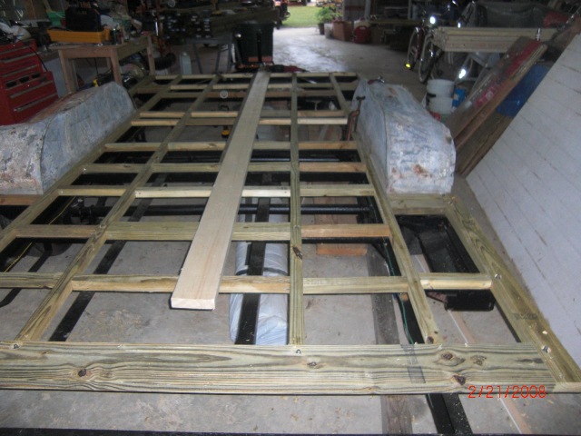

the original subfloor was just plane untreated wood, so we wanted this to last for a long time. We went with pressure treated and bolted it down.
12 sub floor.JPG (141.09 KiB) Viewed 1601 times
11 subfloor frm.JPG (115.4 KiB) Viewed 1601 times
11 subfloor frame.JPG (138.22 KiB) Viewed 1601 times

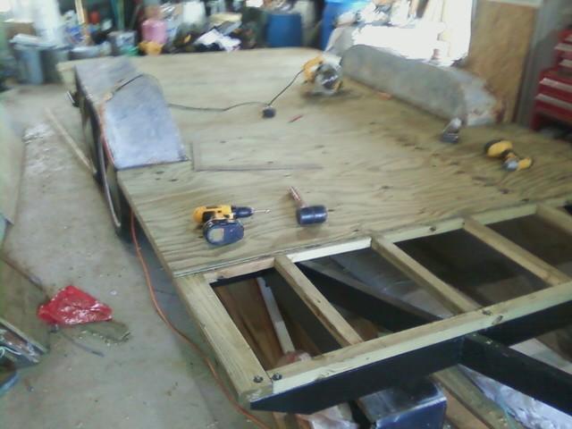

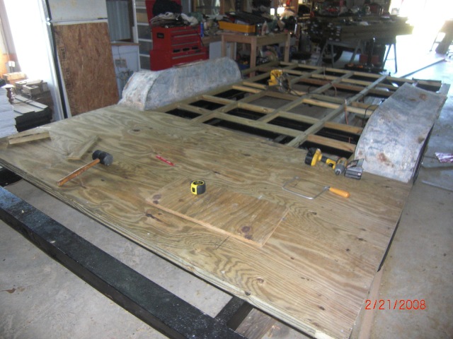

Postby planzman » Fri Nov 02, 2012 8:00 am

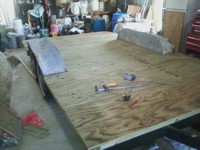

the original trailer had a holding tank, which we discarded and framed over the space.
we wanted a good weather proof floor, so we went with half inch pressure treated ply.
16 floor.jpg (46.19 KiB) Viewed 1601 times
14 half floor.jpg (43.79 KiB) Viewed 1601 times
13 ply.JPG (138.88 KiB) Viewed 1601 times

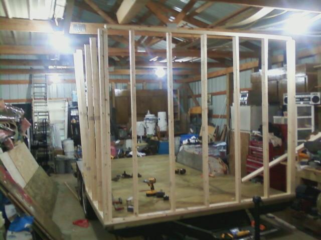

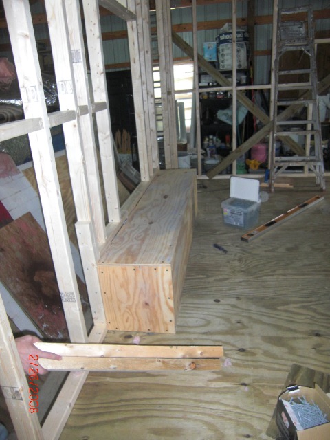

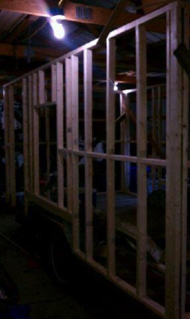

Postby planzman » Fri Nov 02, 2012 8:03 am

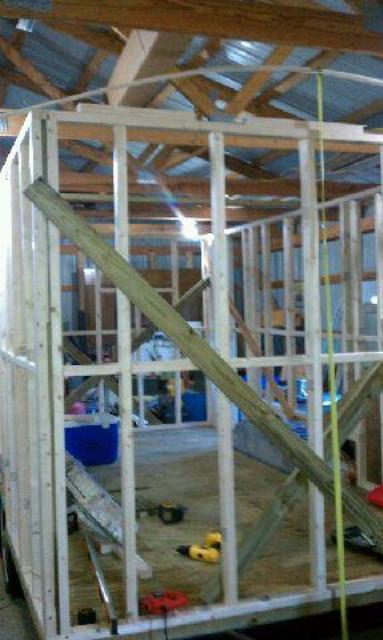

started framing, which if done by yourself is sorta like juggling eggs. :x
17 building camper.jpg (49.75 KiB) Viewed 1601 times
so my son came in and i got him to help me level and get every thing plumb
20 cross frame support.jpg (39.39 KiB) Viewed 1601 times
19 door side frame.jpg (24.59 KiB) Viewed 1601 times

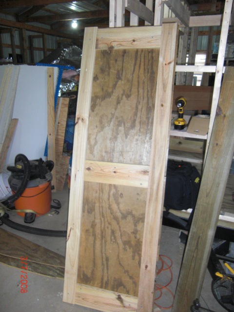

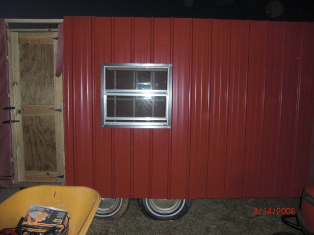

and i built a door from some left over 3/4 inch pressure treated ply
26 wells.JPG (136.18 KiB) Viewed 1600 times

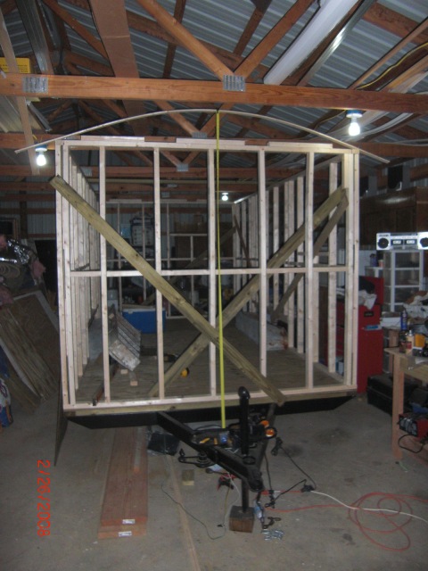

so it was time to start thinking how to bild the roof and how tall it was going to be. My cieling is higher than the barn door. :shock:

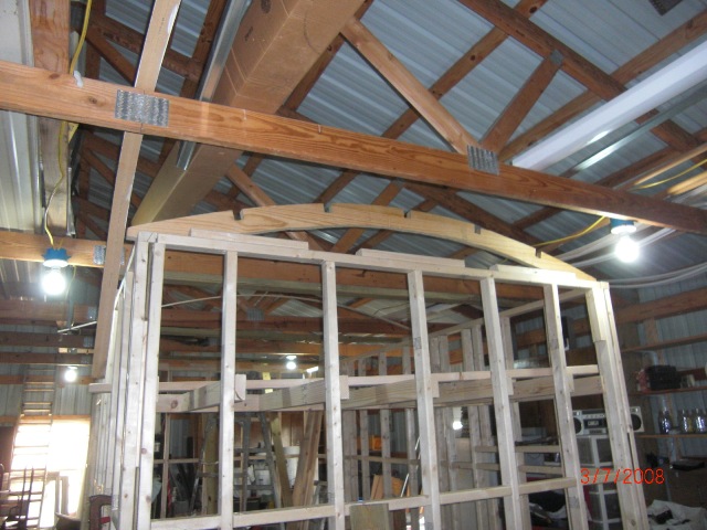

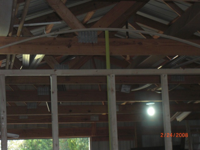

so I now knew how long and tall the arch would be, it was time to make one.
28 measureing height.JPG (100.66 KiB) Viewed 1599 times
here is the first protype in place.
the notchs on tope are for perlons running fore to aft.

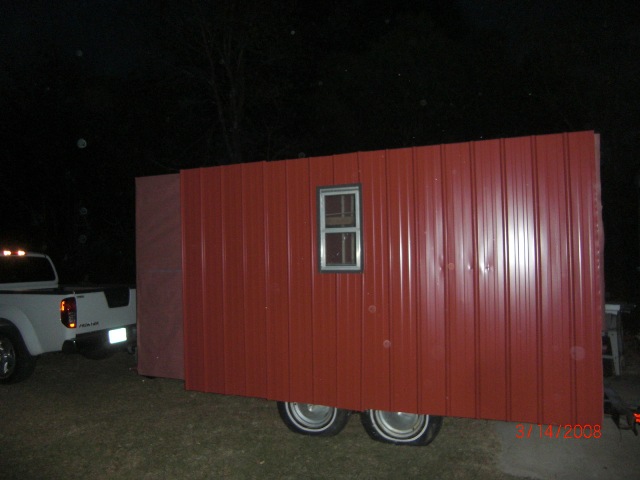

first we covered with a house wrap for moister control.
once i got both the front and back covered with metal, i an out of room, it had to go....outside that is.
32 at the door.JPG (127.25 KiB) Viewed 1597 times
31 downsize (11).jpg (63.51 KiB) Viewed 1597 times

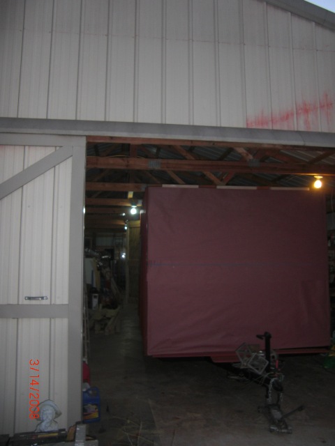

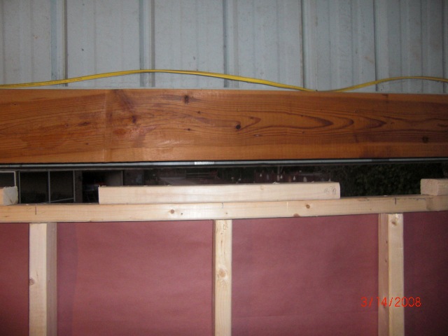

my door has a header that is lower than the cieling, so i had to let the air out of the tires to ensure it would clear
33 tight.JPG (98.98 KiB) Viewed 1594 times
33 starting out.JPG (81.34 KiB) Viewed 1594 times
34 finaly out.JPG (107.64 KiB) Viewed 1594 times

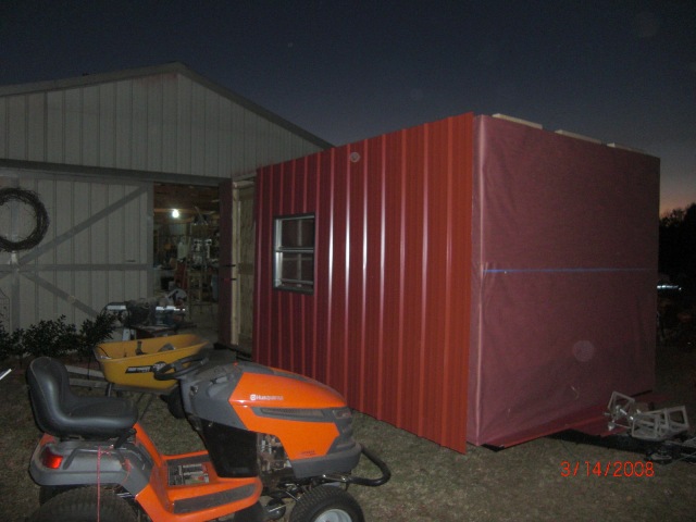

Postby planzman » Fri Nov 02, 2012 9:31 am
so now it will rest overnight so i can start putting on end walls
37 outside first time.JPG (94.95 KiB) Viewed 1591 times
36 outside for the night.JPG (105.23 KiB) Viewed 1591 times

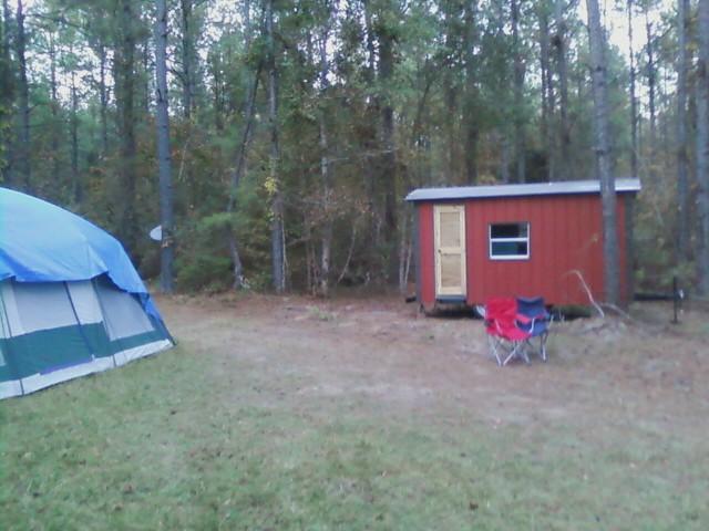

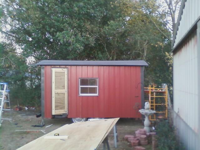

Postby planzman » Tue Nov 13, 2012 8:13 am
everything went real fast last couple of days, so not a lot of pics of the progression.
here is where we finished it up enough to be road worthy (we hope)
and where it wound up at the deer club
cabin in the woods.jpg (51.1 KiB) Viewed 1484 times

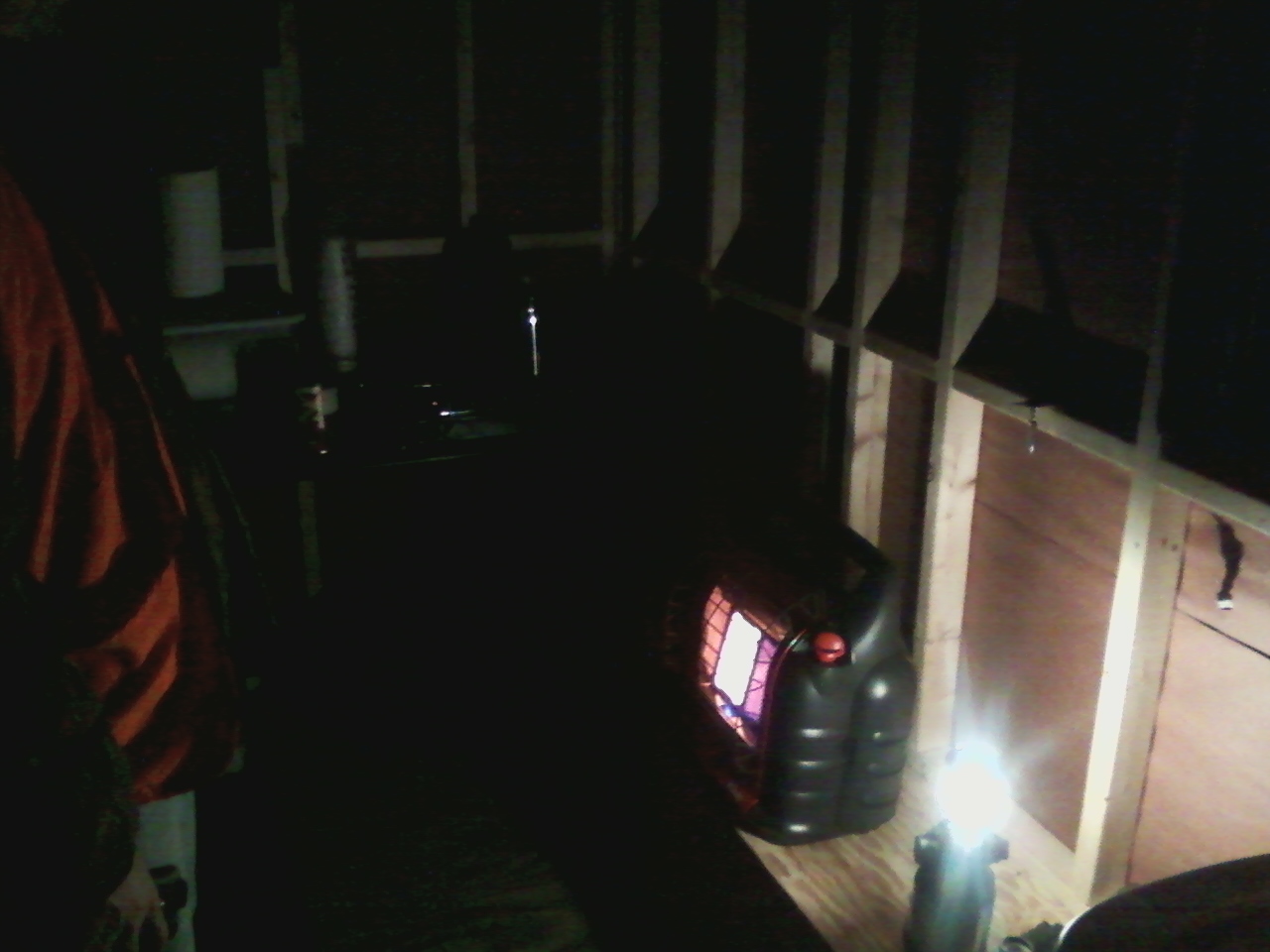

we have some more work to do inside, but we do have heat and some light
light and heat.jpg (238.27 KiB) Viewed 1484 times
