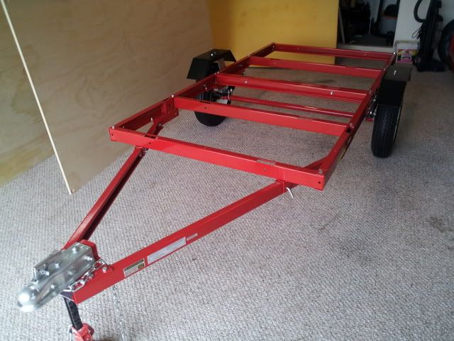

So I got my trailer from HF on sale and with 25% off on New Years day. I got the 1780 lb rated one I figured for $282.00 with tax what a deal.
Here is it assembled..

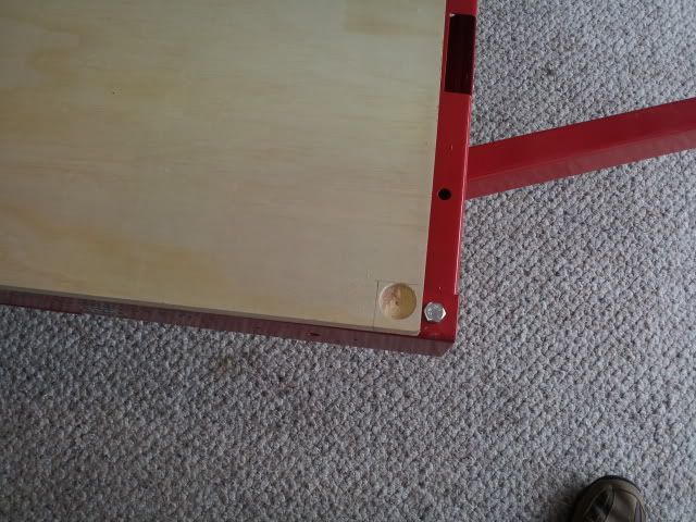

I found a pretty 23/32" 10 ply sanded pine plywood with poplar core and exterior / high humidity glue for $33.00 a sheet and 5 of those sheets followed me home today.
Here is the plywood with holes contersunk for allow for the trailer bolts..

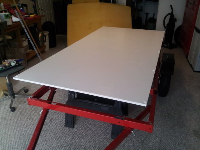

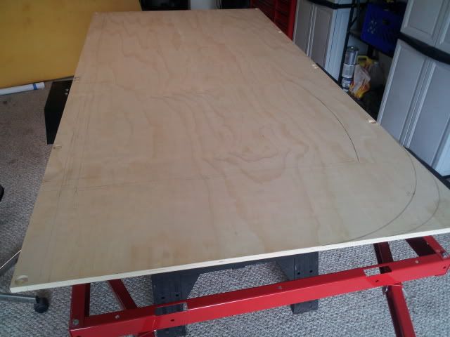

Then after getting those drilled I wanted to see what the plans for the Generic Ben Roy looked like drawn out so I measured everything out and drew all my lines on what will end up being the underside of the camper floor. I like the results and since I was going to coat this side to protect it nobody will see my mistakes.
Not sure you can see all the lines but they are there. Somethings about the different radiuses make more sense now.
Then I got 2 coats of just regular house paint on it and now it is sitting over night waiting for me to pickup a roll of butyl tape to put down on the top inside edge of the trailer to stop moisture intrusion after the build is complete.

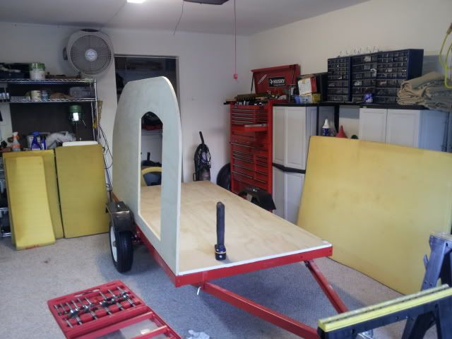

Had some time today and got the first panel drawn and cut out.
Here's the first panel installed. More to come soon.....

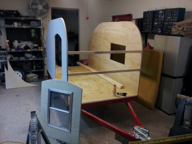

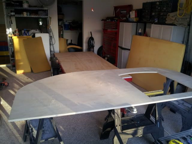

Postby fishfreek » Mon Jan 21, 2013 8:23 pm
After a really busy week at work I finally had a chance this afternoon to make a little more progress on my build
Got the second wall cut and the door trimmed to fit and all the holes cut for windows.

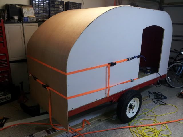

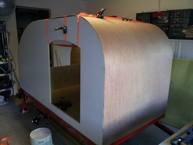

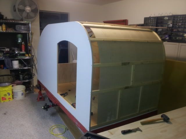

Postby fishfreek » Sun Jan 27, 2013 8:31 pm

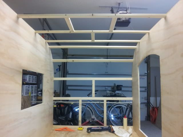

Here's a couple more pics. This thing is actually starting to look like something
From the front. I got the ceiling boards painted and most of them installed. Just need to trim the last one down a bit to fit.
Found these at Lowes on clearance. Pre primed and 8' long, 14sf for $2.92 I love deals.

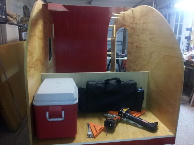

From the back looking in. Test fitting the cooler and a couple other things before putting in the counter top.
Sorry about the crappy cell phone pics. That's all I got.

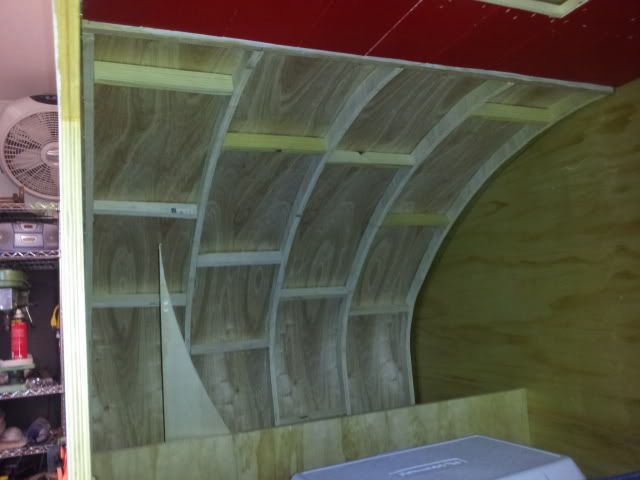

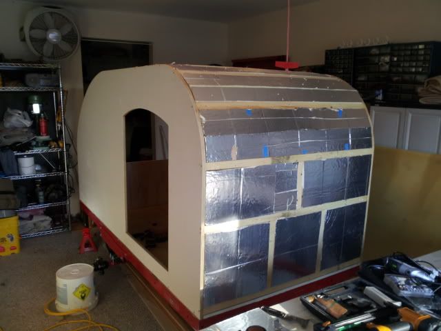

Postby fishfreek » Wed Feb 06, 2013 5:51 am
Had a little more time the last couple days.
Added insulation
Went after work Tuesday and picked up a sheet of what HD calls 5mm underlayment. Not real sure what woods it is made of but it went on NICE... Three straps, my pneumatic stapler and about an hour of time and I have a top.
Today I will seal the top and start my rear hatch. This has been one of the coolest builds I have done. Can't wait to start using it.
