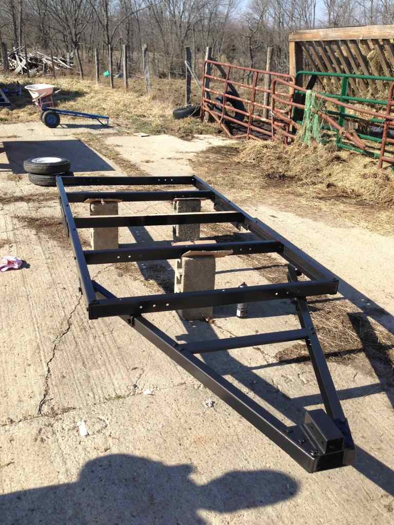

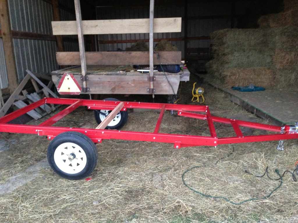

Well I guess I've started (contrary to what my wife may think). I'm using the Kuffel Creek Cubby plans on a HF utility trailer frame. How many red trailers can you look at but here it is anyway. I'll be painting it black.

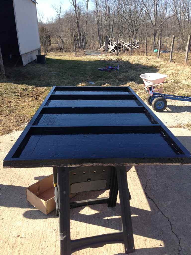

Well I took advantage of today's beautiful sunny 50 degree weather to do some work on my TD. Yesterday I built the floor frame and attached the plywood floor. I asked the guy at the lumber yard for acx plywood and I didn't realize until I got home that he sold me fire retardand plywood. I hope it doesn't emit fumes. I went ahead and used it anyway. Today I coated the underside of the floor with asphalt roofing coating.
I know everyone said this stuff was nasty but dang I didn't realize it would be this nasty. How long does it take for this goop to dry? I also went ahead and sanded and painted my trailer rustoleum hammered black. I think it turned out pretty good. All of it has two coats with some areas having three.
Now to let all this dry and continue on.

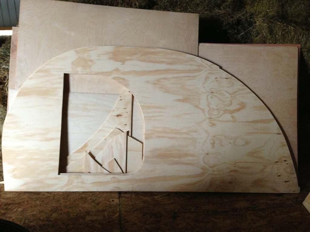

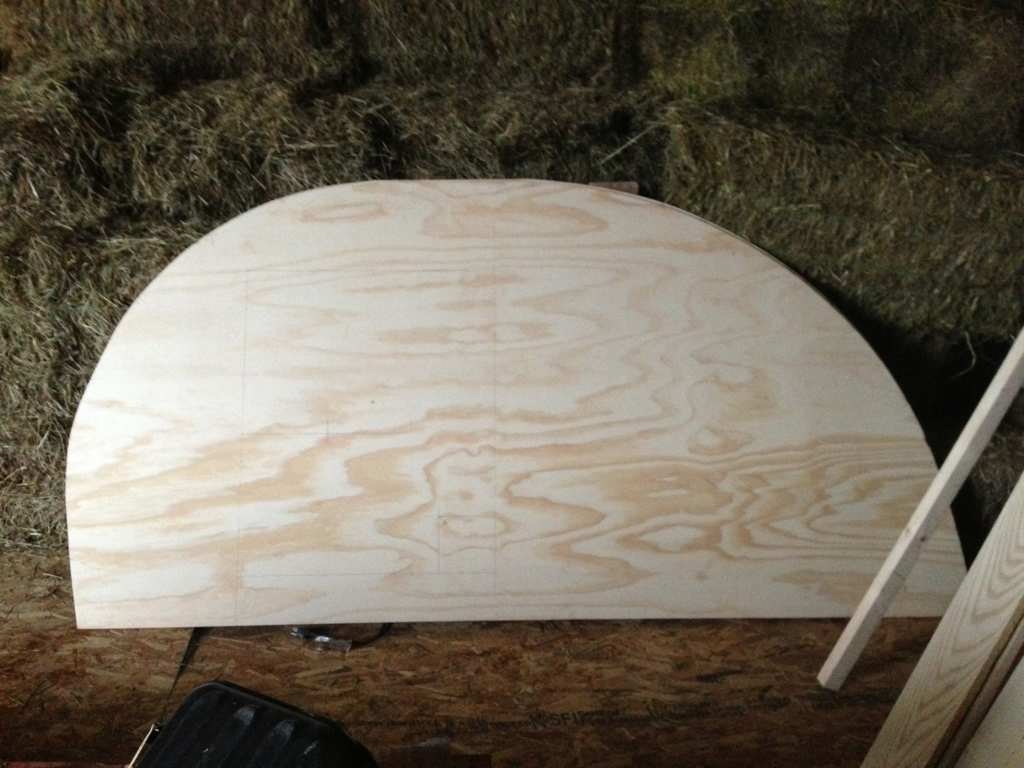

Well, despite the fact that it was only 30 degrees yesterday I was able to get a little done on the TD. I got my side profiles laid out and cut. I laid the first one out and cut it then I clamped the second sheet of plywood to the first one and used a template bit in my new router to cut the second one out. It was the first time Ive used a router and it was a little intimidating. Somehow I ended up taking too deep of a cut on a little section but luckily it was where I had to remove extra material anyway for the hatch seal.

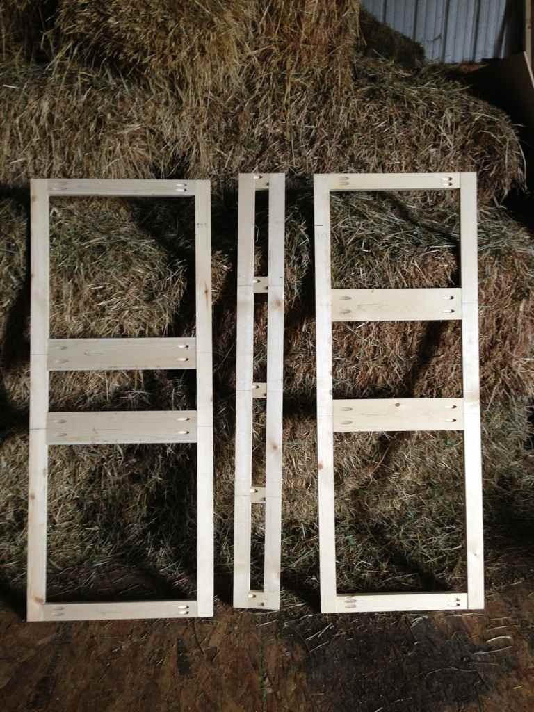

I was also able to get my doors laid out and cut and I got my bulkhead walls built. I used my kregg pocket hole jig for the walls. I love that pocket hole jig.
It's supposed to be in the upper 50's this weekend so hopefully I will get a lot accomplished.

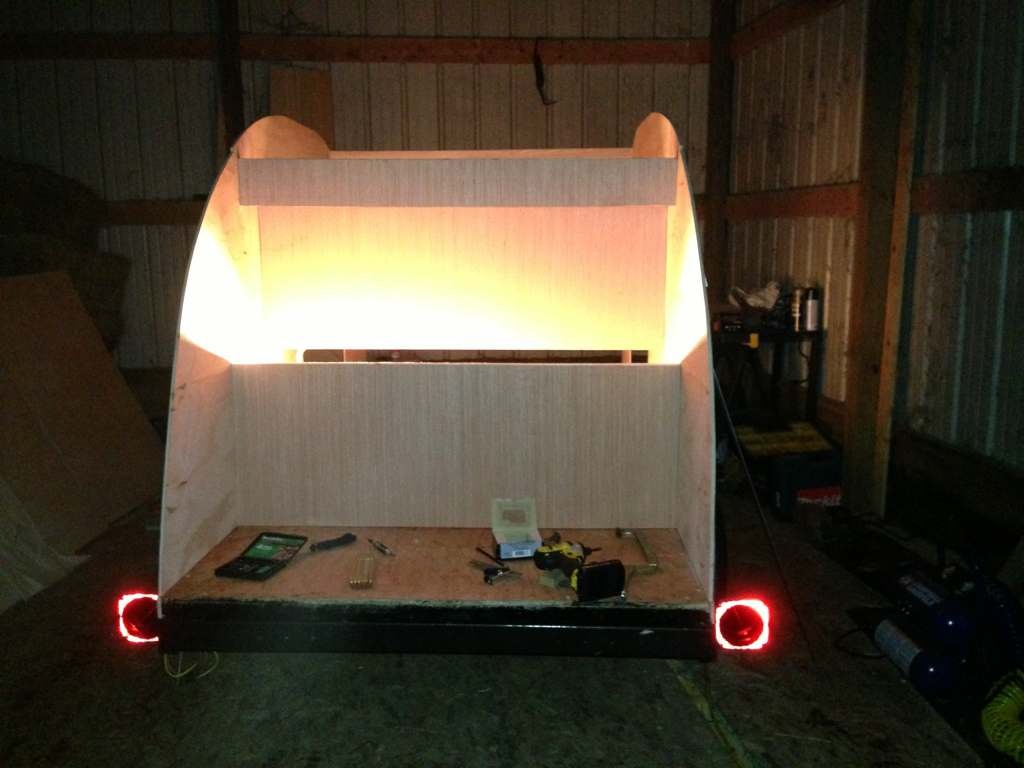

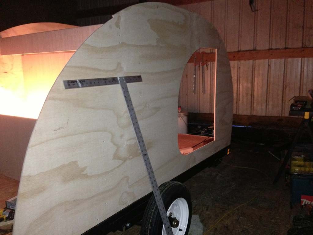

I was able to get my walls up and my bulkhead walls in yesterday. No time to work today but I plan on doing some more work tomorrow. More pics to come. ( sorry about the dark pics, it was getting dark when I finished )
