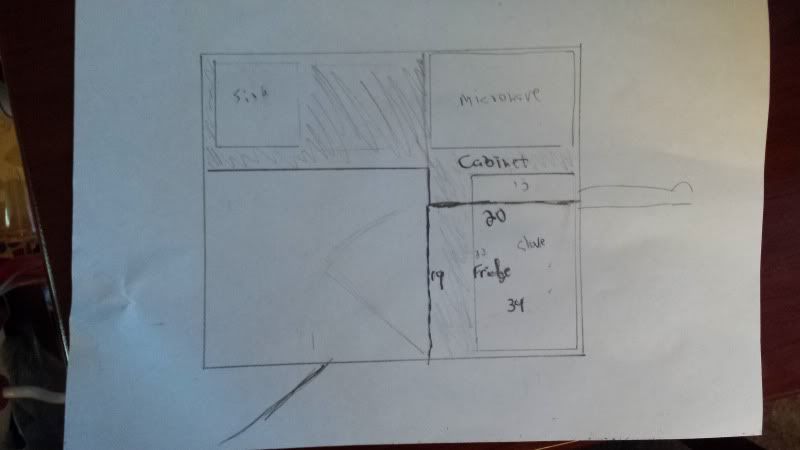

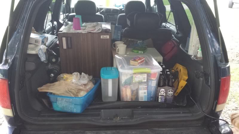

this all started with a sketch while i was bored at work. although the idea had been going around in my head for a while, i couldn't quite compact the design enough to make it cost effective. we like to tent camp, but i like to be a little between wiping your butt with leaves, and the $500,000 rv with a big screen and satellite television.

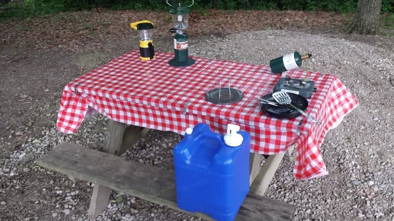

this is the general idea of our current camping endeavors.
so we have our "kitchen" in the back of my mothers blazer (she so graciously lets us borrow it on occasion), and do most of the cooking on the picnic table. inside the tent we have a power strip for cell phone chargers, a fan, and a laptop to watch a movie on at night, or in case of rain. (and my hillbilly air conditioner, which ill post in another tread)

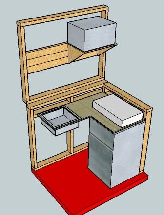

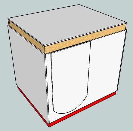

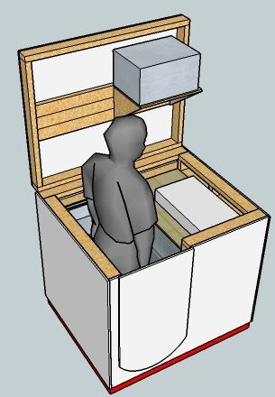

so the sketch becomes a 3d model thanks to sketchup (an absolutely awesome program btw)
so underneath the counter is a mini fridge with seperate freezer, above that represents the camp stove, on the shelf is a microwave, and the thing that looks like a sink, is a sink (go figure) the shelf will come off and sit on the floor where i will stand for towing and storage, and the area to the left of the fridge will be cabinet space for foodstuffs, i have some other ideas floating around for cabinets attached to the lid, but i kinda wing it, hence why the sketchup drawing looks like its unfinished. i got antsy and had to start my build.

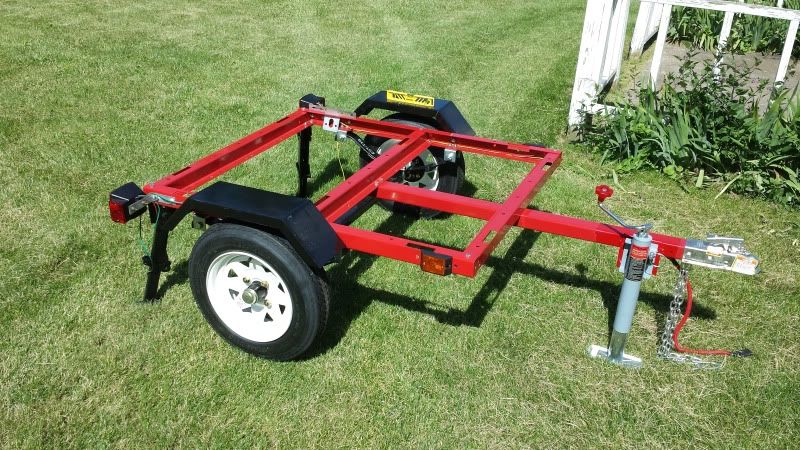

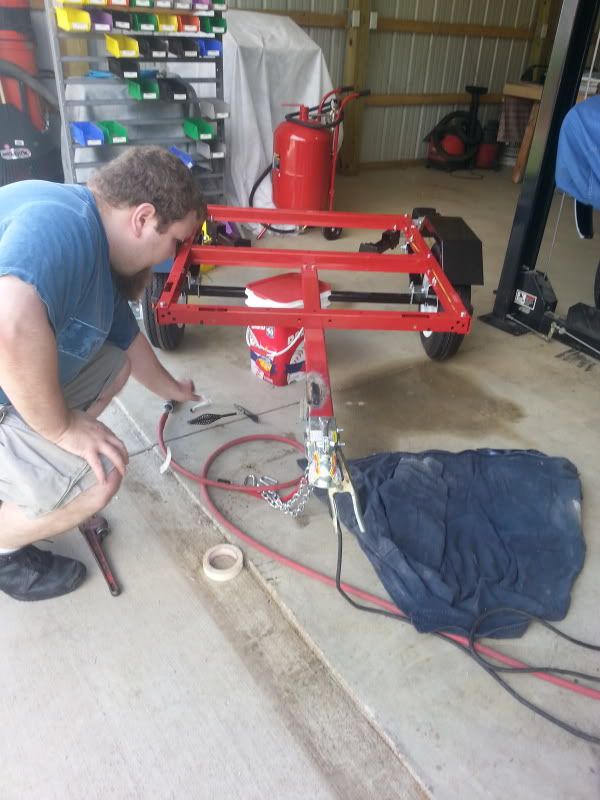

so heres my son and i assembling the frame of the trailer from harbor freight (note the toy plastic hammer, and ignore the mess in the background :oops: )

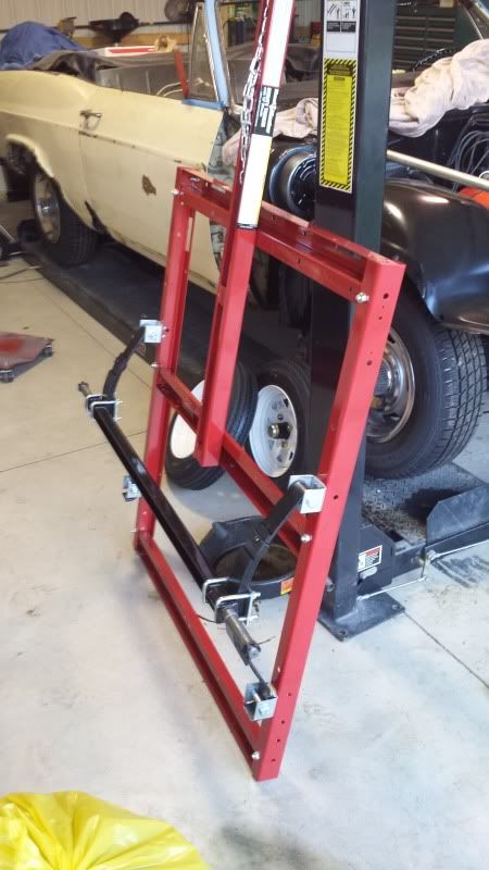

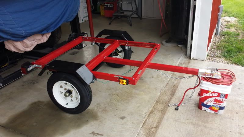

got the suspension on
and there she is.

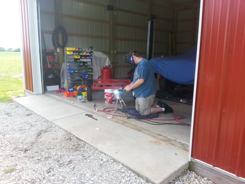

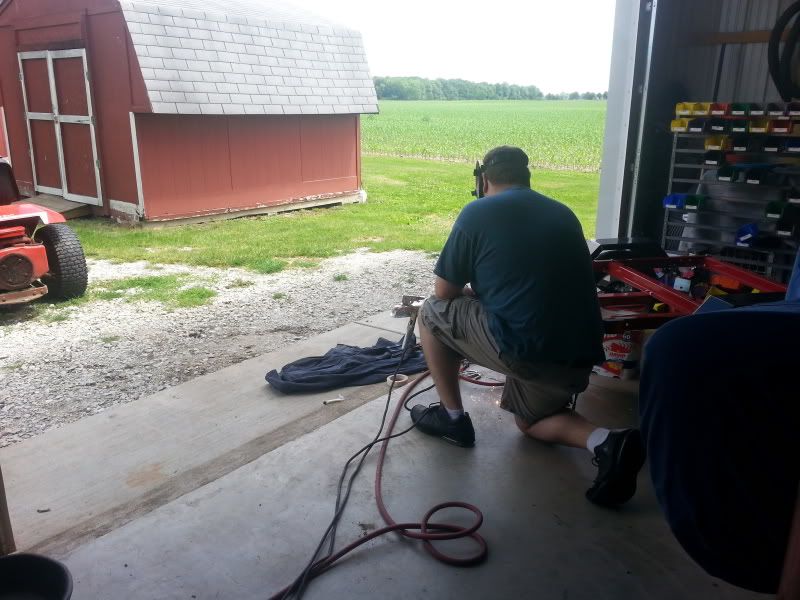

then i added stabilizer jacks to the back, and a tounge jack to the front, first time welding in over a decade, but its like riding a bike.

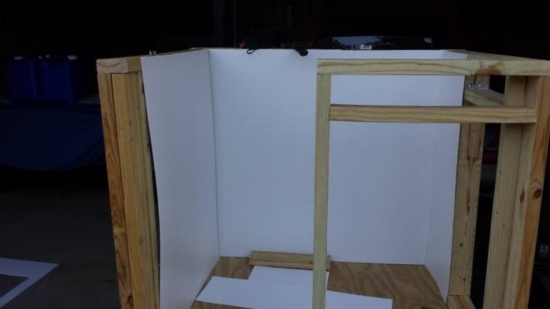

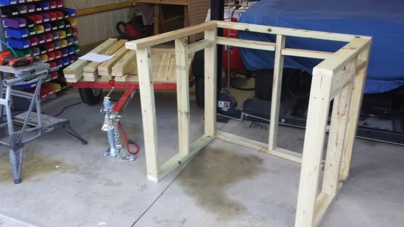

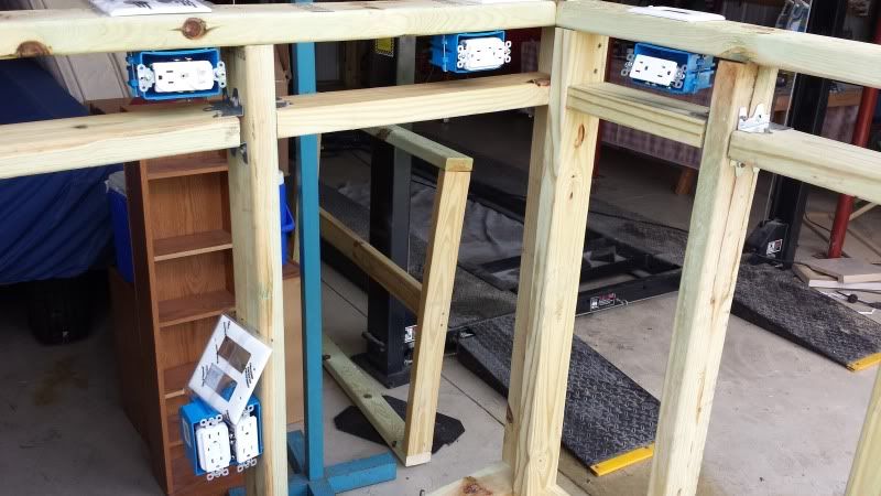

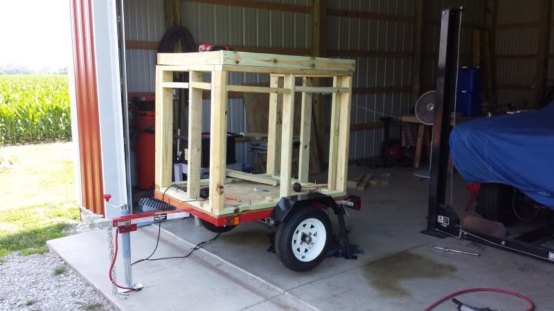

and this is how it sits, got it framed, need to pick up a few more screws and brackets, so ignore the crooked parts, they arent screwed down yet. next step is wiring.
all treated lumber, coated screws, and stainless carriage bolts holding the walls to the frame.found out after everything was cut that my tape measure was half an inch short, so things arent lining up perfectly, but i dont think the little gaps here and there are going to be a big deal, im going to skin it with plywood anywho.

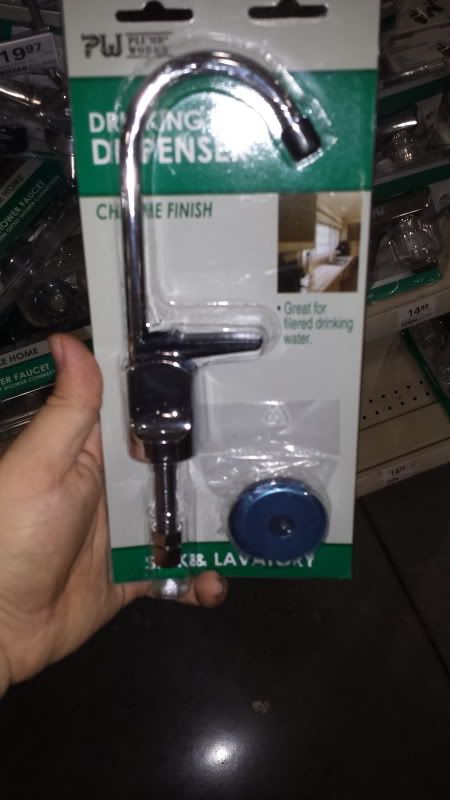

got one of those drinking water spouts picked out for my sink, as well as an on demand pump.

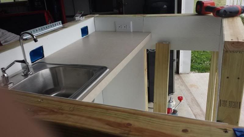

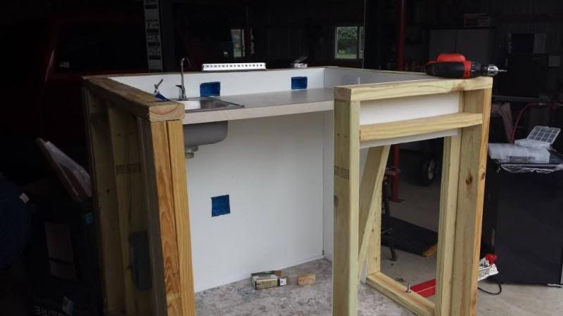

****update 7/10/13****

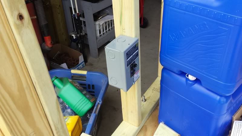

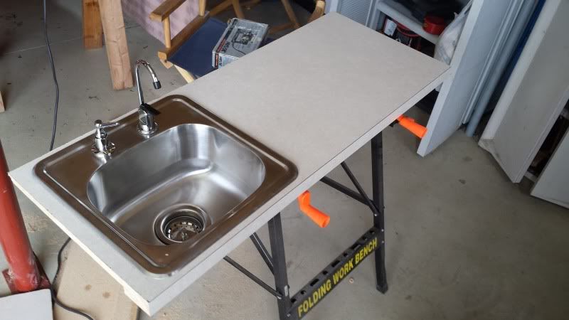

got the electrical boxes in place, and got the sink mounted to the counter
since im not going to have hot water, just a simple drinking water faucet on the right, and to fill the left hole in the sink a counter mounted soap dispenser.

Lunchbox7985 wrote:ignore the mess in the background
Uh, no, sorry, can't. Is that a mid '60's Chevy Impala or Caprice with rally wheels? Maybe a big block car?
Do tell. :D
Do tell. :D
lol, that and I was also admiring the lift it's setting on.... :lol:

Postby GerryS » Wed Jun 26, 2013 5:28 am
I thought it was an olds cutlass....

Postby Lunchbox7985 » Wed Jun 26, 2013 10:50 am
that is about 3/4 of my uncles 66 impala. and its just a small block, either a 283 or a 350, dont remember, hes building it for looks not power. and thats my dads garage, and yes that lift is nice to have access to. also got 4 toolboxes (1 big and 3 small) 2 welders (stick and a mig) solvent tank, mini fridge. tis nice :D

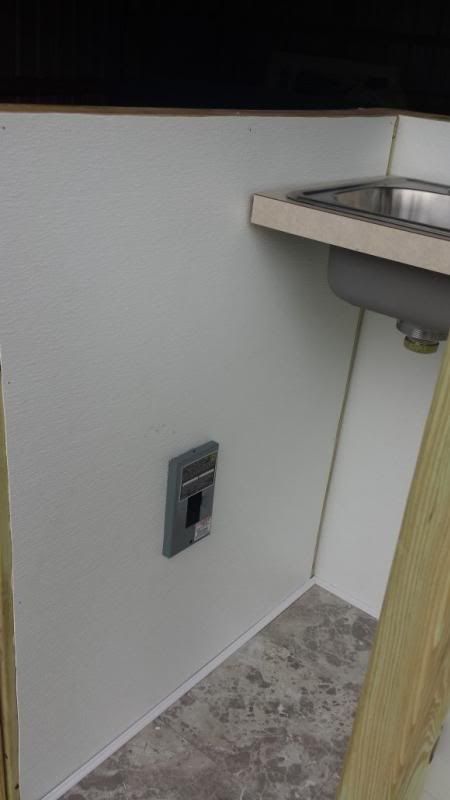

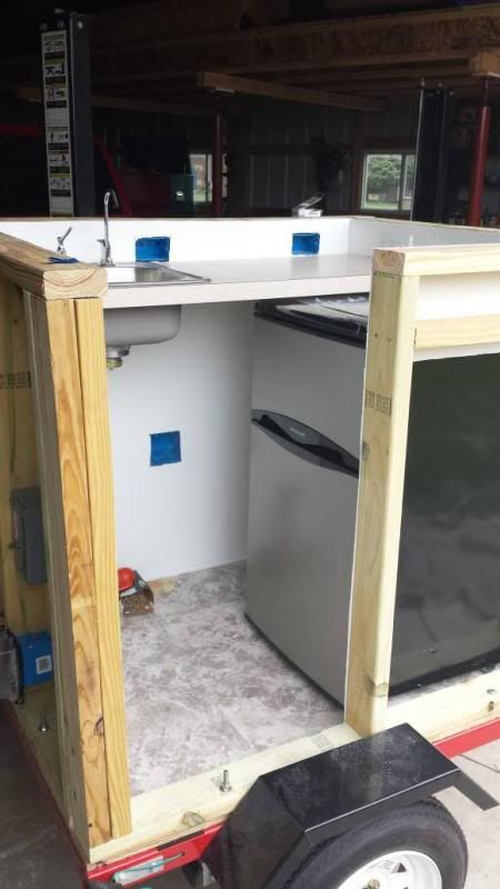

Postby Lunchbox7985 » Wed Jul 31, 2013 8:04 pm
got a good bit done on my last two days off
got a 4x8 sheet of this fiberglass/plastic stuff. pretty thin and durable
got the outlet boxes cut out, and the counter almost in there, going to have a piece over the fridge to make the counter L shaped.
still have some trim work to do, corners and such. then i think next step is to run my wires, then i should be ready to skin it, and lastly (since the water tanks are going to be in a small box on the tounge) is the plumbing/pump/accumulator tank. then paint, finishing touches and all that jazz.
im not thinking im almost done or anything, but i think ive worked out everything at least, and ive got the counter and fridge sitting in there, so ive got a definite yes on my clearances. its nice to have the rest of it laid out in my head.
oh and i almost forgot the faux marble linoleum tile floor, i was stoked when i saw that, as i orginally wanted to splurge for real marble tiles since i only needed about 9 sq feet, but i got the whole floor for $9.
