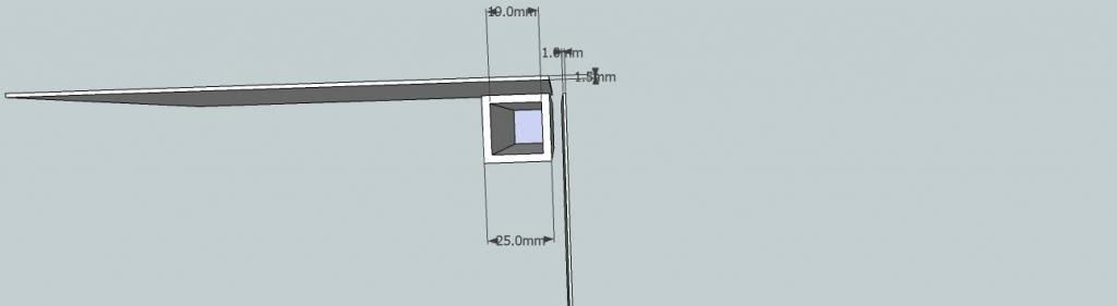

Postby dean_petley » Tue Jul 16, 2013 6:12 am
a rough section of the roof wall and hoop i am going through the extrusion book tomorrow to see what i can use to join and seal the roof and wall and to affix the sheet to the hoop i am thinking aloy 6mm rivets

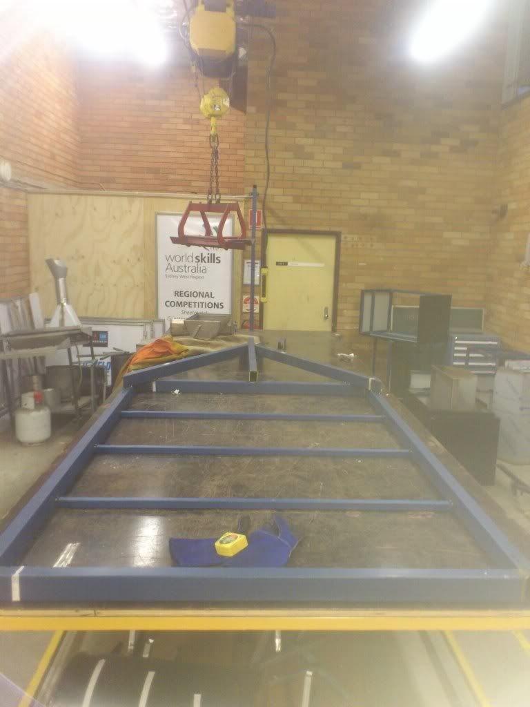

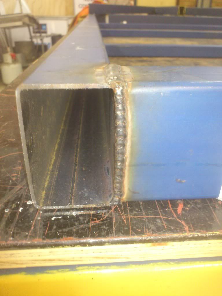

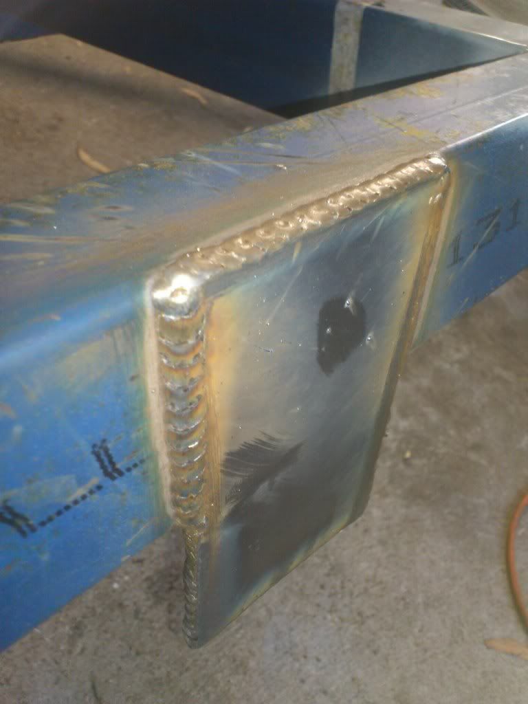

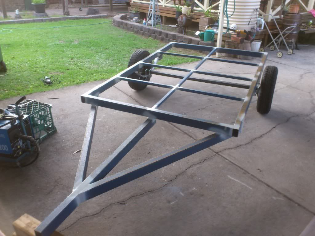

Postby dean_petley » Tue Dec 10, 2013 3:57 am
ok kids it been a while i have been busy with work and family BUT
im back for an update
built the chassis from 50 x 75 x 1.6mm rhs with 30 x 30mm rhs
this was the basic layout on a bench at tafe
welded end section
goose neck tacked in place
first lot of floor spans tacked in place
end caps / strengthening plates for the goose neck
all together and on wheels
with some alloy sheeting in place
and thats about as far as i have gone my next job is to find someone who can roll the steel hoops for the side profile so i can weld them inplace then the spreders then sheet the body
but i am having real trouble finding someone who can roll the the profile i have drawn on autocad i think i might need to build a press and do it my self
have funn

Postby michaelrsydney » Tue Dec 10, 2013 8:27 am
Nice work Dean! Not the first time you used a welder eh? :)
I look forward to seeing the profile you choose to build. My concern with your plan to frame it in 25mm square tube is that you have very little cavity space for insulation, especially in the roof. Ideally you need a combination of bulk insulation (foam or such) and an aluminium reflective surface facing an airspace of at least 20mm.

Postby Junkboy999 » Tue Dec 10, 2013 3:39 pm
Great looking frame. I’d say just go for it and make you own bender. It is hard to find a shop that will do “Piece Work” ( just or of two parts ) any more. They all want full drawn out planes bigger contracts.
