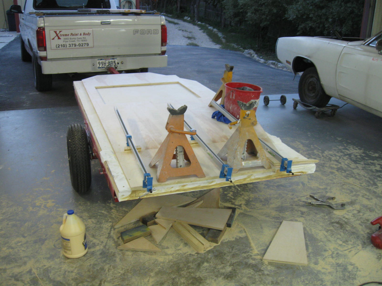

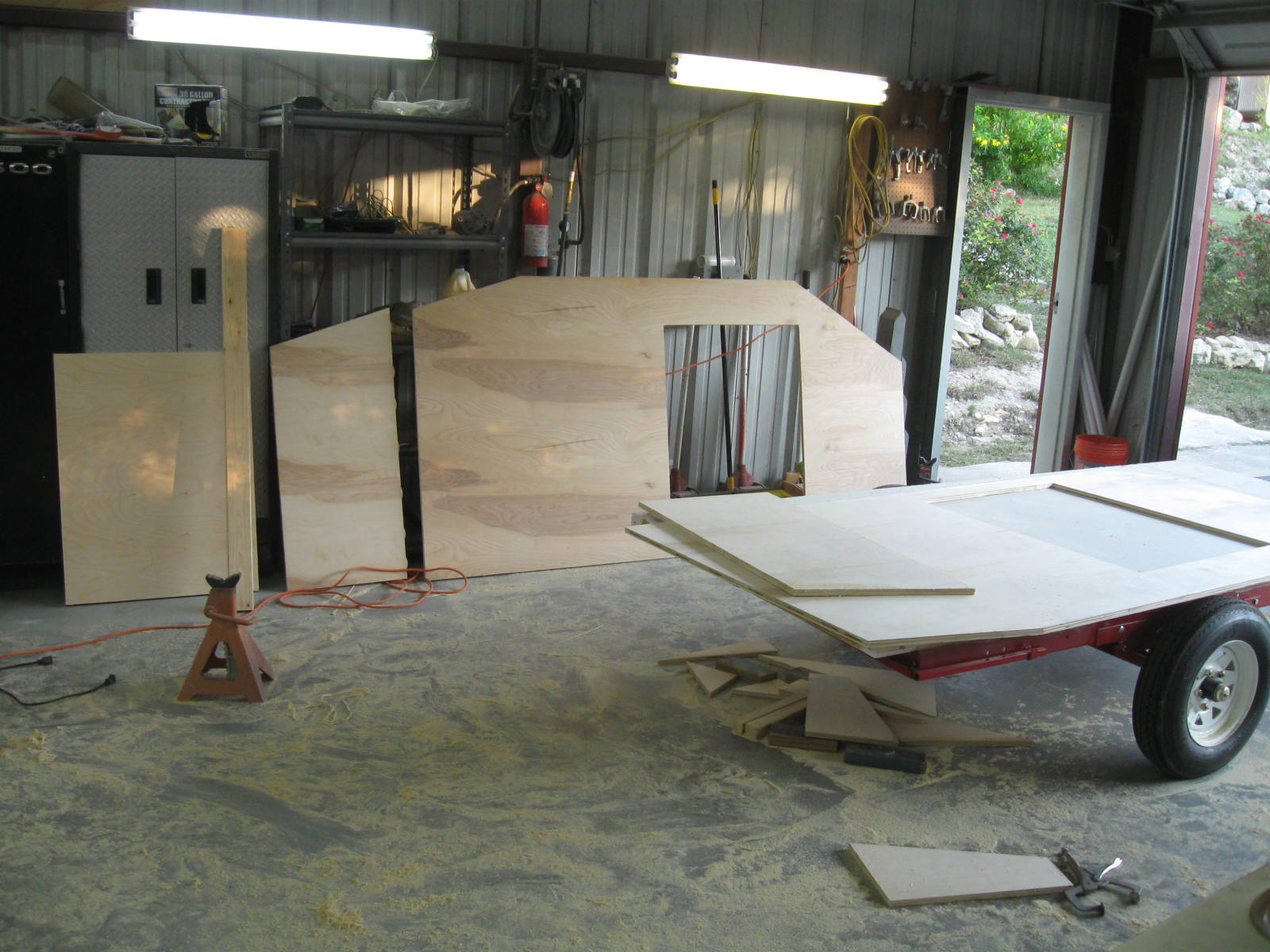

I have got a good start on a sunny october sunday :D It is similar (or will be) to the "weekender" With changes needed (or desired) for my trailer size. I have a good feeling I might be camping in this by Christmas time :D

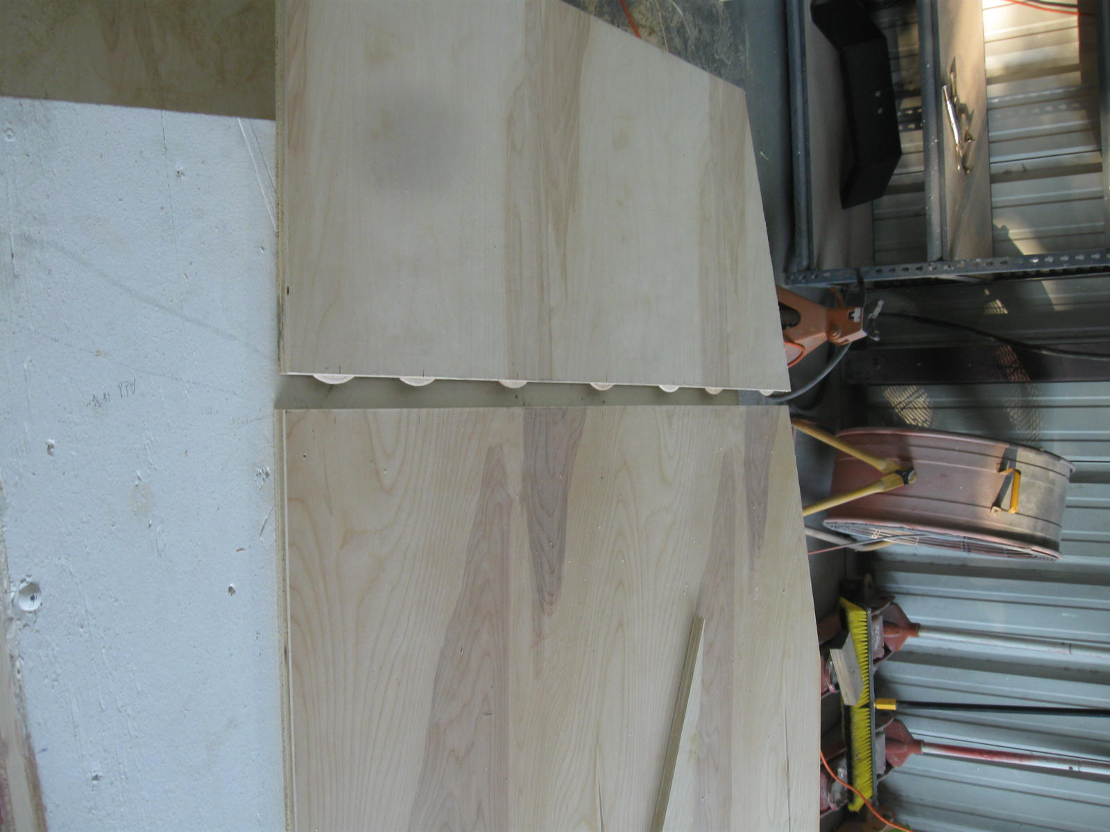

Im currently working on the doors while the 2nd side graft is glue drying. I took Estabans advice and used some glass on the joint on the inside side. The outside I will use a filler of some sort. Probably short strand glass filler. I have a question on building the doors. I know they need to be slightly smaller than the door openings, but how much smaller. I assume I would want to edge the door and or opening in some sort of trim so the wood doesnt get raggedy after a while. If this is correct or a good idea, what do I use and how much should I trim the doors to make them fit well when finished. I plan on using the flexible T molding. Appears to be aluminum. Ive seen it used on doors here. I'll look at the other links Estaban posted in my other thread for the handles and hinges. Any door building threads would be welcome to post in here

I will stay away from offering door building suggestions as mine didn't come out well (enough). Other than do not store your doors leaning against something for a long time. Store them dead flat, maybe with weight on them. Mine warped as the inside wood frame dried out. The outside had fiberglassed 1/4" plywood, a 1" frame interior and insulation, and a 1/8" inside birch skin. The stresses/strength were uneven...so it warped...maybe more so because I didn't store them flat. :x
Fiberglassing (tape and epoxy) the outside plywood joint would be a good idea as it will be out in the weather and more susceptible to water intrusion and or cracking.
I think I read that you plan to use aluminum trim between the walls and roof. Good.
Or you could round them over a bit and fiberglass them (epoxy and tape or cloth - your preference) and skip the aluminum there. :thinking:

I appreciate your help. Im sipping on a beer and thinking of ways to do the doors. Ive come up with some ideas. Im using the cutouts from the sides as the doors. Im pretty sure I want to go with a piano hinge for the hinges. :thinking: I havent given the hatch a whole lot of thought yet. Im a ways off from getting that done, but I did notch out the sides for the hatch thickness plus allowing .25" for the gasket. I didnt want to have to do any notching like that after the walls are errected. I will not do alot of work on the walls like you advise. Im sure I will just create a buch of extra re work if I do that.
The reason I dont want to glass the outside of the splice is because I dont want a bump there. I would rather put a piece of painted trim on the seam if it looks to be cracking

Glass is very thin if you use 4 or 6 oz. fabric. So thin it's lmost invisible. You can feather it out with fillers or a "bondo" type of filler...which should be up you alley. I suppose you could take a belt sander to the joint to sand a little wood away and then fill it with epoxy and tape...kind of like the indented edges of drywall. Once filled and painted it will not show.

I did what you suggested with digging out a little wood at the joints and boy I have alot more confidence in the integrity. It was alot of work as glass sands like ass LOL. But Im glad I did it. I did some cosmetics are no one will ever know there is a joint there.

I didnt get progress pics on that process (the glassing of the joints) because I was just too busy getting it done, but I can get some after pics later.
