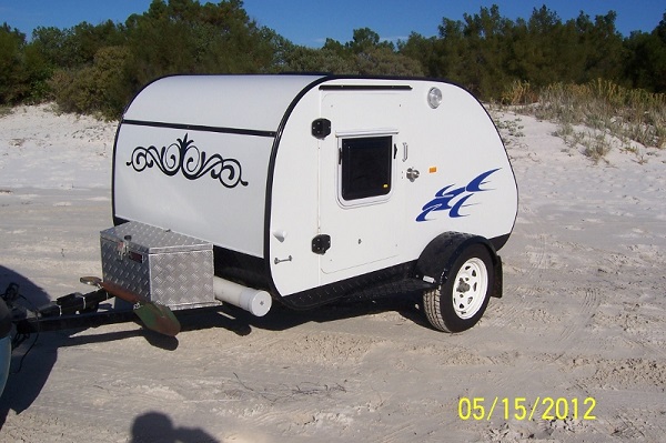

Postby Roo Dog » Sat Nov 09, 2013 4:39 am
Jgrote,
Steel clad Tear in the picture. Sign grade prepainted.No signs of rust after 2 years, lives right on the coast and gets a fair bit of salt on it. Just a thought.
Black sections are powder coated diamond pattern ally.
RD :)
