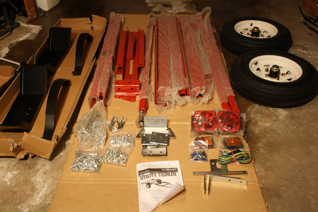

Man, I jumped right into this. Only been a couple weeks since I first got the idea to get a camper, now I'm building a teardrop (or tiny travel trailer). Haven't decided on the specifics, but I picked up a 1720 lb HF 4x8 trailer today.
The cashiers at Harbor Freight recommended I don't go to the DMV to register, as they've heard stories from people saying it could be a nightmare. They recommended a small title place, I went there, paid $136, and I have a temp plate right now, and within a month should have my title and real plates. I did some research here, and if a cop asks why I have regular trailer plates and not recreational trailer plates (Illinois has both types of plates), I'll tell him it's a utility trailer hauling my camper, and show him how I could unbolt the camper from the trailer if desired. The cool thing is that once I assemble my trailer I can slap on the temp plate and use it to go get my wood, instead of borrowing someone else's trailer to do so.
I don't have a whole lot planned specifically yet, but I have a general picture floating around in my head of how it will be. Rigth now I think it will be built with 1x1 framing, skinned on both sides with 1/4" ply and insulation in the middle. Will have a 7' long sleeping section, since I'm 6' 5", and will probably be built 5' wide. I plan on having a deep cycle battery, roof vent with fan, LED interior/exterior lights, high mount brake light and amber turn signals, including flashing amber running lights, and a automatic connect/disconnect via relay and microcontroller to charge the battery when my car is running but not when it's off. The electrical part should not be an issue, I dabble with some electronics and microcontrollers. Still a lot to research, and it'll be a week or two before my trailer is running anyway. It will sure be a learning experience, and look for my questions in threads I'll post elsewhere.
Hope to have the trailer built by spring, so I can camp before the summer heat hits. :yes:
