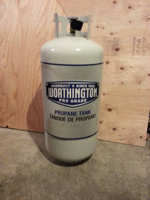

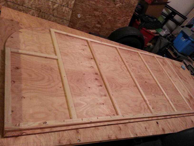

Here is my update I got the passenger wall done then realized I forgot to cut out the door. So I will cut it out then frame it. I also got this propane tank at homedepot for $20 what a steal. [attachment=-1]uploadfromtaptalk1395899838923.jpg[/attachment][attachment=-1]uploadfromtaptalk1395899853669.jpg[/attachment]
