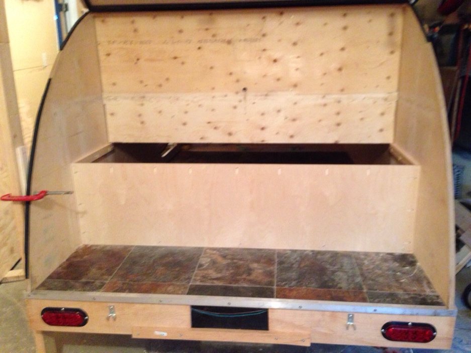

Some more progress has been made. I have laid the vinyl flooring on the floor and added an aluminum trim strip at the back edge. I've also figured out where the wall between the cabin foot well and the galley's lower cabinets would be. This wall with the other framing on the walls and the cabinets will support the counter top.

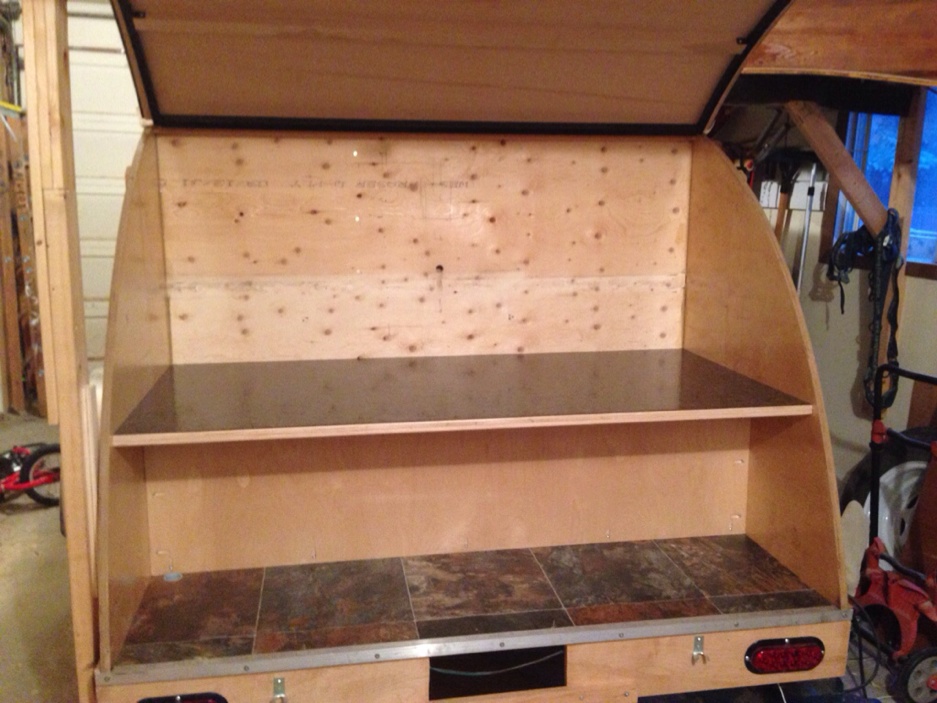

Here's a quick photo of what the counter area will look like. This is before the laminate was added to the counter.

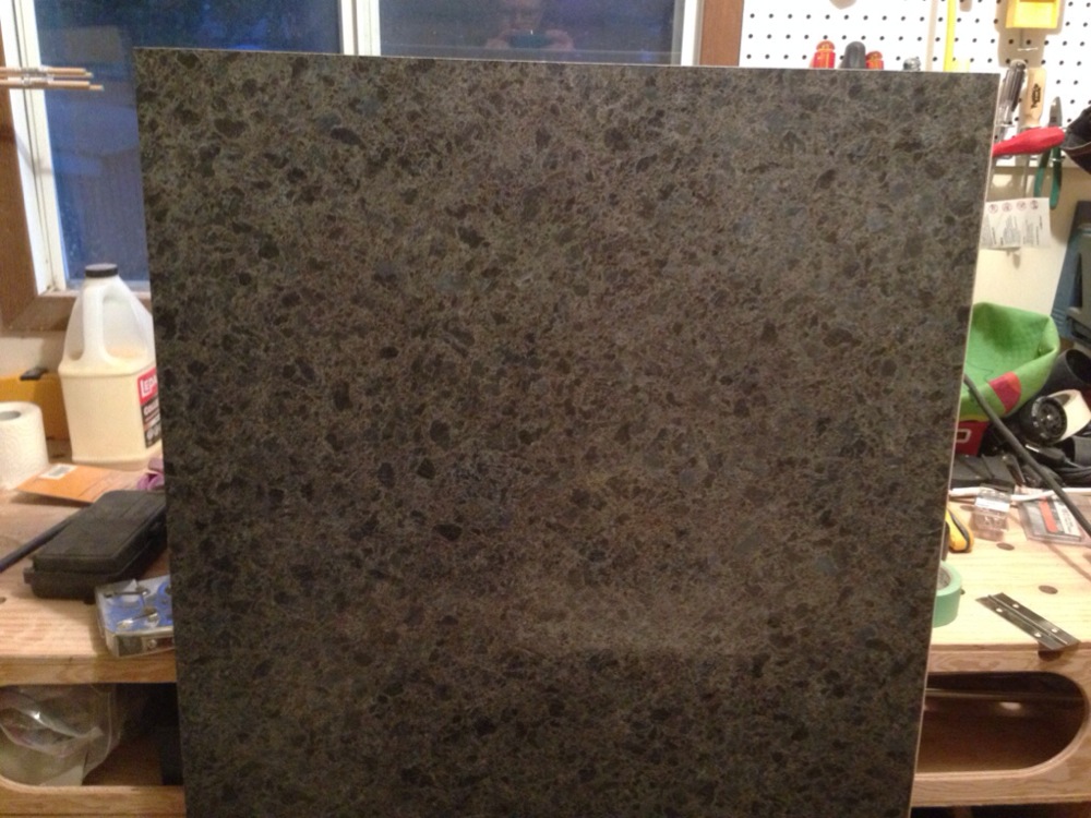

My wife and I know a cabinet maker in town and I had a look at his leftovers and I found a great piece of laminate for the countertop. I've never done laminate counters so he laid it down on the plywood for me. Here is a photo of the counter. It hasn't been installed yet as I have a few things still to do before I can put it in permanently.

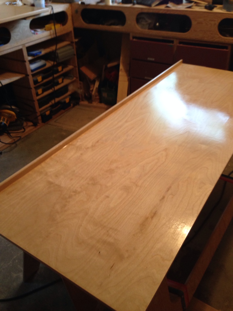

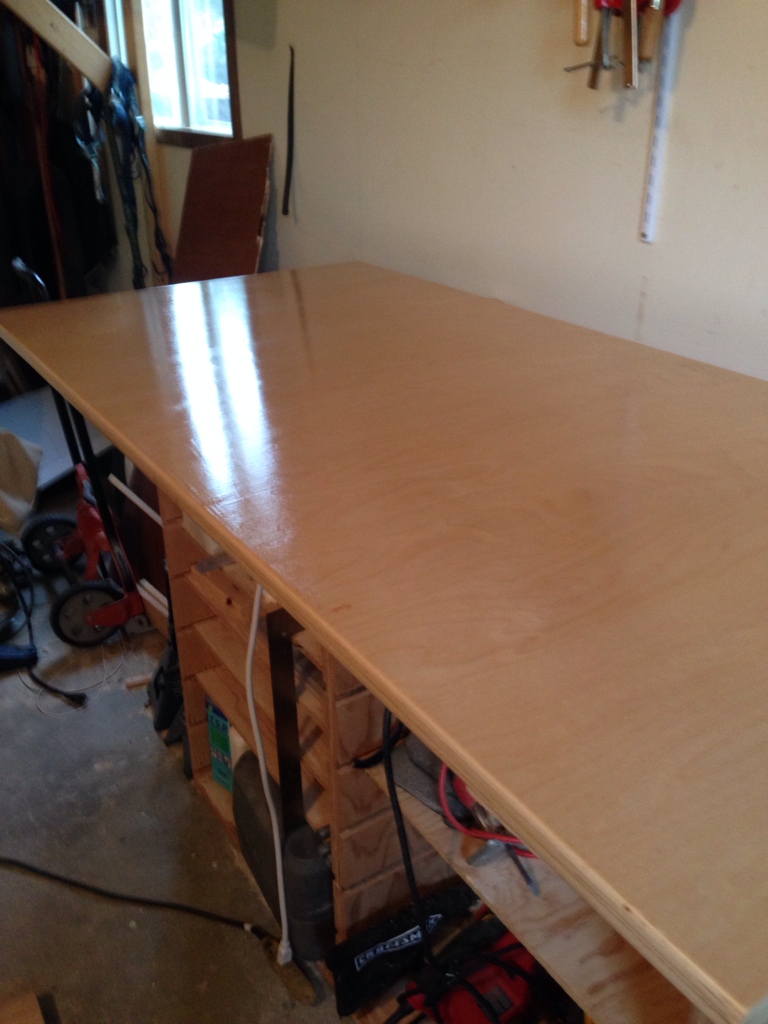

The last couple days have been focused on giving the galley interior several really good coats of clear varathane. I want to get the walls countertop bottom and sides, and board that separates the footwell of cabin from the gallery well sealed before continuing with any build in the back end. While I was sealing those I also got the bunk sanded and sealed. a few more coats tomorrow and these pieces will all have a nice shine. They are looking good!

Kids slept in this morning so I got my last coat of Varathane on the bunk, counter and galley walls.

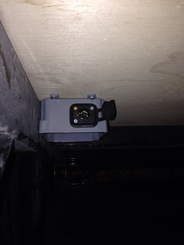

Postby inthewoods » Fri Jun 13, 2014 10:00 pm
The other day while waiting for Varathane to dry I tinkered around with some electrical and got the shorepower inlet set in place and made up the extension that would run from it to the 120 campsite power. My inlet is located right under the galley on the driver's side at the back. It's within easy reach of the back or side and it keeps fewer holes in the sidewalls of the trailer.
You'll notice in the photos I went completely non standard on my choice of power inlet. I don't want the typical 30a RV style connectors and don't need that quantity of power so I decided on basic 20A. So all the wiring breakers and GFCI will all be 20a rated. For my power inlet I went with specialty power connector products from Neutrik. It's tiny, rated for 20a and is both water tight and fully locking so it can't fall out or pop out when someone trips on the cable. Here's a link to the product:
http://www.neutrik.com/en/video/powerco ... con-true1/
And there's a couple photos attached. In the end because I'm in canada it cost me about the same as a generic Marinco 15a inlet like I see is very popular on teardrop builds.
