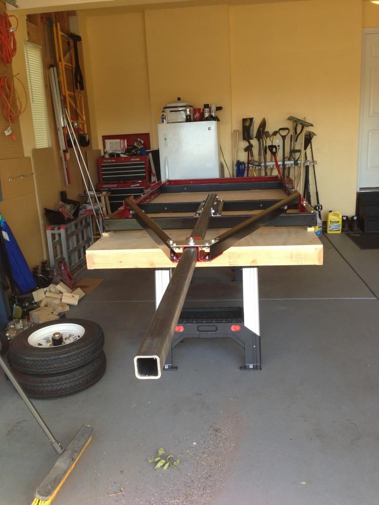

First, a little about my intended design.
-5'x10' footprint on a 4x8 Harbor Freight trailer w. extended tongue
-5' sidewall height
-Drop floor to support a folding seating / bed / dinette area, much like the dinette area in a pop up camper
-Manufactured doors (2)
-Filon or Aluminum exterior
-Galley with slideout for cooler, counter, storage, water. I will not cook in the galley, but need storage - including port-a-potty
-Exterior table to attach to sidewall (removeable) for cook stove
-AC/DC power (Progressive Dynamics)
-Onboard Batteries and Propane
-Water heater setup for hot showers via external shower setup
-Heat and possibly AC, unsure of exact implementation yet

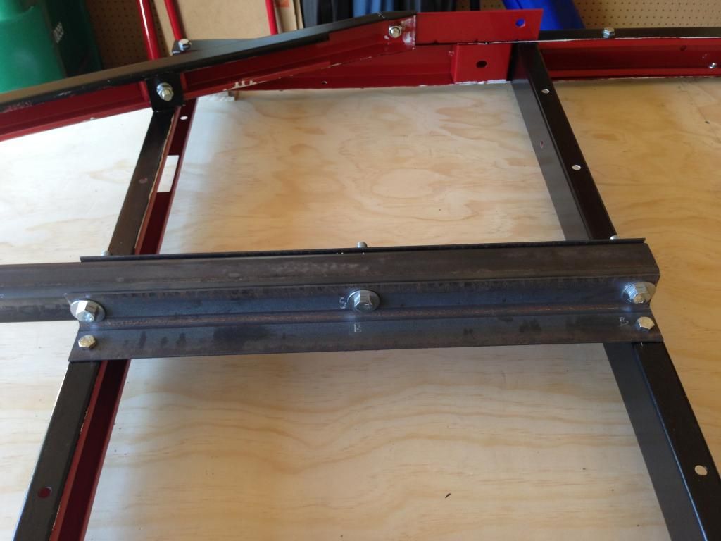

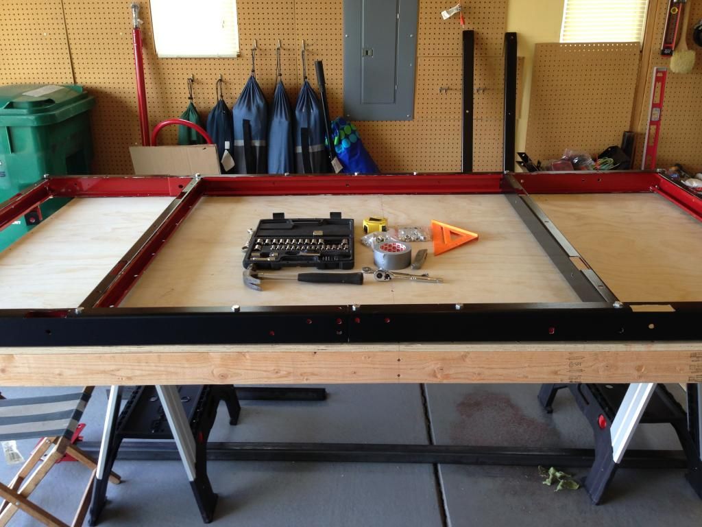

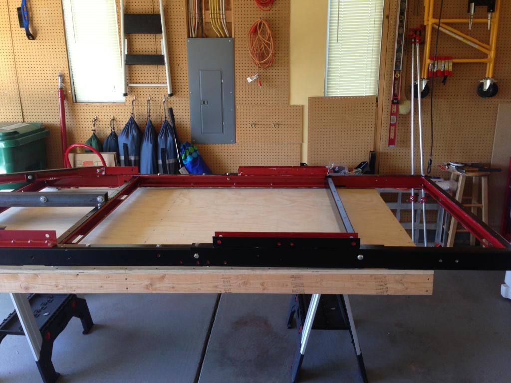

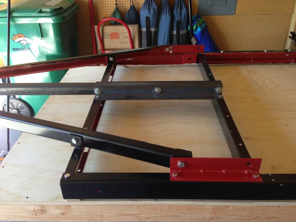

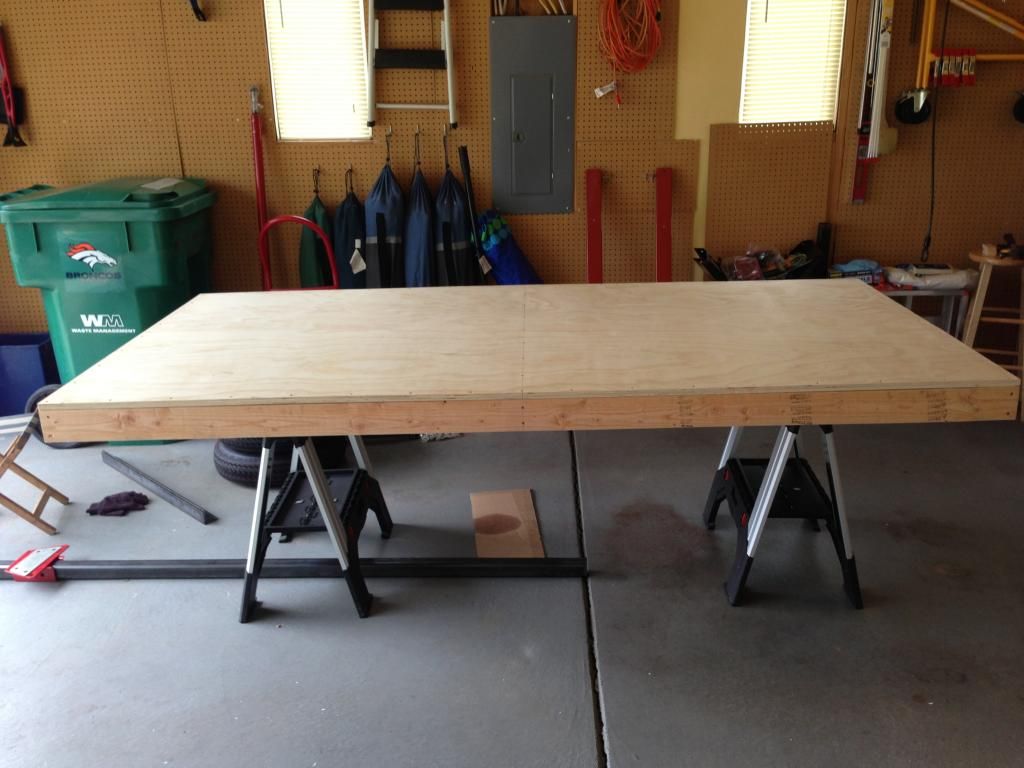

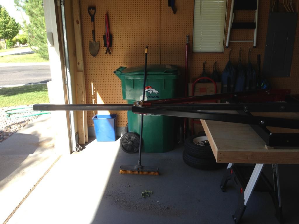

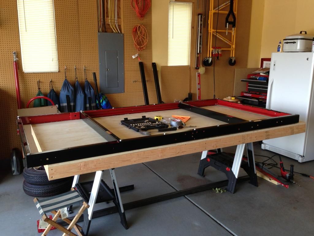

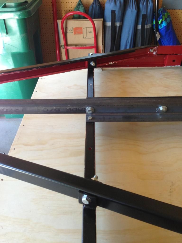

So far, I've built the bulk of the trailer kit (modifying for a dropped floor), moved the axle mount (spring hangers) back about 6 inches, and extended the tongue. Still need to attach the axle, pack the bearings, and paint the trailer before I get started on the real work. As you can see below, I had the silly idea to paint it first before assembling it, and somehow put it all together without destroying the finish - not my finest idea.

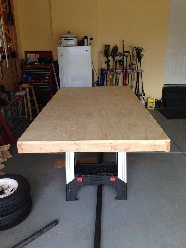

Without further ado - my progress so far (including the 4x8 work table I built).

I really like that weld free tongue extension on the HF trailer. Is that 2" square tube? That could be pretty easily retrofit onto a trailer if a person decided later that they wanted a longer tongue.
Laura
Bike-Drop a Micro-Foamy Build Journal http://www.tnttt.com/viewtopic.php?f=50&t=59274
My first Superlegarra-ish Foamy build http://www.tnttt.com/viewtopic.php?f=55&t=59049
lthomas987
Posts: 357
Images: 204
Joined: Sun Feb 02, 2014 2:41 pm
Location: Minneapolis, MN, USA
Re: First Build - 5x10 Benroy with Bed and Dinette Combo
Postby crpngdth2001 » Wed Nov 19, 2014 5:38 pm
lthomas987 wrote:I really like that weld free tongue extension on the HF trailer. Is that 2" square tube? That could be pretty easily retrofit onto a trailer if a person decided later that they wanted a longer tongue.
I'd have to look back at my PO or measure it. As I recall, it was 2"x2"x3/16".
