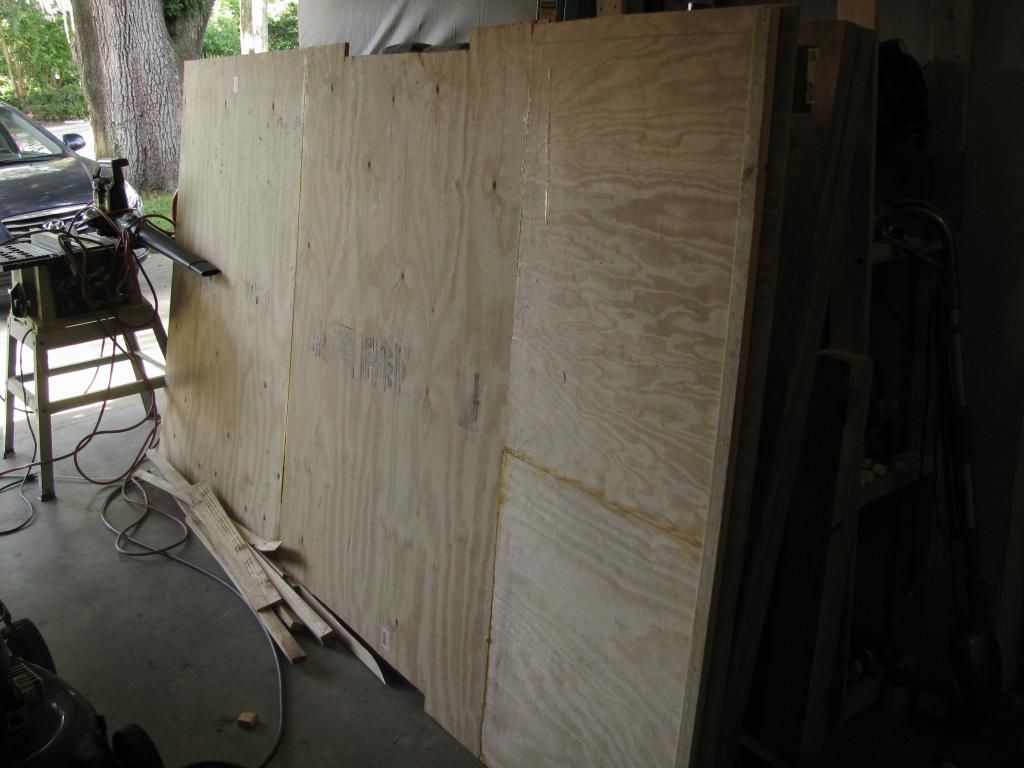

I have a 16' slab of doubled, laminated together 2X10's that a neighbor wanted to get rid of, so I am custom cutting them to extend the frame out 3 1/2 inches on each side. I am cutting them to go from the bottom of the frame rails to the same elevation as the 1X2 sticks I am using between the frame and the actual floorboards an the crossmembers. More on that to follow.....

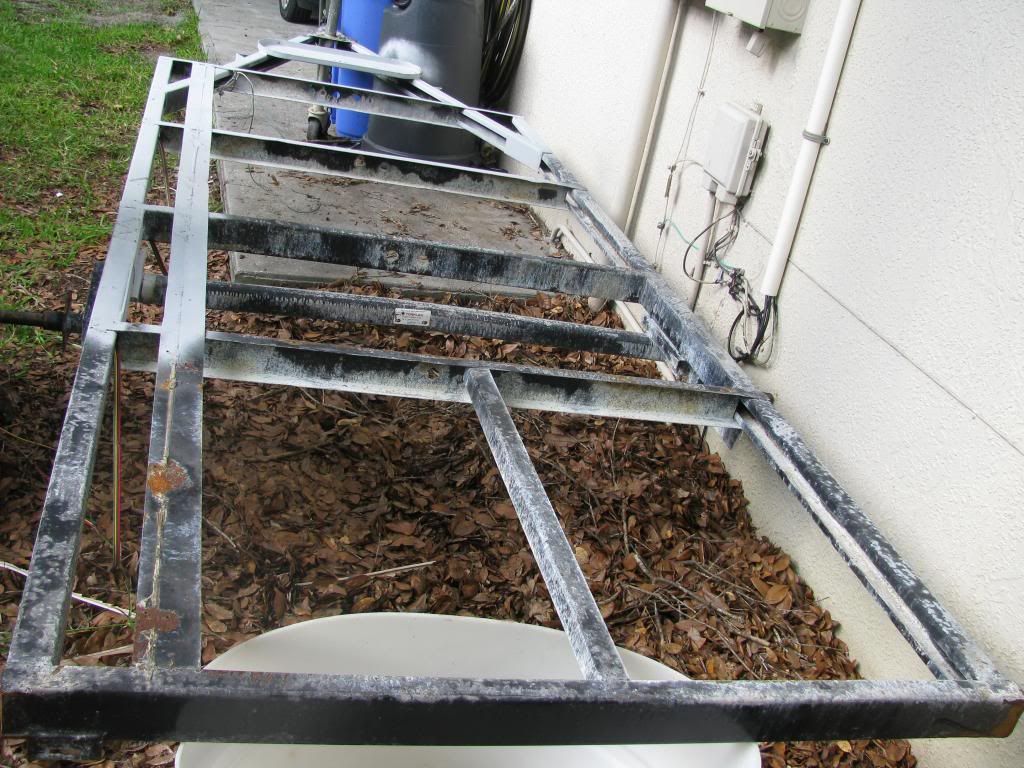

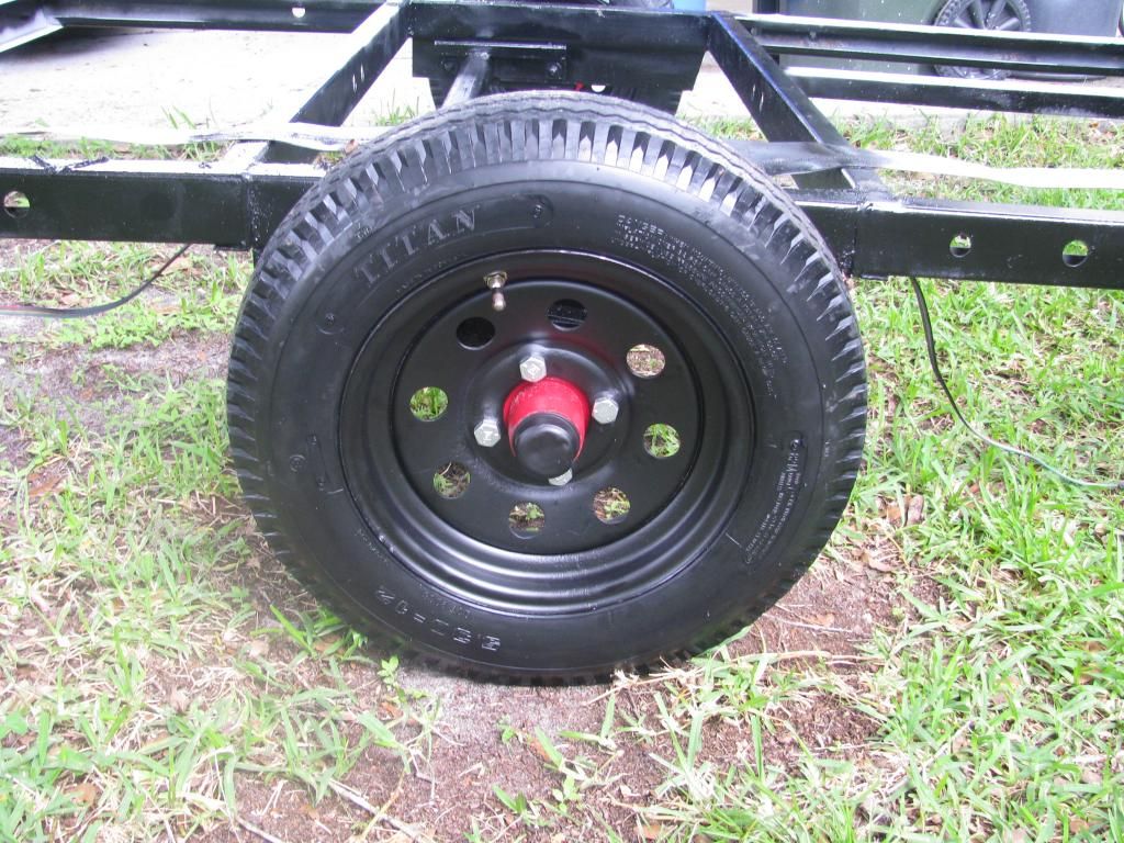

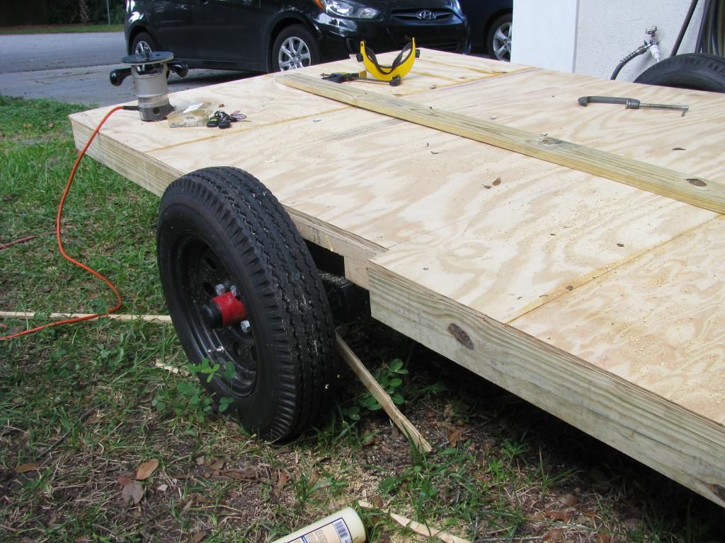

So....one of my neighbors is a large scale equipment engineer and mechanic. He asked me if I wanted the wheels Powder Coated and so he did them satin black with the dust caps the same black. I got all new lug bolts and new 5.30 X 12 tires (1090 cap.) and did the same metal prep and finish as the trailer but with Rustoleum gloss Red. I really like the way it looks together:
Here is a shot of the wheel and hub area:
This may not be real exciting to anybody else, but I saw it as a real great starting point!

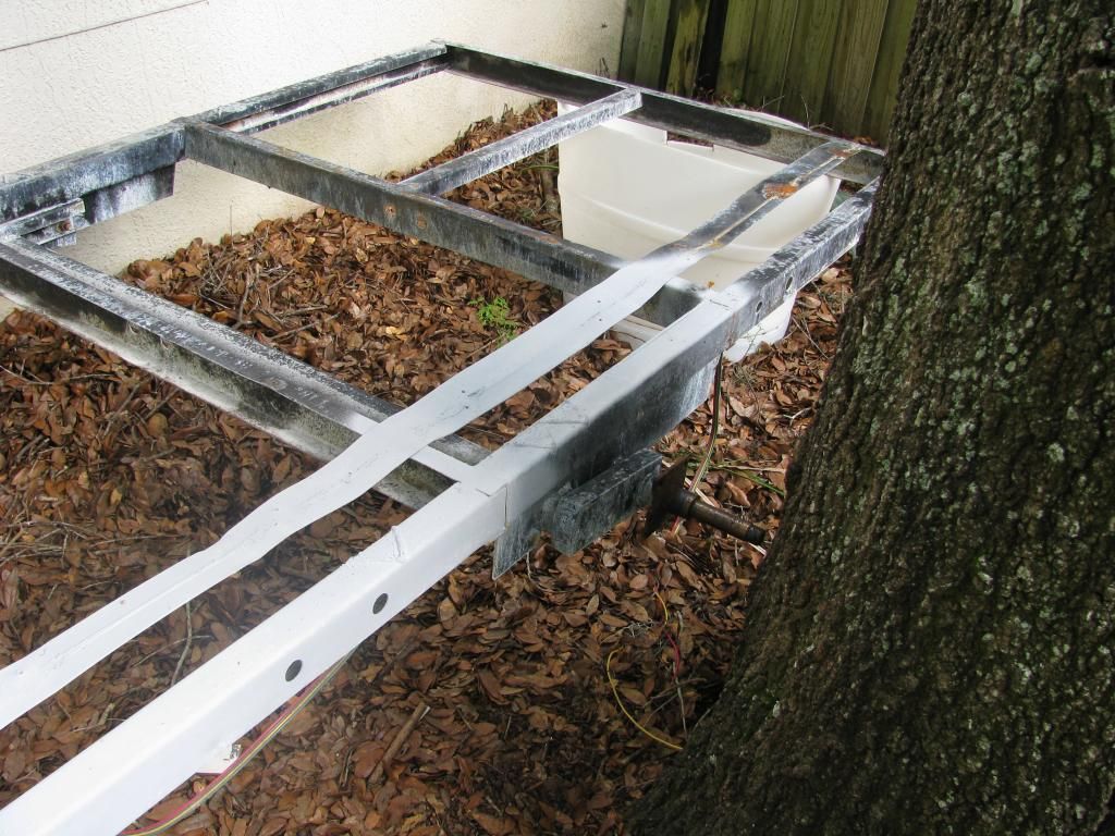

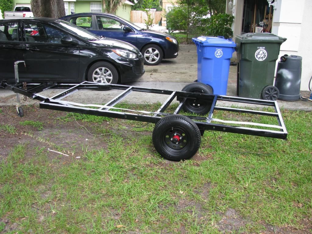

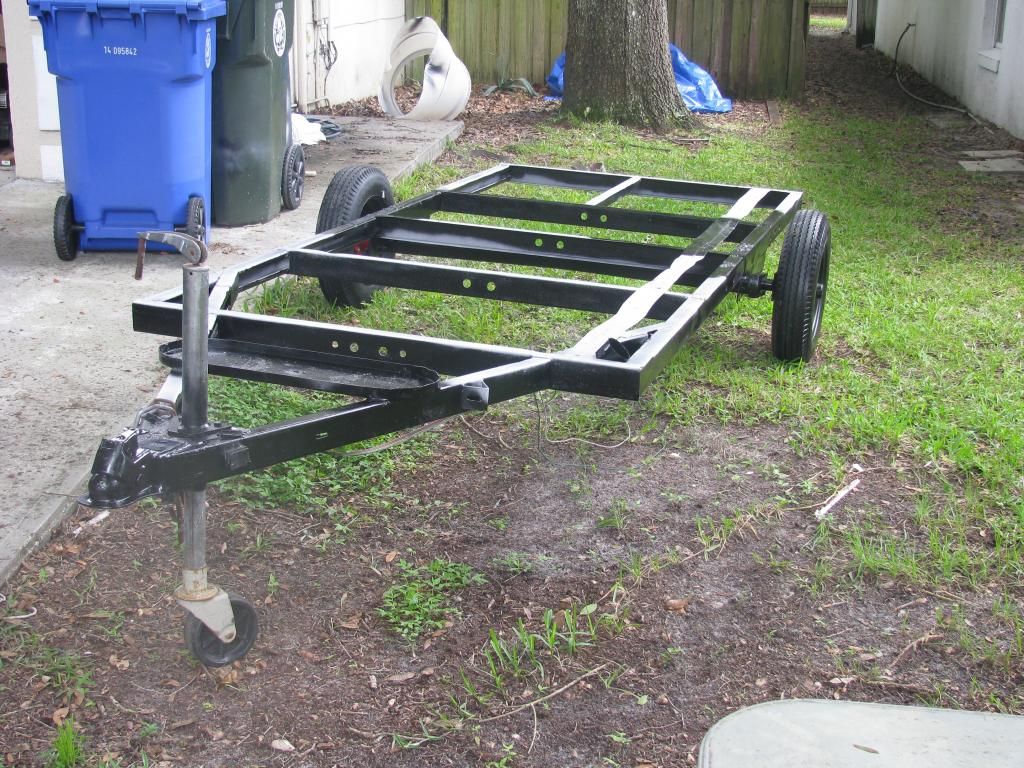

I finally finished painting the frame from the bottom and top to get all areas and paying attention to boxed areas and such. I went and purchased all the wood needed for my floor panel. I am using 1/2" plywood with a 1X2 and 1X4 support framing, to make a proper area for the fiberglass insulation board. I picked up the plywood, the 1X material and the first bottle of Titebond II. I mentioned the big timber my neighbor gave me anyway I will use it to extend the trailer rails out to the desired width without having to weld extensions on. I have come to the conclusion that I wish my axle was a bit wider, but I figure on making the body with a small relief to partially house the wheel/tire, with a fender inset (or cut off to be just the outer half or so) to match, adequately enclosing the tire. I ought to be making the first sawdust tomorrow, as I have a router that is just begging to come out of storage! I will be doing lap joints on the floor plywood once I have the frame widened properly. Then attach the bottom framing and Voila! I will have a beginning floor panel! Photos to follow.....
(again, realize I am copying this so a bit of time reference will seem weird)

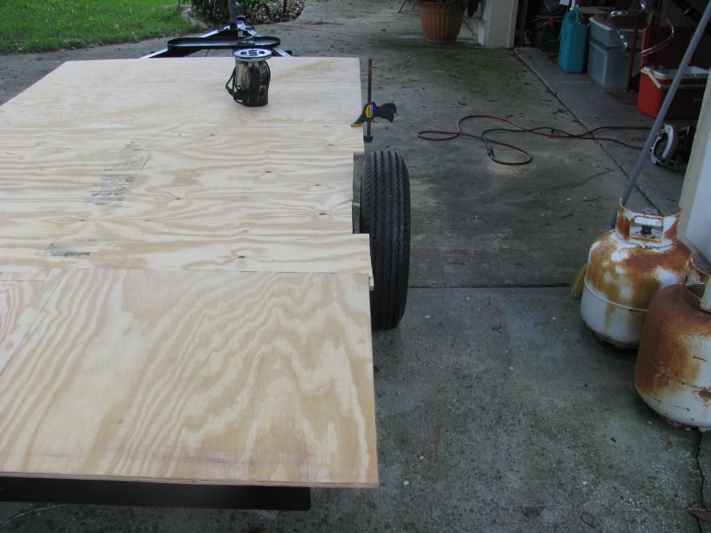

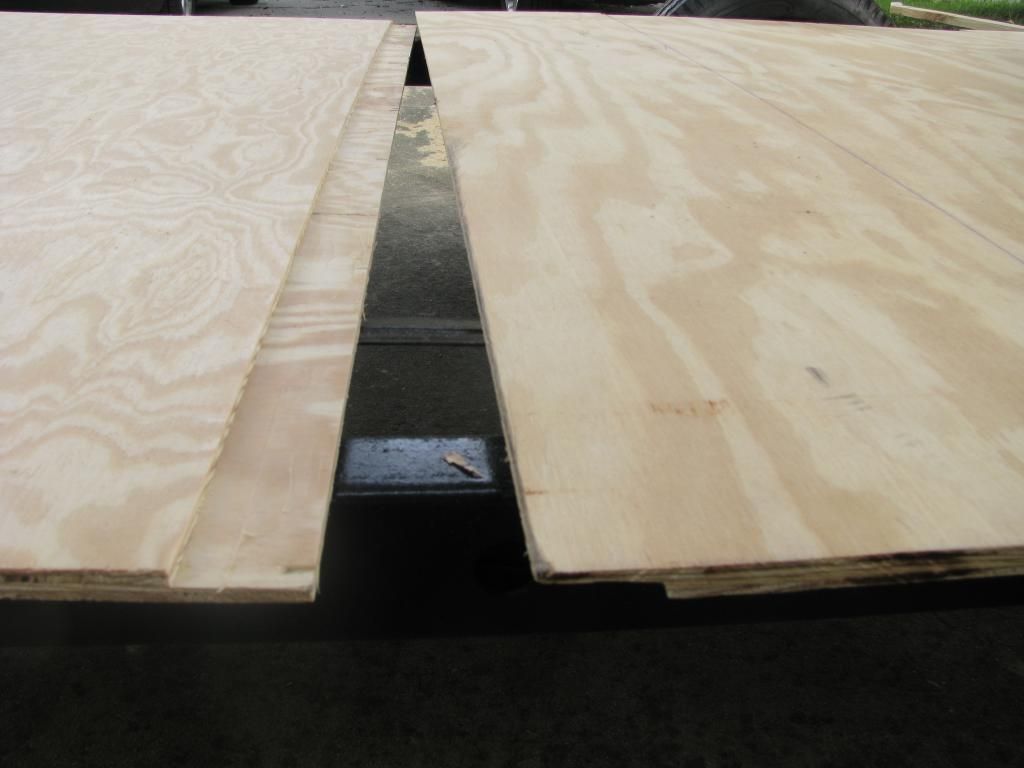

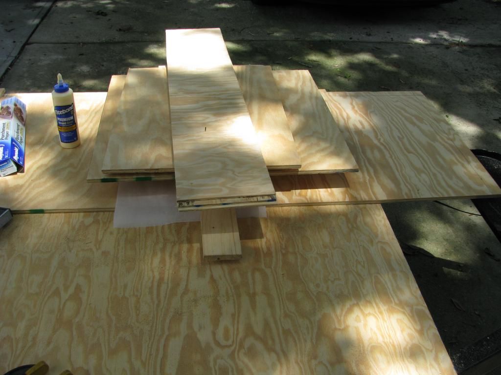

This is the plywood "rough cut" and laid out in place before any lap joint routing:
I started the lap joints with the two smaller pieces which will make up the Galley floor:
I used Parchment Paper from the kitchen pantry to prevent the TBII from sticking everywhere and stacked lumber on top for "clamping"
Unfortunately the day was a "Honey Do" day so I didn't get a lot done before the rain but I intended to finish the decking construction the next day. Two long lap joints then attaching the 1 X 2 and 1 X 4 framing for the deck.

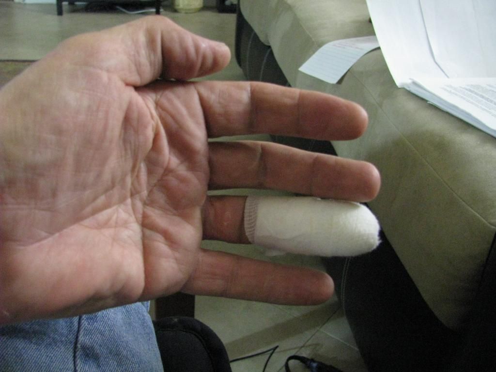

"So, just to get the injury out of the way, I did NOT hit the bone, but the screwdriver tip did, in fact leave both entrance and exit wounds in the pad of my finger. A true through and through. X-Ray showed "foreign material" inside the wound so the Urgent Care doctor said go see my Primary doctor for a recommendation for an Orthopedic Surgeon specializing in hands....so it looks like I may be in for a lot more hassles from this.
But, since everybody seems to love pictures, here is how it looks now:

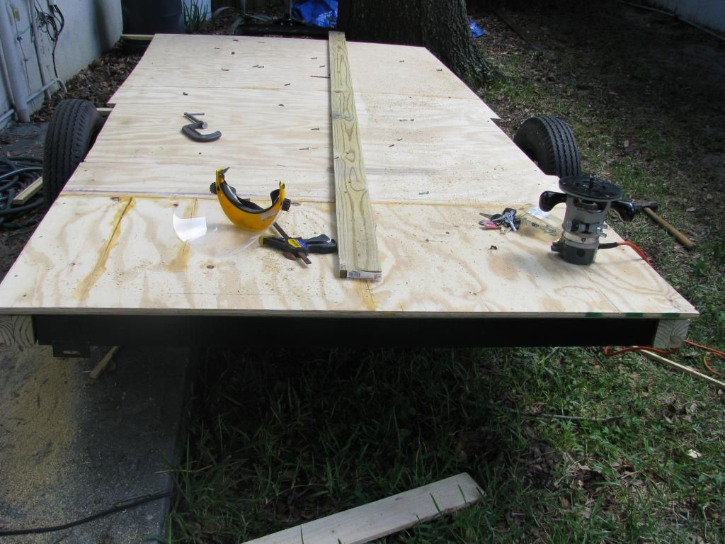

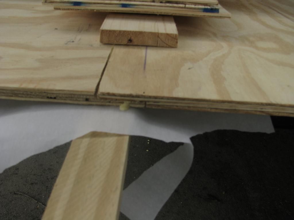

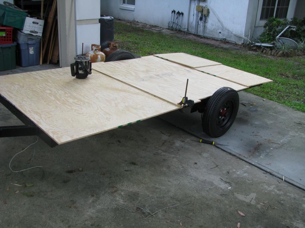

Like I said before, I got the rest of the lap joints cut for the floor, here is one of them, before assembly:
and after assembly:
Kitchen parchment paper was used to keep the glue from grabbing the weights!

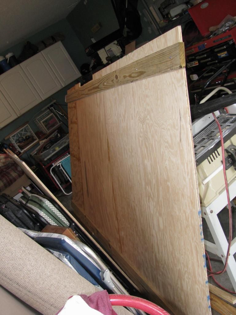

I didn't get good pictures of the final floor panel, as I had to stuff it in the Garage before I went to Urgent Care, but this is the bottom of the panel:
and this is the top of the panel with temporary 1 X 4 supports:

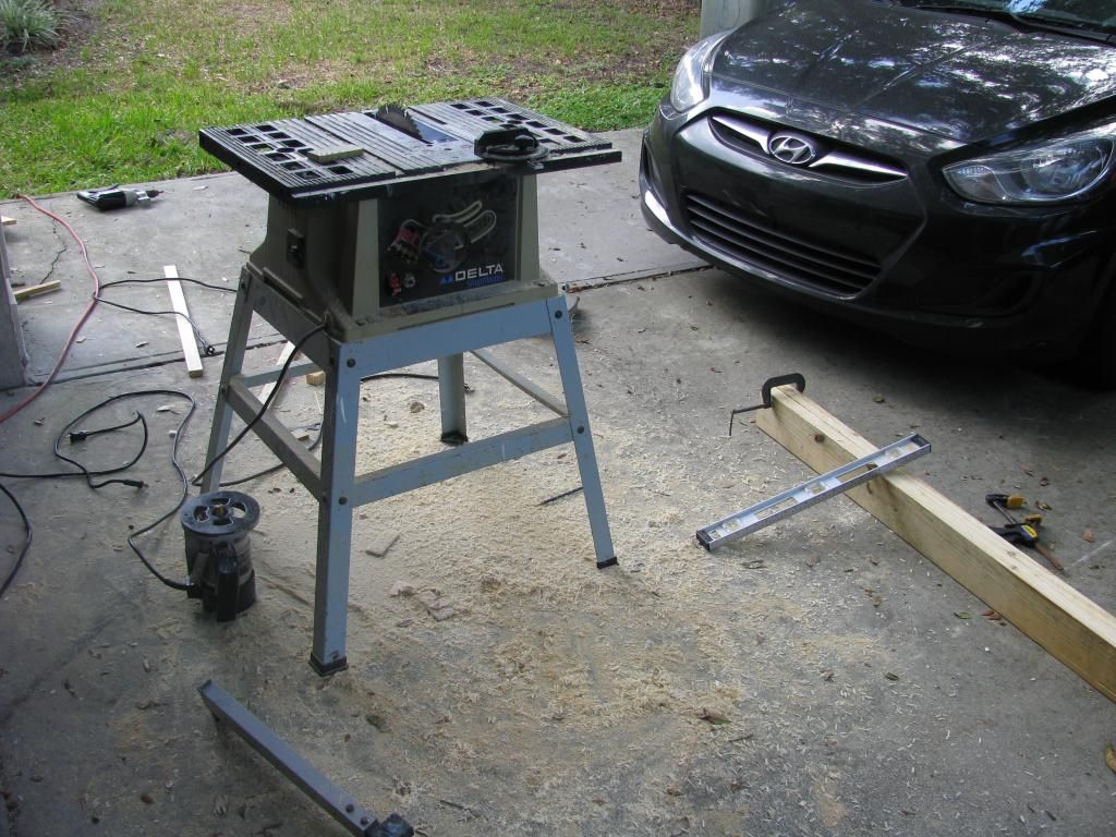

LET THERE BE SAWDUST!!!

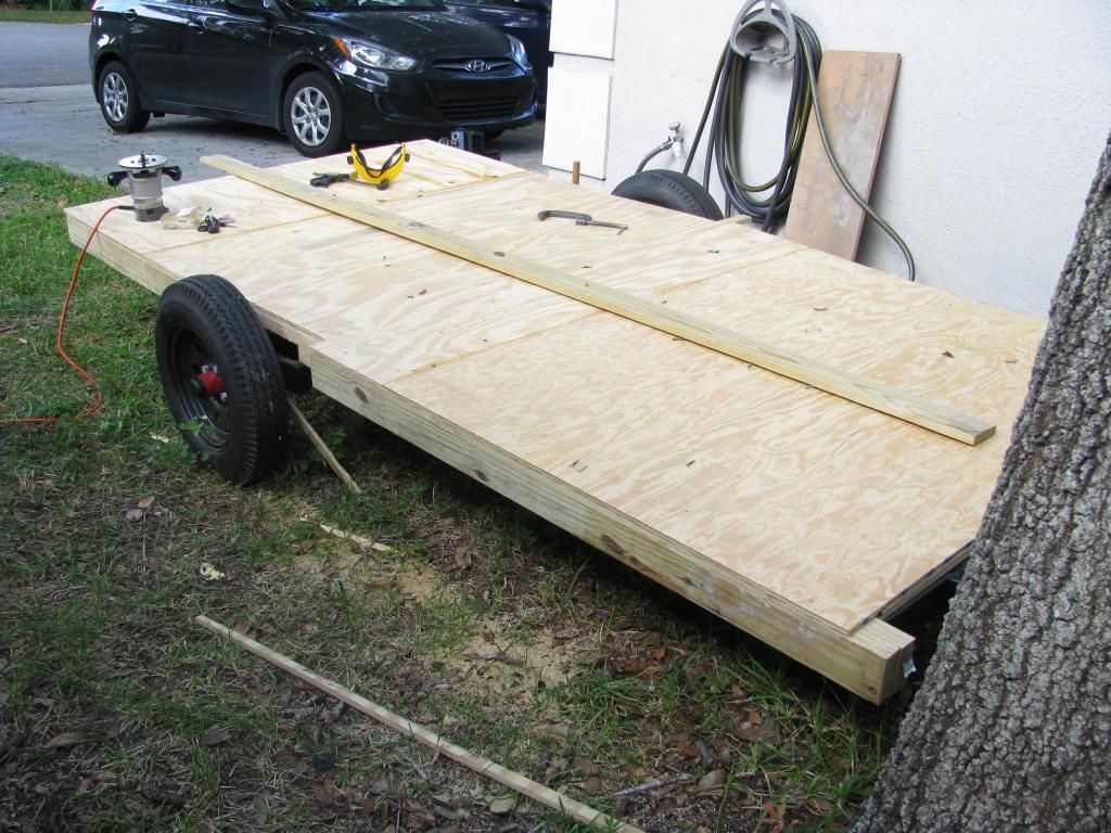

Anyway, I got out yesterday and had a productive day. I was able to finish gluing the criminal timber together and clamp it up, so it could dry as a tighter less "gappy" member. It didn't dry enough to work yet, but it is dry today, so it will be my next effort. Anyway, I got all the other pieces cut to size and placed around the frame with clamps, even if not permanently. I attached the floor panel to the existing timbers and then got out the new Router Bit and cut the flooring flush to the timbers. It was a little progress, but as always, I came up with little things I got done as I worked on the floor panel.....
Anyway, here are the pictures:
Lots of SAWDUST, even more in the side yard!!!!
I didn't trim off the front or back yet, as I will be placing 1 X 4 across the back and front members of the trailer, to give the "finished" look
There is an inset from 4 X 4 to 2 X 4 at the wheels, for a bit of extra clearance. and the 2 X 4 is then relieved for axle swing:
And no new blood!!!! except for a little cut on the palm of my right hand and some sort of scrape on the bottom of my foot. I really must start wearing shoes and a shirt when working....
Anyway, next I will cut the criminal element (the remaining timber) to the correct dimensions and get the floor panel finalized. The floor will largely attach by bolting the wooden timbers to the frame with bolts and washers, then a few wood screws through the frame into the cross pieces and I should be road worthy! When I finish the floor panel construction I will start on running trailer wiring and reinstall the basic propane piping. I am planning on just running most chassis wiring through the frame rails and don't feel the need for conduit. What is the opinion on that idea? I would properly clip and secure the wires.
My plan is also to paint the entire bottom with the Rhinocoat type stuff for durable weatherproofing. Before that I need to plan and place the insulation foam board. I found a local Wholesale Lumber Yard (plywood specialty) who carries 5 X 10 sheet goods so I am looking into the idea, at least for the 3/4" inner wall support sheets. But I will spend some more time in SketchUp. It's a shame my job takes soooo many hours a week, as I have much more motivation than time!
