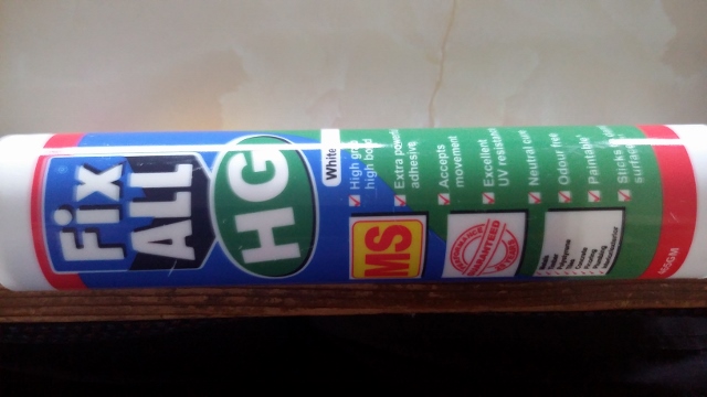

Postby Sheddie » Sat Dec 27, 2014 10:03 pm
Hi Marcus,
I hope you have had a wonderful Christmas, and that the new year treats you and your loved ones well.
How is progress on the build, we must be due for some updates? :pictures:
As I mentioned on the photo, the adhesive we used wax Holdfast Fix All HG. It was the one that Ullrich recommended for the job. As well as an adhesive it is a good gap sealer.
2014-12-28 15.22.42 (640x360).jpg (118.45 KiB) Viewed 1315 times
