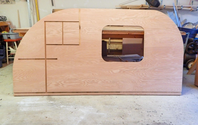

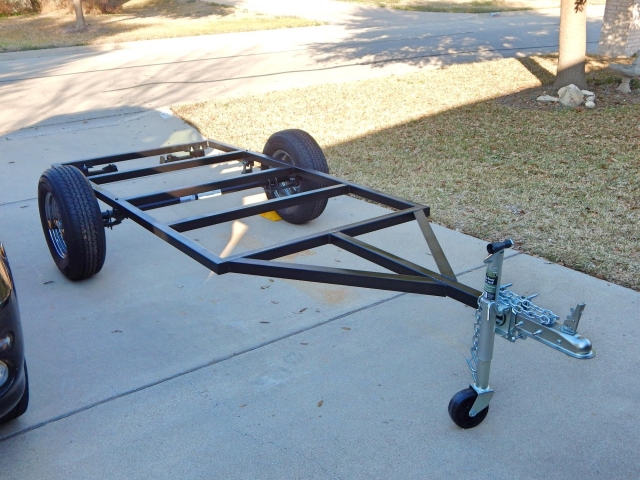

Well, I built another one. This one took 37 days from start to finish. I fabricated the frame from 2x2 square tubing. I decided to go with 14" wheels instead of the 12" I used on my previous builds.
I used my router to cut the Dado joints for the bulkheads and cabinets. First time to try this and it went well. The walls are 3/4" oak plywood.

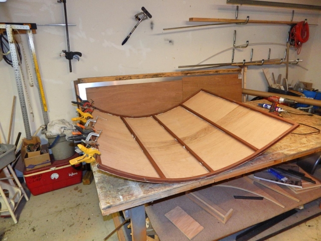

I fabricated the hatch frame from 3/4" square steel tubing. This made for a light weight yet rigid hatch.

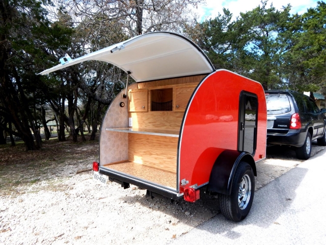

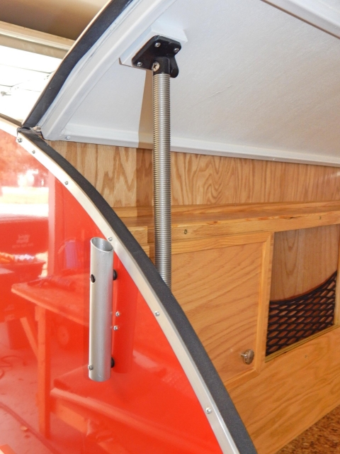

I used this spring galley hatch prop from Vintage Technologies. Works well and is easy to install.
We went for a simple galley layout on this build. Still has lots of room to store stuff.

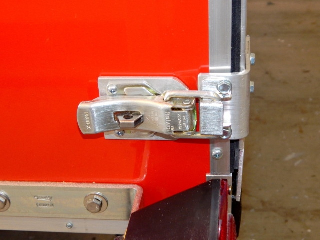

I used these draw tight latches from McMaster Carr for a tight seal on the galley hatch.

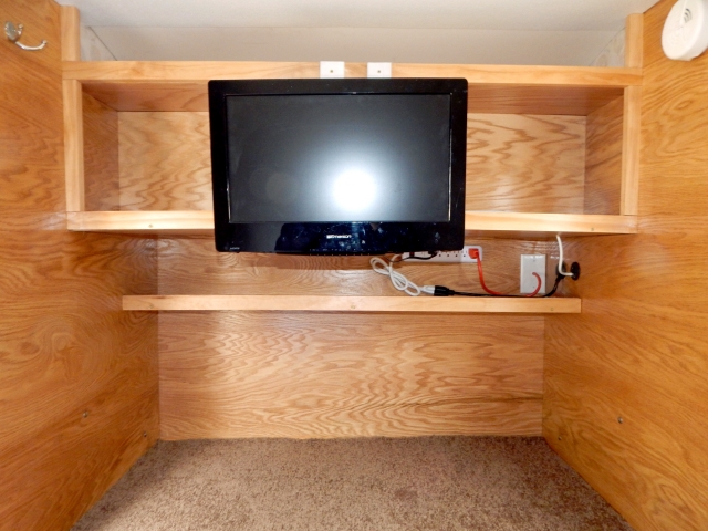

Here's a shot of the simple interior cabinet layout and electrical setup.

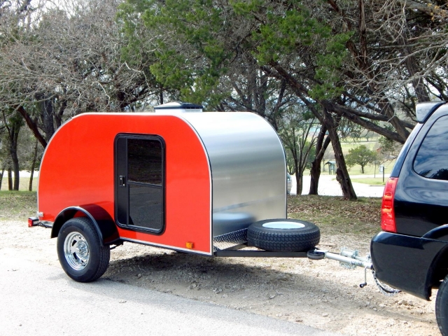

And...here's the finished product out for its first test tow. The pre-painted red aluminum really attracts attention.

Looks nice and tidy. What is the tube sleeve mounted to the side wall outside of the galley prop? Kind of looks like a flag staff holder. I'm guessing some sort of canopy leg support. :thinking:
Re: Little Red Benroy
Postby TxDave » Thu Mar 19, 2015 12:25 am
Pete...it weighs 902 pounds.
KCStudly...that's a mount for my self-designed high-def TV antenna.
