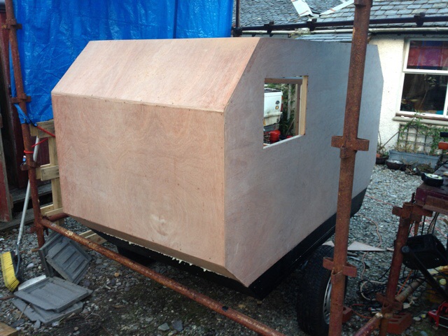

Hi, I'm building a camper for my sister to replace the teardrop she had which had suffered serious water ingress leading to terminal rot. We dismantled it with a chainsaw and saved the Alko chassis for re-use. The new trailer is to be as simple and as light as can be. I have experience of building in plywood on softwood so that's the method I've adopted. The shape is octagonal and very reminiscent of the Victory V lozenge, hence the name, Jackie's lozenge camper. I have put up some early pictures into an album. Can somebody tell me how to get them to display on this thread please. Kind regards, K33F

Postby keeflester » Mon Apr 20, 2015 11:38 am
130867
Main structure and framework from 26x33mm softwood on a 12mm marine ply base tub.

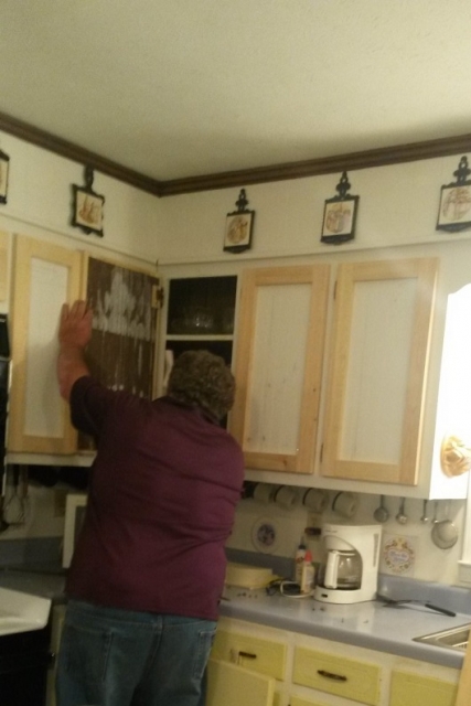

Well I have been banging together wood for about 5 decades. I never used a pocket hole jig in my entire 64 years. This weekend I built 11 cabinet door fronts for my 86 year old mother. That's 88 holes and 88 screws to make the picture frames. I then added a bead board panel inside of the frame. I was well pleased with the results. If you are looking for a present for yourself or the craftsman in your life I can very highly recommend this style of tool. I purchased the harbor freight all aluminum pocket hole jig but did purchase the Kreg style pocket screws. This tool in my opinion is the greatest thing since sliced bread.
