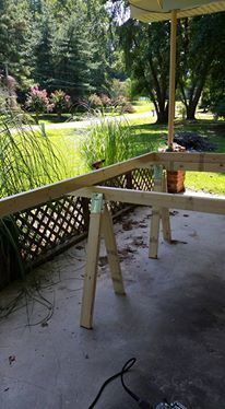

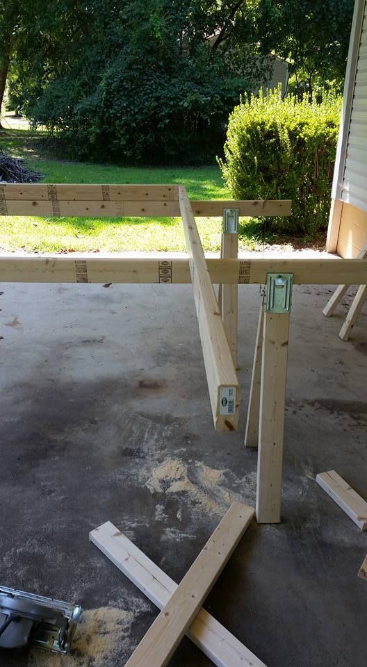

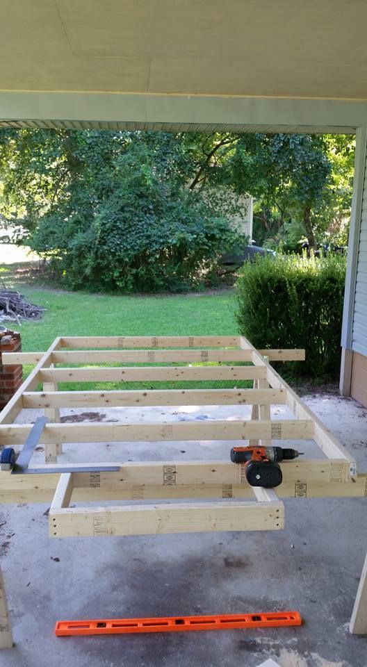

Postby Albuoy » Mon Aug 17, 2015 8:13 am

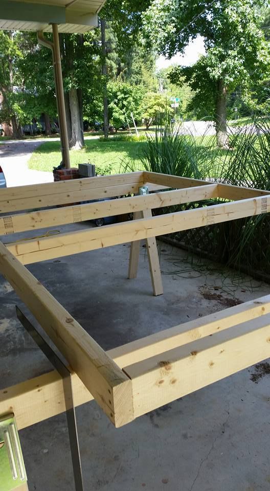

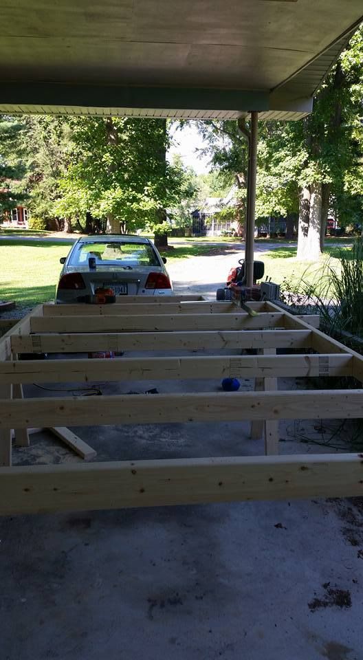

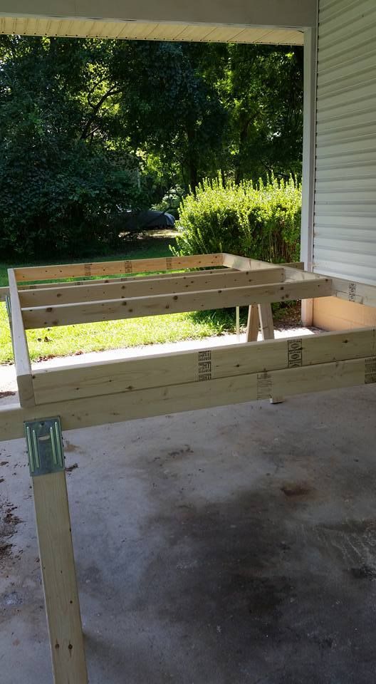

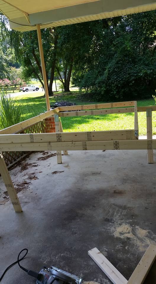

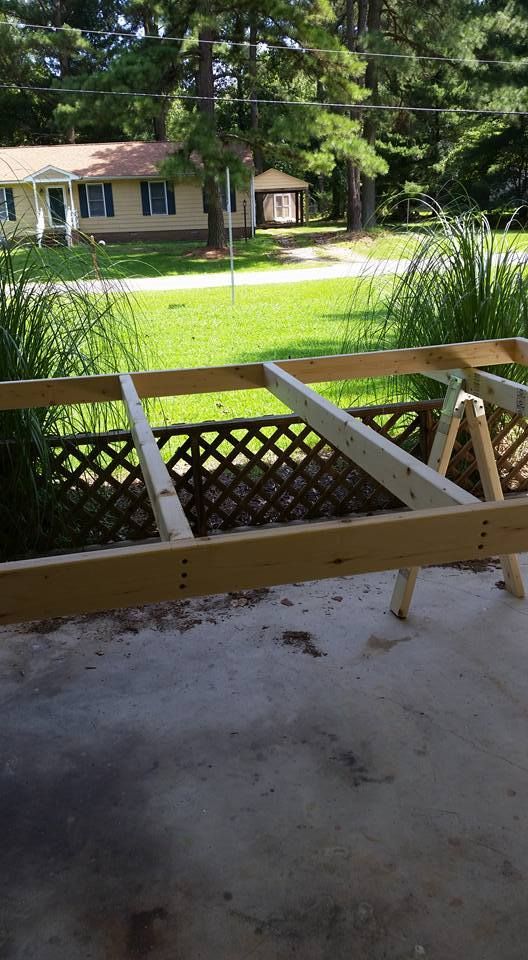

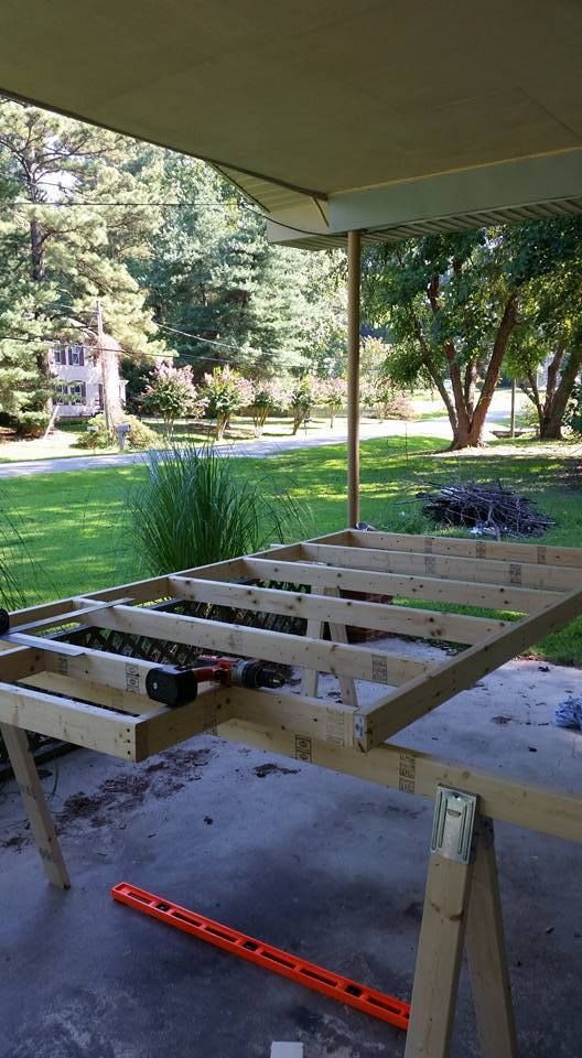

Any and all criticism/thoughts are welcome
I only had enough time for this this weekend. But I layed out the frame, and decided to add a box on the front to install the A/C unit, that way I can coat it with roofing tar, and let the condensation drip to the ground instead of inside the trailer and having to worry about rot and draining.

Postby KCStudly » Mon Aug 17, 2015 5:23 pm
Making the decision to build and jumping in is a big step. Congratulations on that. :thumbsup:
Suggestions: Do a lot more research before you go any further. 2x4 construction is starting off on the wrong step toward an overly heavy build. The appeal of cheap stud lumber is hard to get past at first, and we are all familiar with it, but if there is anyway that you can switch to 1x's or rip down those 2x's you will be happier in the end. The weight starts adding up from the very beginning and it is far harder to shed weight in the end than it is to start thinking lighter from the beginning. Think airplane not house (... or tank). The unity of the whole cabin assembly will provide more than enough strength to your build w/o any need to go so heavy.
Also, I don't see any sign of a trailer there. It is advisable to have the trailer in hand to confirm dimensions and fit as you go. You don't necessarily have to build on the trailer (I'm not), but it is a good idea to have it and confirm everything will fit later when the time comes.
From start to finish the amount of time, energy and money invested in these things is not trivial, so be sure you plan well and have a realistic idea of what all is involved.

Postby Albuoy » Mon Aug 17, 2015 9:09 pm
KCStudly wrote:Making the decision to build and jumping in is a big step. Congratulations on that. :thumbsup:
Thanks for the advice!! I figured a good base would support what I was liking to build, from there I was going to go smaller. The trailer it's going on, has 2 inch wide frame, and I wanted it to pair. Especially when bolting to a trailer. With the 1 inch, do you worry about it splitting?
As far as the trailer, it is on backorder at the moment, however I went and measured the trailer and all aspects of it. And put them on my blue print. So I know the measurements are correct.
But this is the exact feedback that I am looking for, and going forward I will definitely take it to heart.

Postby KCStudly » Mon Aug 17, 2015 10:19 pm
Think about it this way; rather than the base supporting the cabin, the cabin stiffens the base. The cabin, being a large box section will be very rigid and stiff, even if built very lightly, because all of the fibers are connected and are spread out over a very larger space. The cabin will be the beam that stiffens the relatively flexible trailer base, not the other way around.
I bet you can lift one corner of your current wood frame and it will give quite a bit before the diagonally opposite corner shifts. This will not be the case once the cabin is formed. So the trailer frame is a relatively 2D structure lacking rigidity in the z-axis, as is your wooden frame. Only when you start building in the vertical axis (up) will you start building rigidity, so it doesn't matter how beef you go at the bottom, all of the strength comes from the depth of the cabin, and it just doesn't need to be that fat. Since the cabin will be so tall, it will have the inherent strength needed even when all of the little composite pieces are relatively light. The strength comes from the geometry of the assembled structure, not any one member.
Read the build threads, read the construction techniques, if you want tips on building lighter there is a lot of good info in the foamie build forum. Take your time, this is a big project and it is better to figure out what not to do before you have already done it. There is a huge wealth of experience here to share and plenty of people who have shared what has worked and what they would have liked to have done differently.
I'm on my first build. The only 2x4's in my build are some small blocks in the floor where the blind nuts are anchored to hold the floor to the frame, and in the doors where they are hogged out for door latches to imbed.
It would be much more efficient to add some extra 1x gusset plates for screws to 1x framing, than it is to build the whole thing from 2x. Sure, it's a few more pieces and a few more joints, but you are building an assembly, not a monolith.

Postby noseoil » Tue Aug 18, 2015 7:51 am
Have to agree with KC on this one. Lighter is better on a small trailer as far as wear & tear on tires & bearings, gas mileage & also cost in general. I work in the construction industry & have applied some of what I've learned to my trailer build.
One example is the floor decking. The usual spacing for roof joists or rafters is 2' on center. Why is this? It's because usually, 1/2" plywood or OSB is used for the deck material. This material needs to be supported every 2' to carry the load from the roofing, wind gusts, snow loads or all of the above while a rather large plumber is tromping on the roof system while carrying his tool box to work on something (apologies to large plumbers everywhere). Since hopefully you aren't having some of these loads on your build, that amount of structure isn't really necessary.
If you use 1x2's laid flat and spaced at 1' on center, you can cut the decking material down to some 1/4" underlayment on top & 1/8" on the bottom, the type sold in home center stores. The 1x2's must be clear lumber or they can break at a knot (I used 3/4" poplar ripped on a table saw), but this floor system is plenty strong enough to hold a mattress while you sleep on it without any problems. Glue up this kind of panel & it will be light & strong!
Sorry to second guess your build so early in the process, but it might save you some weight in the future. Best, tim

Postby Albuoy » Tue Aug 18, 2015 10:37 pm
Don't apologize for the advice, believe me it is all being taken in. I have looked through several builds, and seen things that I would like to do, and some I've decided to stay away from.
Me personally, I am a fan of 2x4 when it comes to support. However I realize now the aspects of the cabin as a whole supporting the frame. This was the only 2x4's I had in my design bluprint. As far as lifting the frame, there is very little if any give. Believe me this is built solid. Unfortunately I am very limited on tools, so I am unable to run things through a tablesaw.
I do want the advice of the members on this board, as when it comes to the electrical, I have great ideas, but don't exactly know how to put it together.
