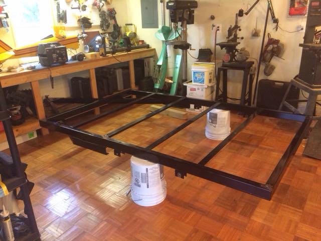

This evening marks the beginning of construction of my 5W x 8L x 4.5H teardrop. I've been drafting plans and storing up supplies for weeks, and the time has finally come!
I'll be building in somewhat of a cramped space, but it will be dry and warm.
The wheels/axles have been removed, and the chassis is on buckets.

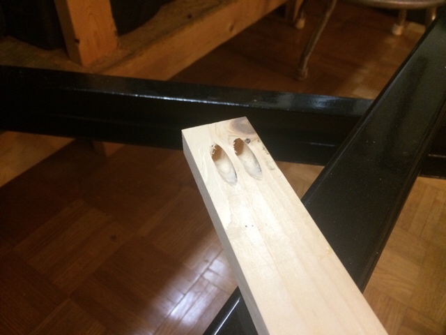

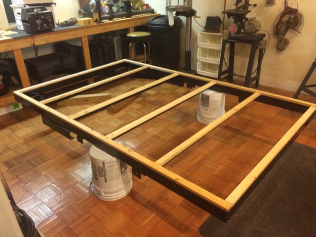

Using a Kreg jig, I cut and joined floor framing that will be sandwiched between two layers of birch ply later.

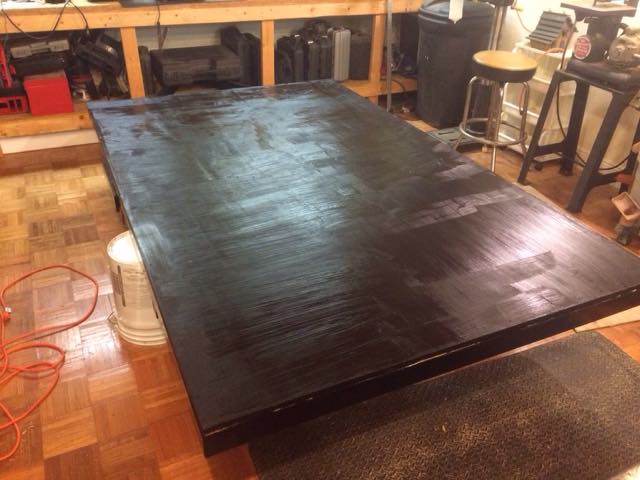

Last night was my last bit of work on the TD for a few days. Asphalt coating for underneath went down. Now, just waiting for it to set up and off gas before I resume.
