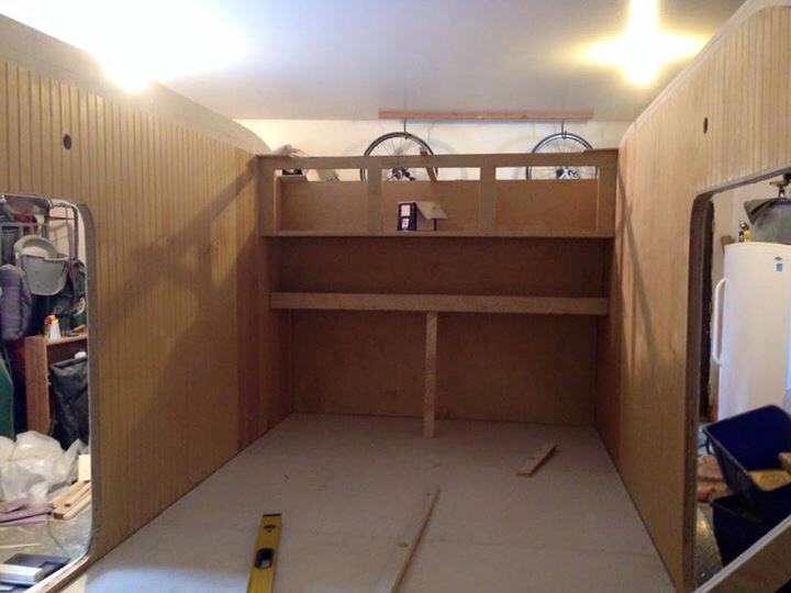

Removable Benroy
Trailer, 5x10 utility trailer, 3500 lb axle, removable sides, tailgate. 15" wheels, stakeside. 745 lbs empty.
5x4'2x10'6" Benroy box. 71" +/- ground to roof top. Plus fantastic fan height. Tow vehicle is 72" +/- high.
Pl glue. (Yuck)
Floor weight-136 lbs. 1/4" bb, 1x frame, 3/4" pink insulation.
Each side weight-64 lbs. 3/4" df 3/4 ac ply, skeletonized, 3/4" pink foam, 1/4 birch bead board inside, 1/4" bb outer.
Rear cabinet weight-84 lbs. 3/4" birch ply, biscuits.
Roof weight-88 lbs. 1/8" bb inner, 1x2 spars, 1/8" and 1/4" outer, foil bead board foam.
Rear hatch weight- 68 lbs.
Both doors- 50 lbs.
76 pounds in 6 oz fiberglass, epoxy, outer skin tieing sides/top into one unit.
Approximate box weight is 631 pounds empty.
Rustoleum exterior paint, plain satin varithane inside.
Bought doors, 30"x36". Yes, oversized. :)

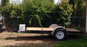

Basic trailer

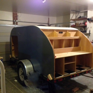

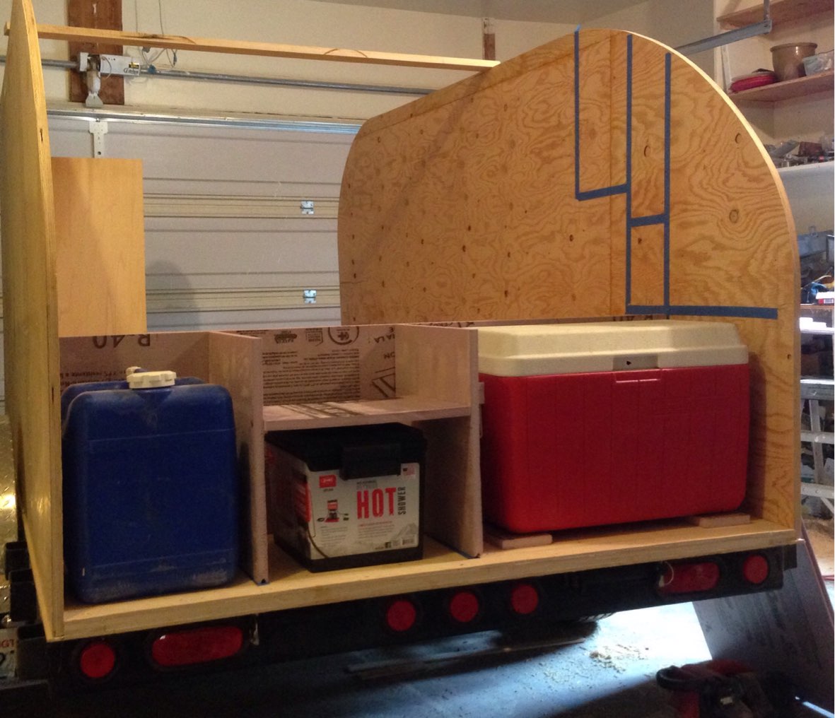

Various pictures

Postby noseoil » Tue Jan 26, 2016 7:53 am
Looks nice, I like the frame, plenty stout. Also looks like it might tip the scales at about 1500# when finished, depending on the "extra" stuff (battery, etc .). Keep posting progress pictures!

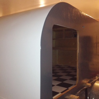

Postby fourbtgait » Tue Jan 26, 2016 11:04 pm
Seems to take forever to build and ours is not intricate. Life intrudes. Started last mid October, had hoped to be farther along. But marriage, weight training and cardio get in the way. Plus a regular job.
But tonight installed the roof fan and box flooring.
It is 10' overall simply so the lab has the front floor to sleep on, no dogs in a bed.
Sides are a close match to Toyota magnetic grey. Roof is white.
