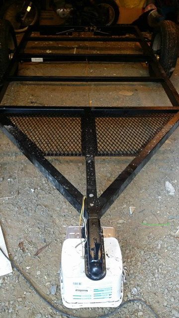

Sold off our Coleman Cheyenne and downsized... We purchased a 5x8 kit last year and after much procrastination I have started the process of building it :thumbsup:

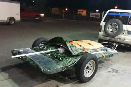

Picking up our kit and driving home
The frame

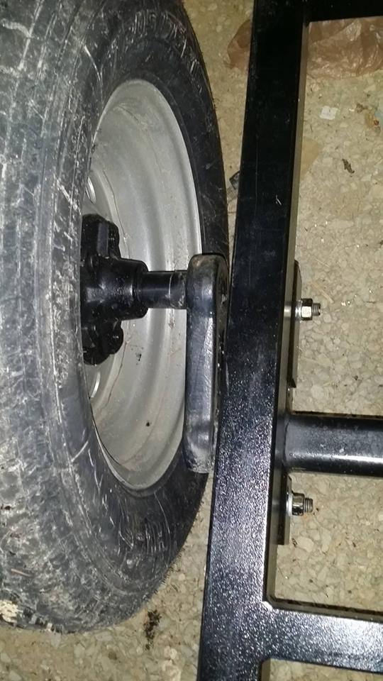

Dexter axel

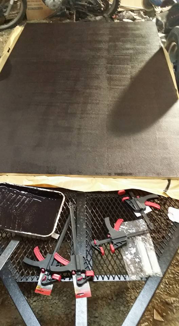

Originally tried to use a glue on mesh fabric for a vapor barrier, discovered it was NOT water proof... Removed!
Painted bottom with a Henry's roof seal product and then flipped it over to be attached to frame

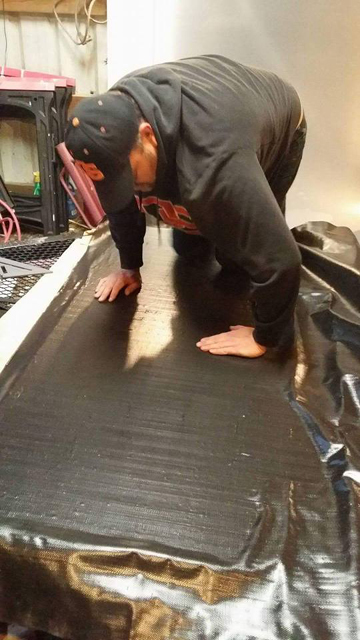

The original vapor barrier was intended to wrap up the edges of the siding under the aluminum... I Used a water proof flashing tape. I placed the tape on the frame with the sticky side up and laid the floor down on it allowing 3 inches of the tape to extend past the plywood. Before I attach the aluminum siding I will wrap the tape up and seal the joint where the floor and side walls connect. :twisted:

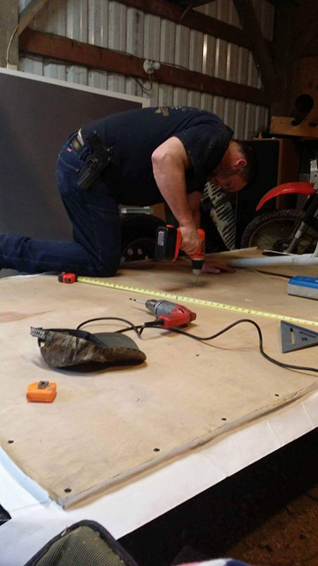

Screwing the floor to the trailer frame. I left the peel off backing attached to the exposed flashing tape to keep it clean and free of debris until I am ready to stick it to the side walls

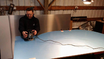

Now to trim the aluminum sheeting to match the side walls and door cut outs... Then Install the walls :thumbsup:
Sawhorses, clamps and a router... Perfect fitting aluminum

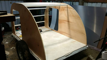

Glued and screwed one sidewall on...

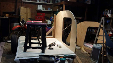

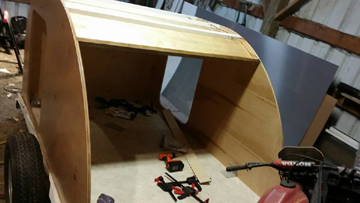

Then the other wall, with the crossmember spars glued and screwed in place

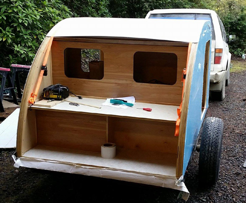

Postby SPLAT » Mon Jan 25, 2016 2:30 am

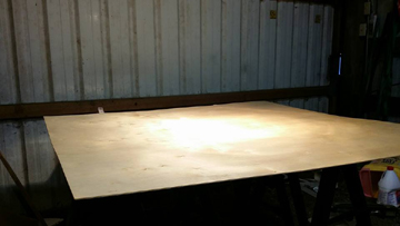

Treating the interior ceiling wood with two coats of varathane... 2 peaces x 2 coats per side x 2 hour dry time between coats = a LONG day :SH
But it had to be done and looks really nice now.
Watching paint dry...

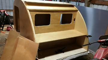

Attaching the ceiling...It should have been a simple task, but it was difficult to get the two sheets aligned. There may or maynot have been some minor profanity, a dozen clamps, 2 trips to the hardware store and lots of help from the wife :)
Now we are ready to assemble the cabinets. Glad I did a test fit, a few of the panels were a little to wide.

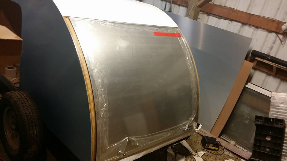

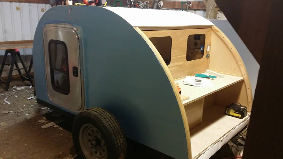

Test fitting the hatch to make sure the curves match :thinking:
Hatch fit check
Pretty close to perfect :thumbsup:

Looks nice. What size router bit and how fast was it turning to trim the aluminum?
