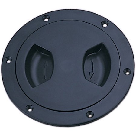

Nice build. How about using one of these for the trim ring. You can keep the cover on while you are traveling for a rock guard. I have used them for cheap skylights in food trailers. It is an 8 inch inspection plate for a deck. Trim ring on the inside and outside. About 12.00.

Postby Dan242 » Sun May 14, 2017 9:26 am
Thanks, Looks like a viable option
