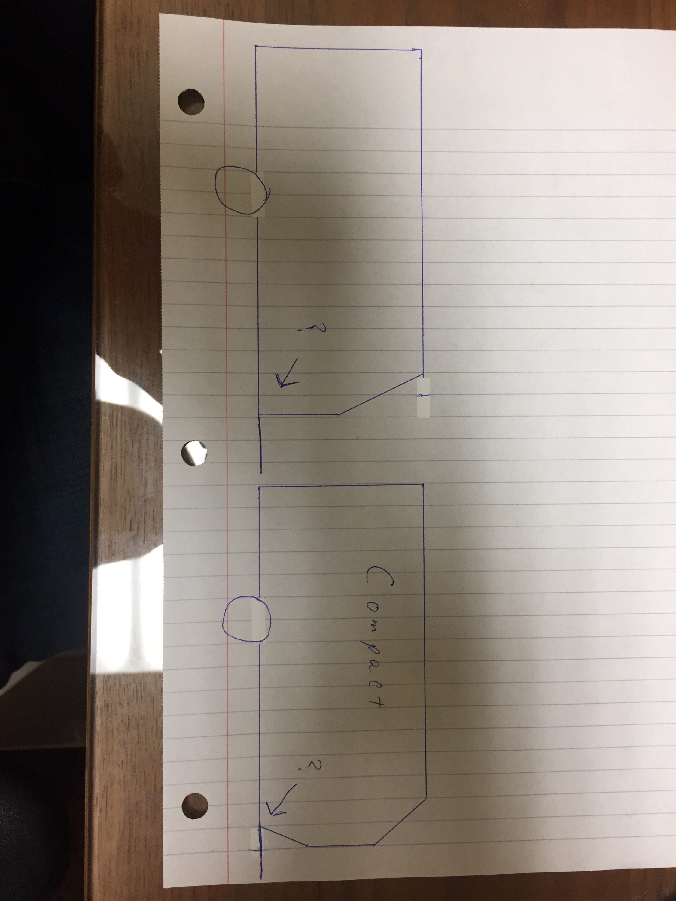

I have began to build an extended Foamie Compact based on the plans in the Design Library.
I've had a HF for a few years, but I just extended it 3' by using the center support beams. I also added 2 wooden support beams due to the added length.
Here come the questions....
I started to build my floor 12" over the "A" portion of the frame but now I am thinking that is a bad idea. I basically just squared off the bottom slope using a 2x6 as a support.
I am thinking of cutting off 8" of floor and getting rid of the 2x6. Thoughts?? :worship: :NC :thinking:

Postby ChefConroy » Fri Mar 24, 2017 4:02 pm
Hard to see because the tarp is in the way, but I have the bow cantilevered over the tongue by about 12" like in your one drawing.
It cost me some turn radius, but nothing bad. I had to move Camper about 30miles south to finish the build because reasons, and it pulled just fine.
A little light on the wheels, but that was before the approx 200# hatch was installed.
