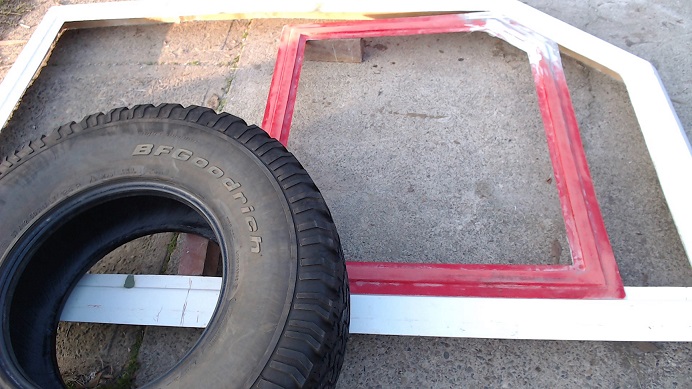

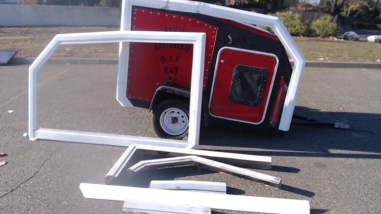

I should have been clearer. Plan to build in under 50 hrs. This from of building uses a fiberglass skeleton frame. No wood .When using wood at some point you will have to glue, nail are screw into the end grain. Then add an alum. Cap that has memory and try to return back flat. It will be puling at any fasters that may being used. Wood get wet just from the water in the air. When it gets cold. In the picture the new outer ring .Was cut and laid up in 4hr and 12 minutes. For the left and right side. Used two envelopes and a cutting stick. DO NOT USE BODY FILLER AS SOME HAVE SUJESTED WILL FALL OUT AT SOME POINT .This form of building with fiberglass has been around for over 70 years are more Not in the last few years as some have claimed .155752

How fast a 2400mm long 1375 high under two hours over four days to do outer rings

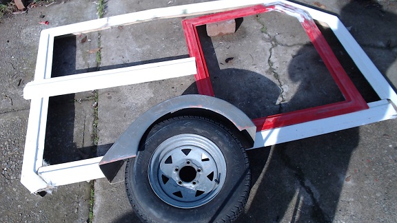

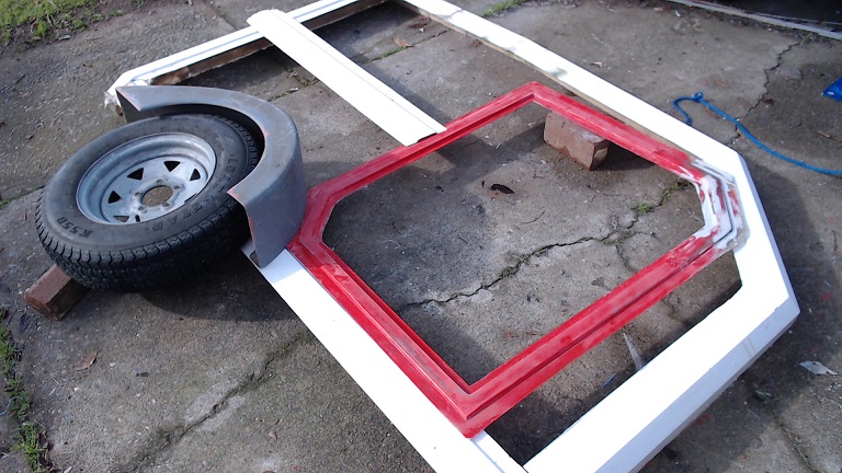

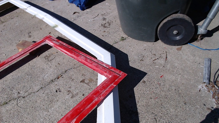

Finley received my door jams. There designed to fit the frame profile. That way different accents can be added. They were designed for a 5 by 5 by 10 feet long off-road trailer with pop up roof. Sadly the side panels were removed stolen. Set the cash back some. So now building a 7 foot sleeper/weekender To make the doors fit will angle the top and bottom near the fenders. Cannot move the axle back 60 /40 rule. This way of building can be done with a few hours of work and last for a 100 years or more. If you plan to try this No big investment in tools $20.00 U.S . Cannot make a mistake .Should be able to have your local fiberglass shop modify a excising tooling. Received some hate .Not the one that is trying to get $35.00 a running foot. Cost should not be more than $10.00 a running foot
Finley a reçu mes embouteillages. Là conçu pour adapter le profil de cadre. De cette façon, différents accents peuvent être ajoutés. Ils ont été conçus pour une remorque tout-terrain de 5 x 5 x 10 pieds avec toit ouvrant. Malheureusement, les panneaux latéraux ont été volés. Définissez la remise en argent. Alors maintenant, construire un dormeur / weekender de 7 pieds
Pour adapter les portes va incliner le haut et le bas près des ailes. Impossible de reculer la règle des essieux 60/40. Cette façon de construire peut se faire en quelques heures et durer 100 ans ou plus.
Si vous envisagez d’essayer cela Pas d’investissement important dans les outils 20,00 $ US. Vous ne pouvez pas vous tromper. Vous devriez pouvoir demander à votre magasin de fibre de verre de modifier un outil d’excision. Reçu de la haine. Pas celui qui essaie d'obtenir 35,00 $ le pied en cours d'exécution. Le coût ne devrait pas dépasser 10,00 $ le pied

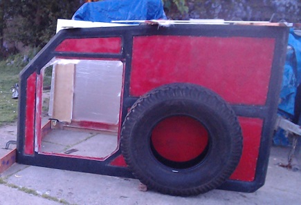

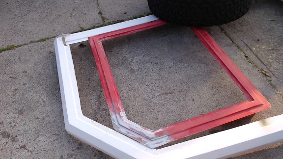

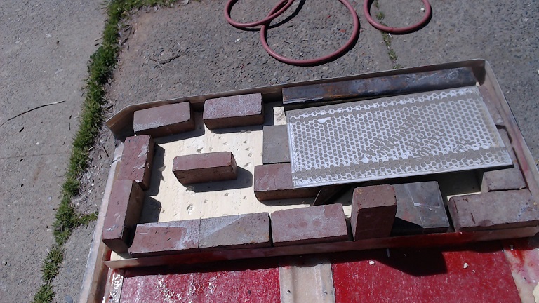

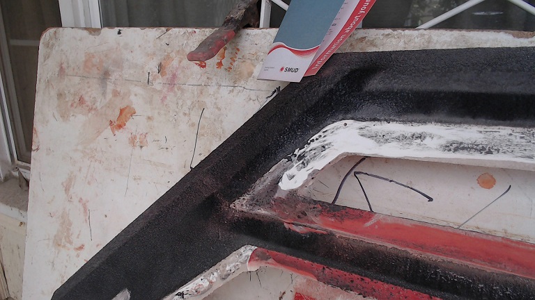

Had to trim the doors down. So thought was to cut corners .If was to do over .Would cut narrower and eat more rabbet food. As one corner is finished will pull a plaster of pairs tooling .
Picture 438.jpg (112.64 KiB) Viewed 8763 times
Will make the last three corners so all will be the same .Then bond in . Two side doors

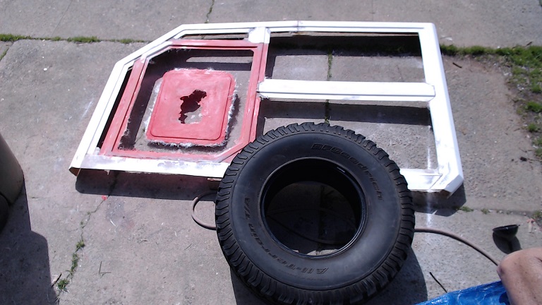

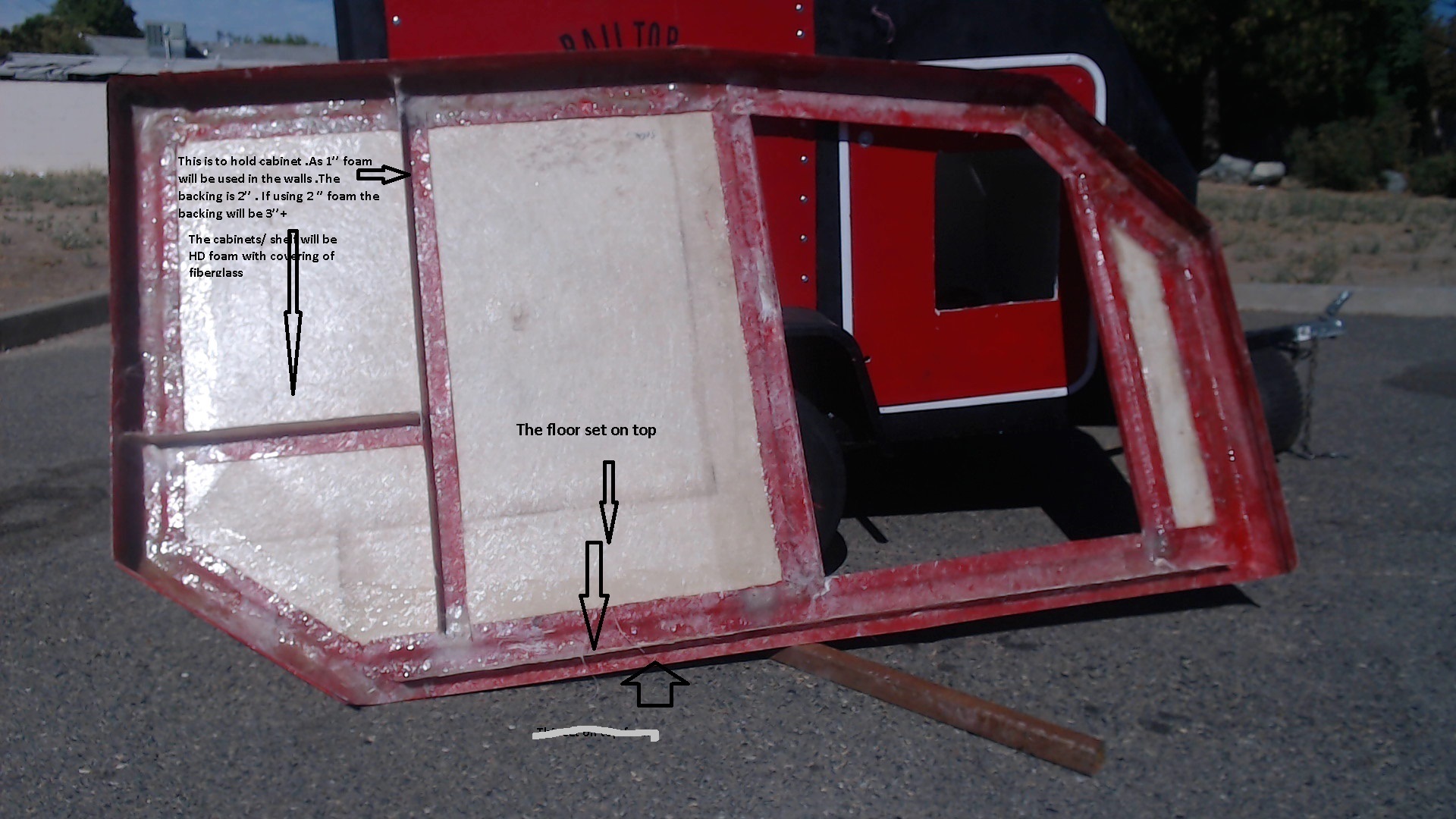

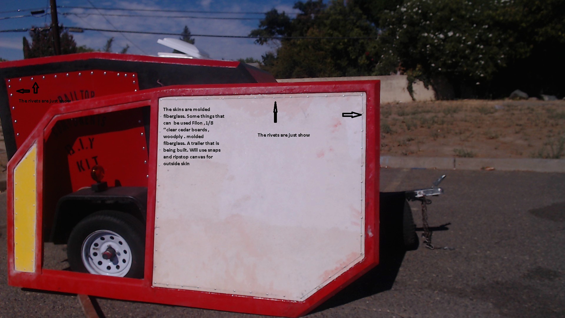

.Now I have the doors trimmed in the corners .Need this profile so could use back center spacer. Spacer is to build an 5 feet wide using 4 foot material on top. Now can have fiberglass on the bottom wood on top thinking 1/8 Cherry are ash striped planking. All fiberglass is hand laid NO chopper gun S****
Off-road plate bottom fiberglass on top
Picture 445.jpg (86.58 KiB) Viewed 8722 times
Picture 446.jpg (97.71 KiB) Viewed 8722 times

Postby twisted lines » Sun Mar 17, 2019 2:48 pm
I had a decision made for my fenders, but after looking a long time at yours I am undecided again 8)
Racking up; And Rapin foam
twisted lines
Posts: 1243
Location: Jefferson
Re: 50 HR. Build 4.5 by 8' using Railtop fiberglass Componen
Postby saywhatthat » Mon Mar 18, 2019 3:12 pm
quote="twisted lines"]I had a decision made for my fenders, but after looking a long time at yours I am undecided again 8)[/quote]

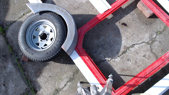

I preferred these there finished around the edges that helps make them stronger .Seen some that had smaller side walls straight cut opening near the tires asking $4oo. a set. Received for $236 US. The tooling is up for sale. Been informed they were made for 12'' wheels. With high side walls take up some space on teardrops built with HF trailers. I have had 205 13'' tires no problems

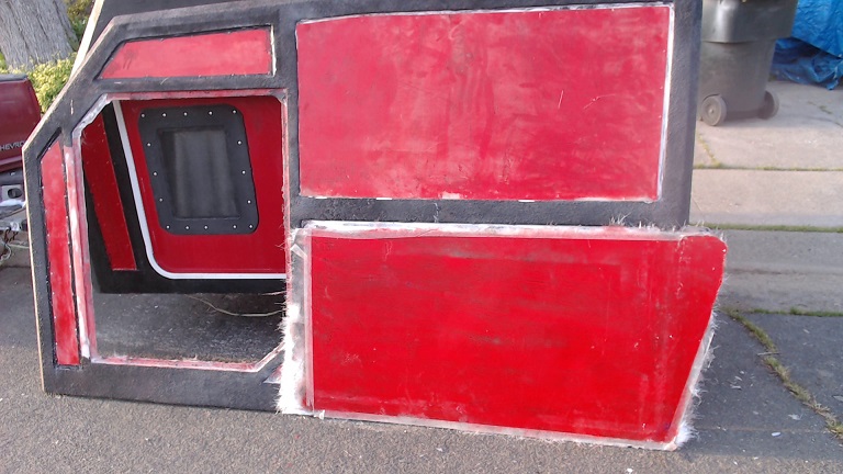

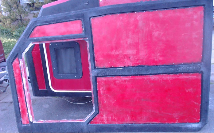

Made all outer skins under 3 hr. over 4 days Used old window glass. spent 30 mi trimming 3 panels in stalled 2

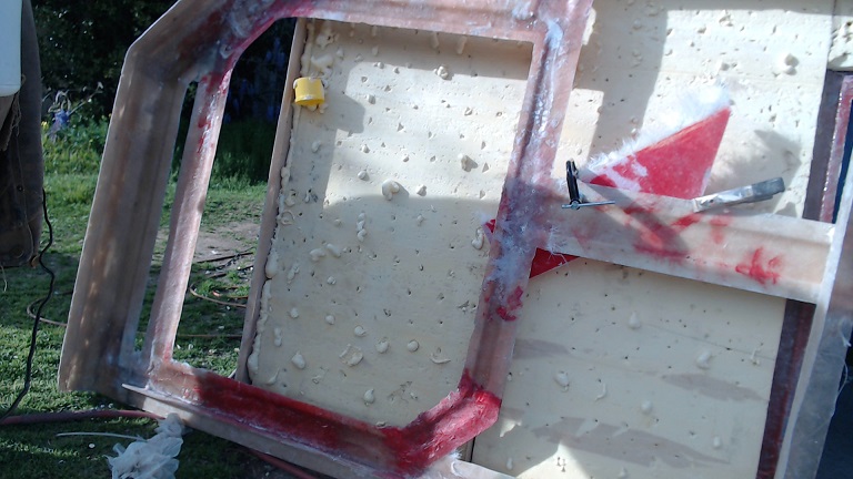

Now to the hardest part adding can foam . Easy to over back fill

Yesterday warmed up .Spent under an hour installing the skins on the left side (in red)
Pocked holes in foam so can back filled with can foam. Glued in.
Today back filled left side with can foam installed two layers of fiberglass on the inside left and right .Cut foam and pocked holds for floor under 70 minutes
