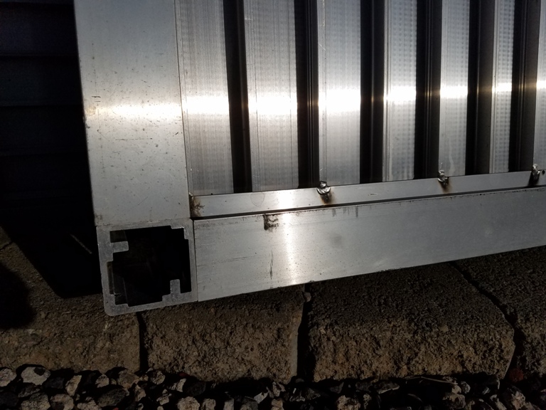

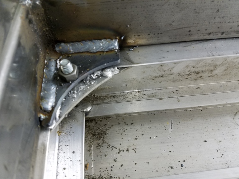

My frame to floor has a security of 6 bolts to attach, but I have heard of this attaching method of gluing other projects; the tensile, shear specs in details are all Greek to me but have read several examples where no bolting required, I wouldn't be comfortable doing that. I figure I have 832" of area that can be glued and this is my number one pick at this time. I am confident the glue would be far stronger then the bolts and it will make a very strong and ridged base to build up. I believe ridged will be good?
https://www.bostik.com/australia/Bostik ... _ISR_70-03
Racking up; And Rapin foam
twisted lines
Posts: 1243
Location: Jefferson
Re: HandiCramper
Postby tony.latham » Sun Dec 30, 2018 1:06 pm
You will be gluing to the paint and thus relying on the paint's bond to the steel, not the strength of the glue. :frightened:
Six 3/8" bolts won't fail. :thumbsup:
Re: HandiCramper
Postby twisted lines » Sun Dec 30, 2018 1:18 pm
I totally understand and appreciate your concern. No, bare steel to a shiny aluminum surface, here are the extra bolted connections that wont be seen again until I am ready to permanently join the two. I guess I can easily drill the holes to 3/8" :lol:

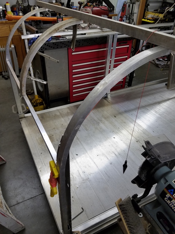

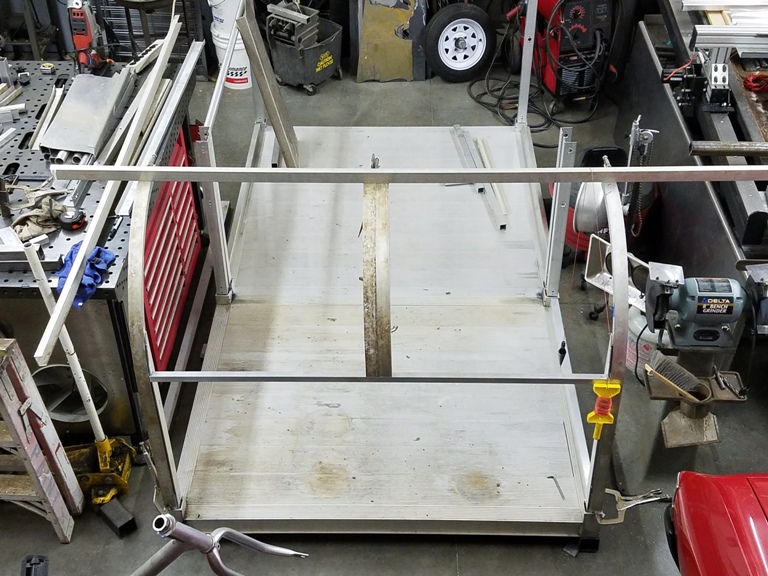

Postby twisted lines » Sun Dec 30, 2018 1:57 pm
And here are the obligatory Messy shop Pictures, With a little spare wheel, tire and spindal from a long gone boat that started this project,
and I won't be using it. :lol:
Mock up of front 20* radius 4' off floor with old crusty stuff that was hidden somewhere. And quickly determining I don't have enough clamps.

Did some Calculator math because I suck at that too, I will leave the bolts in place and 5/16" alone! The shear stress with the glue-able area mentioned previously 832 inches on the trailer frame and the glues 2.5 MPa Using a internet calculator & enter says 301184 PSI Yes when I said permanent I was serious! here is the calculator.
https://www.westyorkssteel.com/technica ... alculator/
twisted lines
Posts: 1243
Location: Jefferson
Re: HandiCramper
Postby Pmullen503 » Sun Dec 30, 2018 5:41 pm
Spend a little time reading up on galvanic corrosion between dissimilar metals. There are some simple things you can do to reduce or prevent it. Make sure you can at least easily inspect or replace the frame to body bolts.
