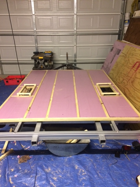

I used pressure treated 2x2s to give some space for the insulation. The original camper just had the 1/4" plywood secured directly to the trailer frame. I'm a little concerned that if I overbuild compared to the original design I'll quickly exceed the axel weight. I did rough out an estimated weight accounting for all the linear feet of lumber and square feet of plywood, plus insulation and such. I think I'll be good but will have to weight the trailer periodically during the build to be sure.
Here's a shot of the 2x2 subfloor frame and the insulation installed. I extended the length of the trailer by 3" on the front and back bringing it to a total of 99" long. This was to fit a twin bed and a full bed. The original beds were the same size front and rear and were 48" wide by 72" long (long ways running from the curb side of the trailer to the street side and wide running from the front of the trailer to the back).

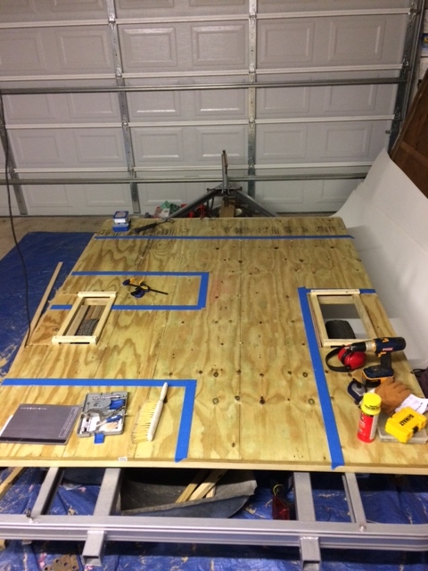

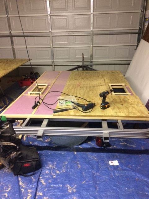

Half the floor installed above. I went with 3/4" ply even though I wanted to use 1/2". The thinnest they sold pressure treated ply was in 3/4" so it's overkill which is bad for weight. After reading a lot about the mix and whether to treat one or both sides of the floor, I went with pressure treated 2x2s for the frame and pressure treated ply for the base. It'll only get exposed to humidity in the air and some road spray when we drive in the rain. I'm a little worried about water getting trapped between the insulation and the ply wood. I'm going to seal any gaps in the insulation with expanding foam so it should be nearly water tight from road spray. Any thoughts??
And now the floor completely installed and I taped out the planned layout as well (dinette is oriented left to right in the bottom left corner. Storage bench in the bottom right corner, kitchen area across the front wall.
