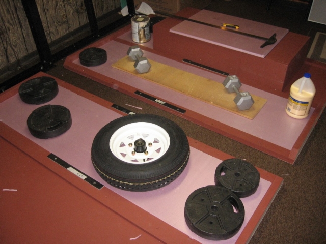

Postby EZ » Sat Jun 22, 2019 3:47 pm
Built a 8' X 5 1/2' base on a Harbor Freight trailer. I used 1 X 3's on their side and it allowed enough clearance over the tire to not require wheel wells. Ditch the HF fenders. Use 5/8" ply for the floor, paint the bottom (and top) with a couple coats of good 100% latex house paint for protection. You can add insulation to the bottom (glued with Locktite PL300 foamboard glue in caulk tubes - strong stuff!) and just leave it open on the bottom; they have been building campers that way for decades with insulation not nearly as tough as the pink stuff we have access to (3/4"). A 1 X 3 frame with plywood is supper strong and rigid, especially when bolted to a steel trailer frame.
Just my suggestion.......
Floor for new standie build in progress:
Good idea painting the trailer. I have one that I use to haul stuff and it is pink after less than 2 years.......
