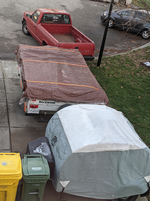

Hey Everyone, I've been reading these forums for about 3 years. I was looking to start my first build about 2 years ago when I found a really good deal on a 5x8 silver shadow and bought that instead. Now that my daughter is 3 its just too small for the three of us. So back to building my own.

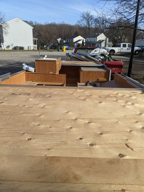

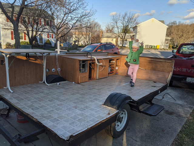

I purchased a 2006 popup (I know, I've read most of your thoughts on popup frames) for $350. I was willing to pay that much because I could easily sell the appliances in it. So, in the end I made money on the frame. The axel on this trailer is 2700lbs and set back, not in the middle. It took me two days to strip the camper down to the frame and two full truck load to the dump.

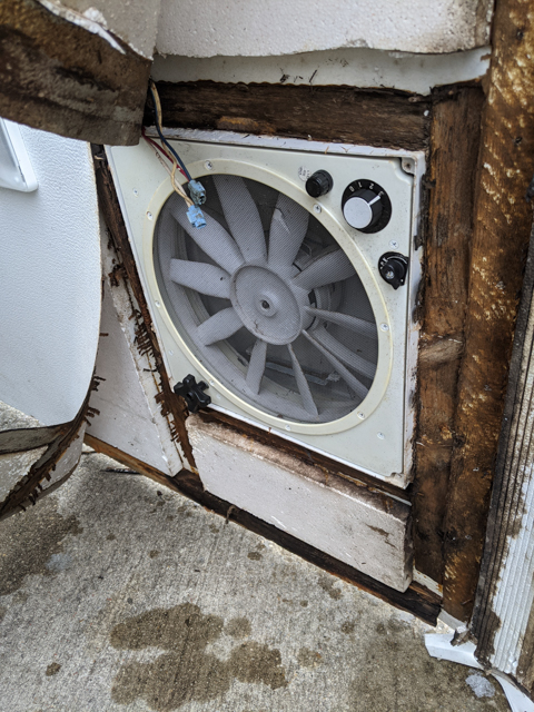

There is alot of things I was able to save and plan to reuse, but these are the main two items that will save me some money.

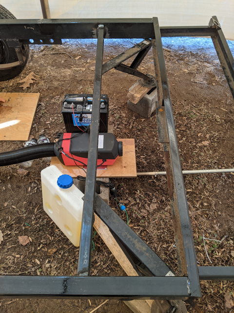

The Frame:

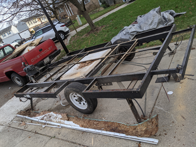

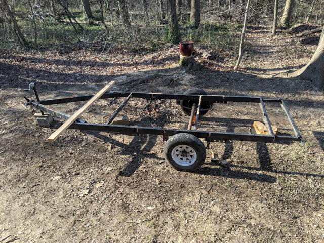

The frame on this pop up is heavy... the popup was around 3000lbs with a tongue weight of around 400lbs. I tried to weight it once I removed the popup by putting a scale under the one tire and multiplying that by two and adding the tongue weight. It came to just over 500, not ideal. So I started cutting things off I don't need. The first thing I removed was a 1/4" steel plate on the tongue that was a mount for the electric host for the popup. about 25lbs. Then I cut off all the sides, this camper was 7' wide and the outter beams are 2x4" C channel. I haven't weighed all that yet, but its getting lighter. I'm doing a drop floor, so I am keeping two metal joists, one on each side of the drop foor.

Postby DaddyJeep » Wed Feb 03, 2021 8:41 am
I can't tell because of that piece of lumber, but did you completely remove that front piece? I am worried that you may have got a little carried away and removed all of the strength in the frame.

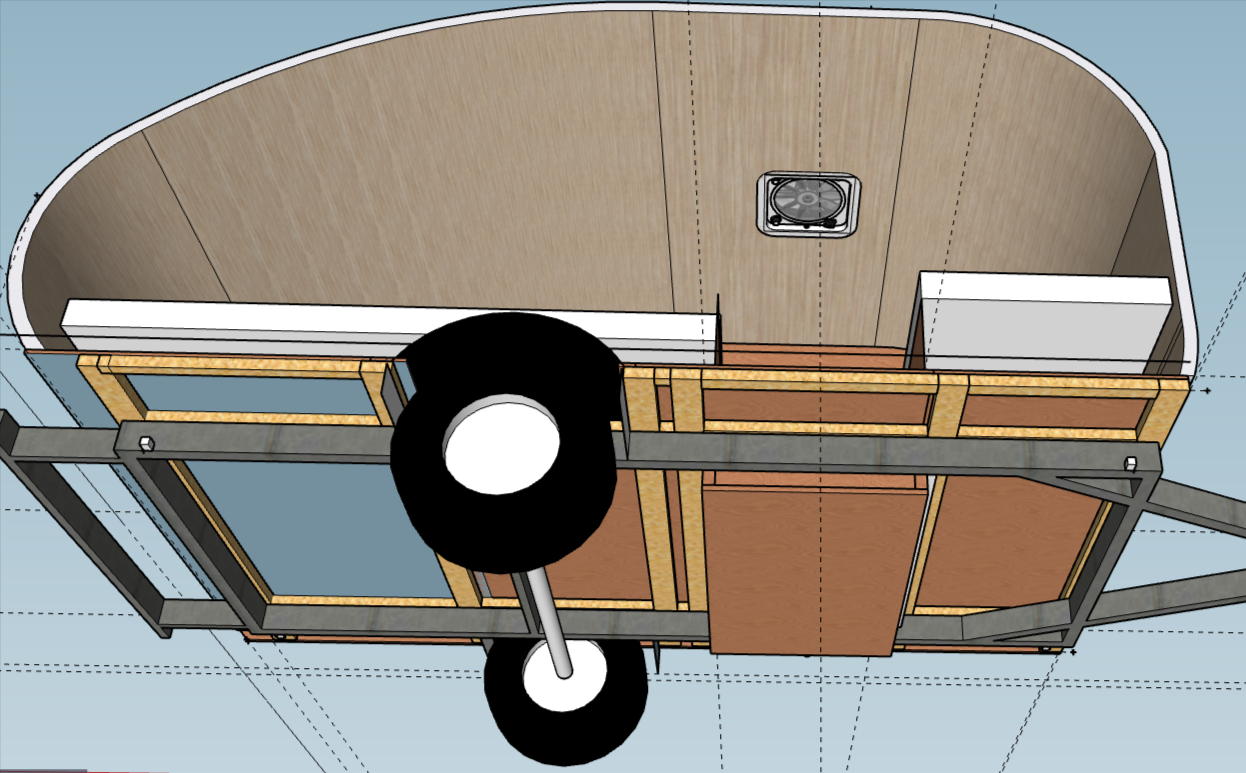

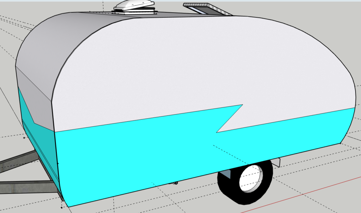

I've been working with SketchUp and this is what I have so far. Ignore the solar panel sticking up on the roof... The front is a XL twin/sofa. The back of the sofa will fold up into a top bunk. The rear bed is a queen that sleeps front to back, that why the trailer is so long, I really didn't want to have to crawl over my wife to get out. Bothe bed platforms are 10" above the floor and the drop floor is 7.5", which should be a nice sitting height. I'm not doing a rear galley, my silver shadow has one and I find we don't use it for its purpose just store junk in it. Instead I'm reusing the popup sliders for a side slide out kitchen towards the back of the entry side of the camper. Most of the storage will be under the beds, with one set of cabinets over our feet on the rear of the camper.

DaddyJeep wrote:I can't tell because of that piece of lumber, but did you completely remove that front piece? I am worried that you may have got a little carried away and removed all of the strength in the frame.
haha, I realize that 2x4 placement is not great... No, I didn't remove the front C channel.
Also, in removing the outer sides of the trailer I had to remove the stabilizer jacks. So I'm taking the trailer to a welder soon to have 45 degree braces welded in the corners for the rear mounts for the jacks.

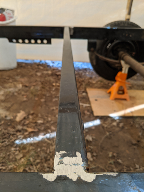

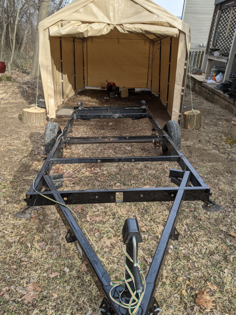

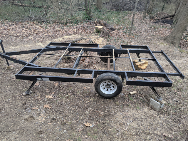

I'm finally done all the cutting and grinding metal. I'm not a fan of the metal work. I just got back from a local welder who welded in some joist I cut out and moved. All I need to do now is sand/wirewheel the frame and paint it, then I can install a floor and it might start to look like a trailer! And yes, this is my garage... At least the snow has finally melted, though its supposed to snow for the next few days again. The diesel heater raises the temp in there about 10 degrees, it would help more, but my yard isn't flat and the rear of the tent has a 6" gap.
