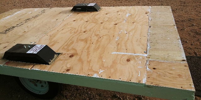

Postby Terra6 » Mon Mar 15, 2021 1:28 am
Taken the typical 4x8 HF trailer and expanded it to 6x10 which i find is a good size for a solo standy trailer. Bumped out the framing by bolting on 2x4 extensions 1 ft on all sides. Did this on a previous build which worked successfully. Managed to cross the country twice in that. :thumbsup: :)
No problems, except for the two flat tires and bent axle.
My recommendation on these trailers, great for occasional and local use, say within the state and couple hour runs. And don't overload these trailers because I've heard that the studs can shear off and send a tire going solo down the highway by itself as seen in the rear view mirror. What a friend told me. Close friend who wouldn't lie about this.
Anything longer or farther, get a trailer with bigger tires.

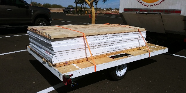

Postby Terra6 » Mon Mar 15, 2021 1:31 am
And a build journey begins with a load of lumber and supplies. :twisted:

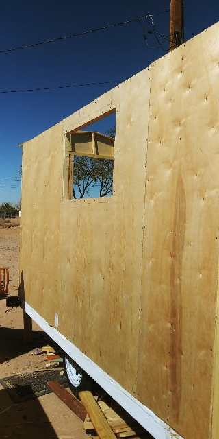

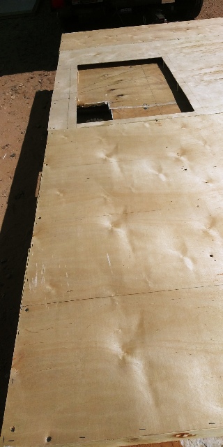

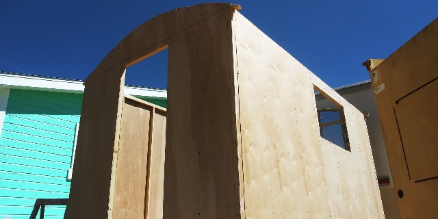

Postby Terra6 » Tue Mar 16, 2021 11:45 pm
Building right along. Another 20 hrs for a 35 hr total to date.
Finalized the interior layout and sourced materials.
Costs- ouch. +$1000. Haven't totaled everything. Afraid too. :cry:
Planned and modified, measured, cut, glued, screwed, stapled, adjusted, assembled, framed, skinned and hammered.
4 walls are framed and skinned, with window cutouts.
Starting to look like it could become something interesting.
Should be able to put up the walls and roof this week.
Yay! :thumbsup: :D

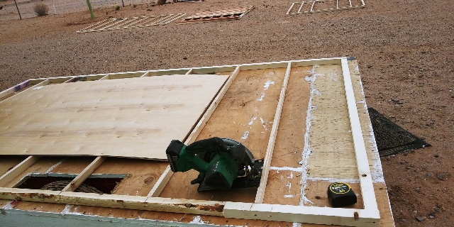

Re: Gypsy Sunshine, a vardo build
Postby Terra6 » Tue Mar 16, 2021 11:50 pm
Tip of the day. How to cut a curve in plywood without using a jigsaw that you don't have? Raise the blade on your circular saw until it barely exceeds the bottom foot plate. Skim cut the curve and it works marvelously with thin plywood. :thumbsup:
Once again, building with a few basic battery powered cordless hand tools. Much is possible with only basics tools and ingenuity. Let's see how this will turn out... :thinking:

My approach due to ABC realities and limitations ( ability, budget and conditions) is always about efficiency and economical. How can it be done simpler or cheaper or more efficient as I go along. Of course some may call it laziness or ineptitude. :lol:
I'll be building this with a cordless impact driver and circular saw basically.
Walls are all up and insulated. Roof put on and stabilizer legs to keep it from rocking. The front tongue jack doesn't inspire solid confidence and so we went with bolted 2x4 with metal foot that swivel into position and up out of the way when on the road. Simply screwed into up position and hidden underneath. $10 solution that's light, cheap and efficient. :thumbsup:

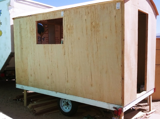

Postby Terra6 » Thu Mar 18, 2021 10:18 pm
It's alive!!
And starting to look like something. :applause: :thumbsup:
A vardo typically has sloped out sides and a seriously curved roof. I'm simplifying with straight box wall configuration and softer roof arc for build simplicity.
Will still look similar but just won't be authentic gypsy vardo.
Don't think anyone will mind.

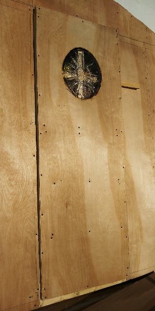

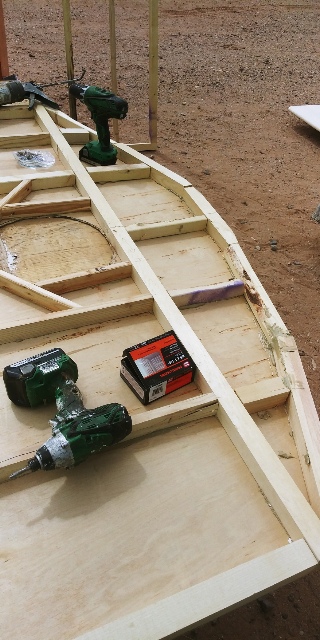

Postby Terra6 » Thu Mar 18, 2021 10:27 pm
My approach on this is light weight. Would have gone XPS but no easy local supply so adapt to SIPS as another option.
Using 2.7 mm luaun with 2x2 and 1x2 framed for walls with 1.5inch EPS. Pretty strong considering once its all assembled glued framed and screwed. :D
With a 10ft span, made my own trusses again using 1x3 and 1x2 glued perpendicular and screwed to strengthen. Cheap lightweight and fairly quick and easy.
Was concerned at first might be too lightweight but now boxed in, will be sturdy fine. :thumbsup:

Postby Terra6 » Mon Mar 22, 2021 10:26 pm
Thx Sharon for the link. :thumbsup:
Luv looking at other builds for ideas and creativity.

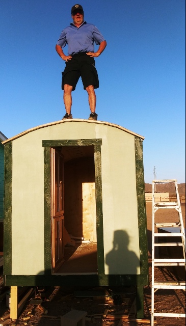

Hammering away at the build. Gettin on it and gettin r dun! :thumbsup: To date have 80 hrs into it and now being at the stage of PMF walls, roof and paneled interior walls with trim.
And ready to finish the interior, going over layout design and placement. Further final paint coats on PMF for final color.

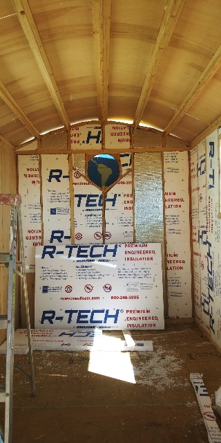

FYI, took me 5 gals of paint for three coats to PMF canvas to ply siding. Approx 200ft2. First coat on surface, coat on canvas, paste together and a third coat over the top to totally seal them together and dry as one piece making sure to do it all as quickly as possible. After this stage, paint goes on smooth and absorbed less as the canvas is already saturated. Will require a few more coats to ensure it's waterproof. Imho, 2 more coats sufficient probably 2 gallons. With mistint paint so cheap, usually buy a 5 gallon bucket at $30 and use all of that up.
Walls insulated and covered inside and out. 1.5 inch Rtech in walls with 2 inch in ceilings giving overall SIPS strength properties. Doubled the luaun on the roof with glue and screw.
With my T truss design, the roof is surprisingly strong with. 2 layers of ply, 1x3 plus 1x2 T, and single inner layer of luaun all glued and screwed. How strong you may ask?
Well I like to stand by my build.
Or more accurately, stand on my build.
A roof truss stress test. :thumbsup: :applause:
I'm still here. :D
