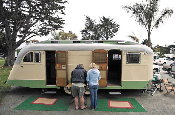

Postby GPW » Wed May 04, 2011 6:38 am
W, that would be easier , and just like the Old timers did it ... they worked it all out long ago ... (the pic ^)

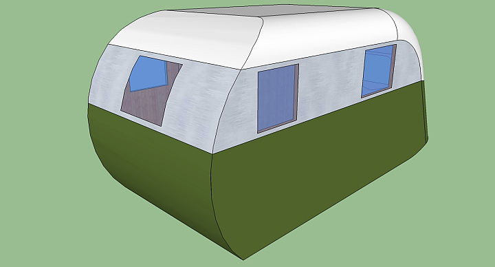

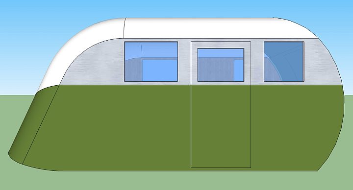

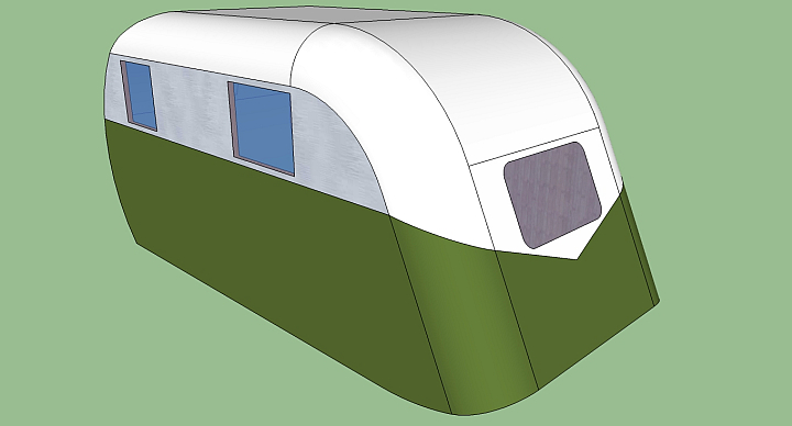

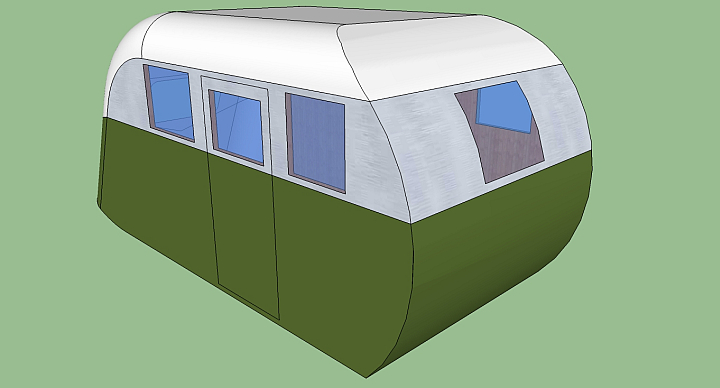

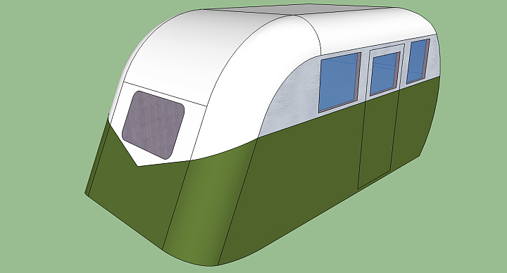

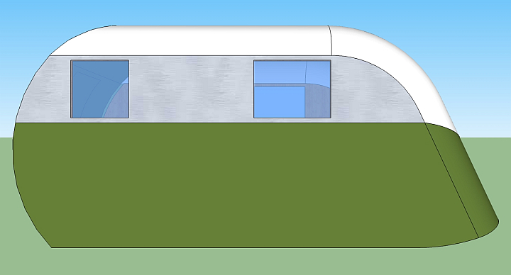

Here are the images of a TTT version of a breadloaf I drew to you thoughts, with a Westcraft back end and a American Homecrest Front. I think it looks pretty good, just a shorter loaf of bread...

Postby aggie79 » Sun May 08, 2011 6:33 pm
Peter,
Those renderings are stunning! Thank you for putting those together.
I had tried to sketch a profile of a breadloaf with the Westcraft "back end" morphed onto the Homecrest "front end" using graph paper and pencil. I'm not sure my drawing would have an earned a single star in a first-grade art class.
From my crude sketch, the profile looked okay, but I couldn't visualize how it looked with the curves. With your Sketch-up model, I can now see it!
Thank you very much.

I've been wrestling the door height issue too. My final design may end up not being garage-able for that reason (and trying to get a standing height shower inside.) The dormer is a good idea. I'm not sure if it was added later, but this Westcraft has a mini-dormer on the right door.
