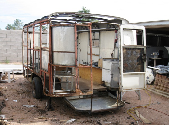

Eddie....that looks like a hinged drop floor on the rear that had a canvas type material around it. Is that the case, and how does the whole thing fold up? Got any pics of the top front with the ribs in place and no skin? Nice project! Doug
Yes I bought it from a guy in Edgewood, NM. It did have canvas on the hinged drop floor. It is a Covered Wagon design. I was told it is home made from the early 60's but I tend ti think it is from the mid 49's. here is my link
http://oldietrailer.shutterfly.com/
That will be an interesting rebuild! Can't wait to see progress on it. What material is the roof made of, and second, how do you think the curves are formed on top?

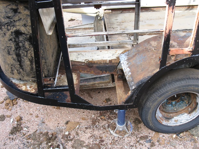

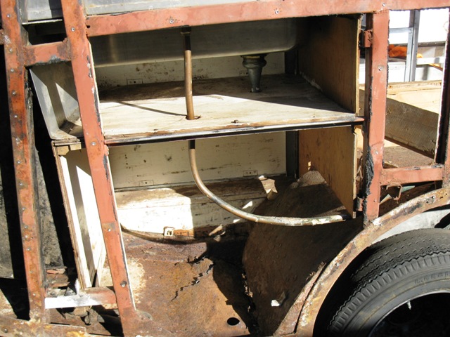

On a small piece of aluminum I found a date of March 14, 1945, I have it almost all the way torn apart and have found only rust under the sink that will have to be replaced. I will add some pictures tomorrow.
Here are some pictures of the rust and it cut out ready for replacement panel

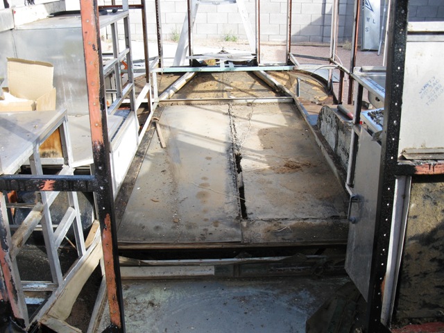

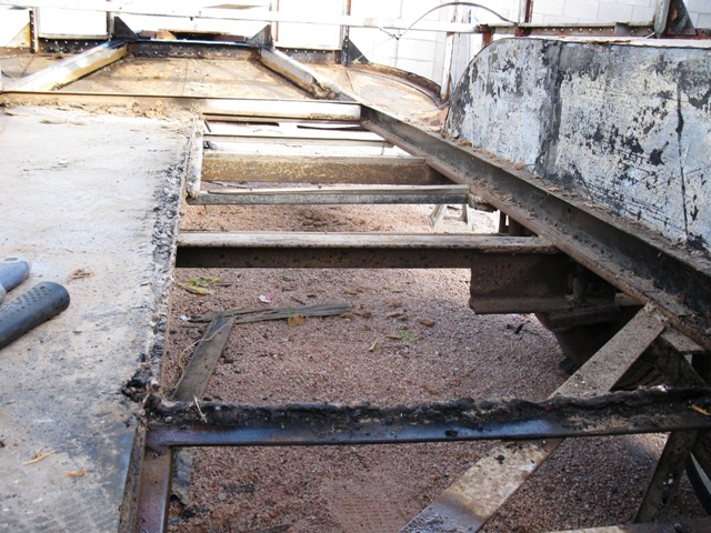

And this is interesting, under the 1/2 inch plywood I found what was once the original floor. It looks like someone took a torch and cut the metal down the middle. I think half the floor was part of the bed.
Here you can see the slag from the torch
