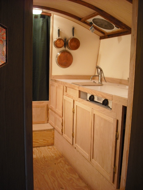

I would want a galley a little like this one
Steve

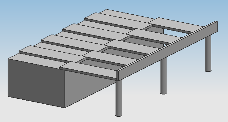

So the gaucho bed would go across the back of the trailer? Something like this?
Mike,
That is exactly what I had in mind. It would either be a pull-out with legs as you have shown or be a folding/sliding arrangement that is supported by side rails like in the Squidget. Of course, I'm not sure you could do a 78" free-span.

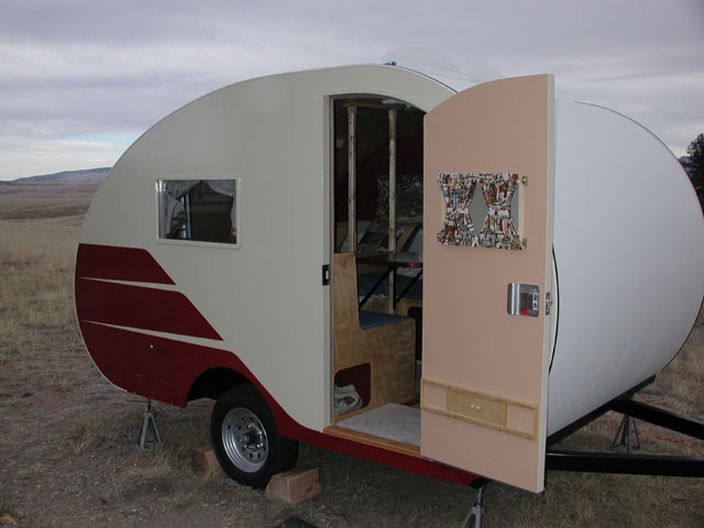

Is this what people think about when we say canned hams? Scottys and Shastas?

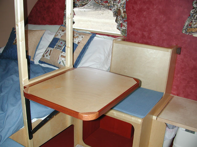

Well - what I've been thinking of is kinda like this Widget
with about this size dinette
but moved forward like this
but the porta potty size close to the Puffin or Generic ET
